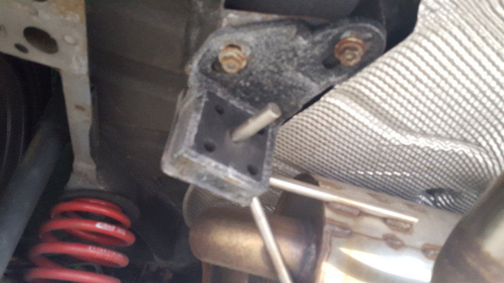

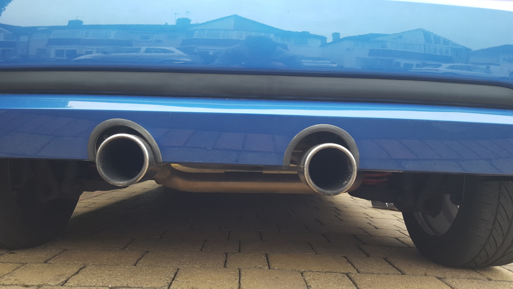

Does anyone have any handy hints for exhaust alignment? Mine rubs on the rear surrounds when it gets hots and it starting to melt them, plus it sounds horrendous.
Exhaust is a ktec/janspeed ultrasport and i have the prima mounts so there is no room for movement with them..
<a href="http://s1313.photobucket.com/user/s... Uploads/20150830_175111_zpsd7m1o7dg.jpg.html" target="_blank"><img src="http://i1313.photobucket.com/albums...obile Uploads/20150830_175111_zpsd7m1o7dg.jpg" border="0" alt=" photo 20150830_175111_zpsd7m1o7dg.jpg"/></a>

The two prima ones are fixed and there is no movement.
What other parts would you suggest i tighten/loosen?

I have moved the mounting brackets that are bolted to the boot floor.
If you but rope inside the bracket then pull in between the back bumper and tyre the hole exhaust will move.
You will need to do this on both sides for it to work.
They can also bee moved buy placing a piece of wood on them for protection then hitting with a hammer.
