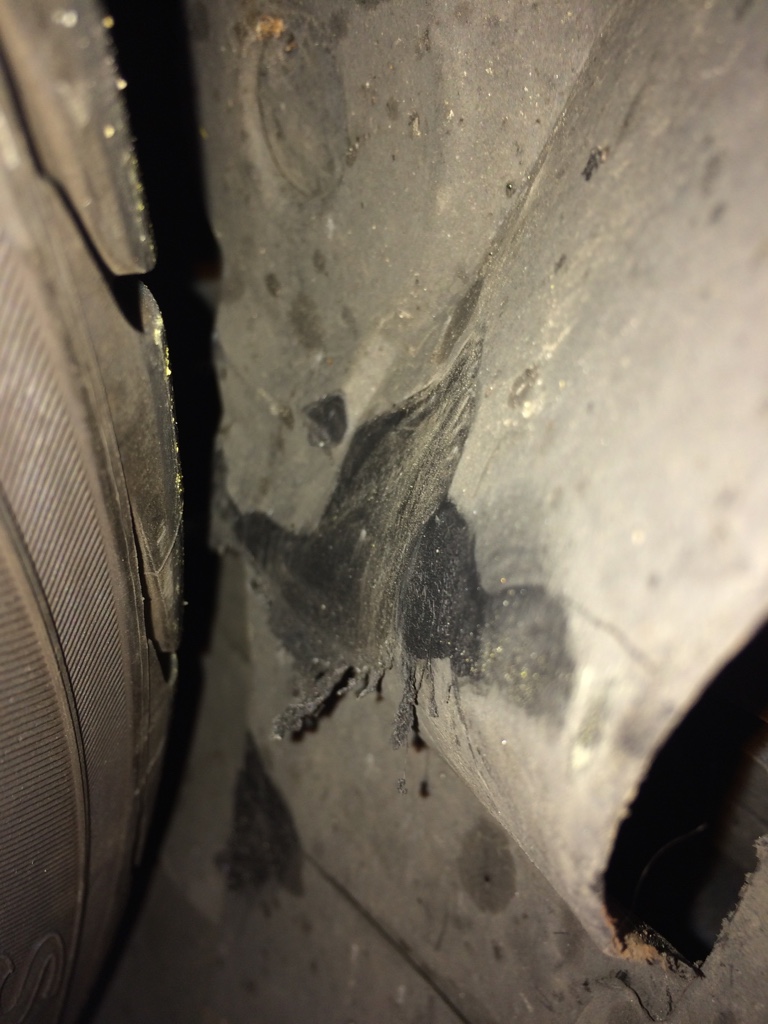

Plastic kind of rubbing? More than likely arch liners, check for rub marks.
sounds like it, its sitting a lot lower than it used to be, it only seems to be on full lock
Well found where it's been rubbing, anyway to stop this?
I'd try and avoid removing the liners completely, they do a useful job of stopping the loom get too much water in, the passenger side one specifically.
PS, clearance shoudlnt be greatly different on the two sides, does it seem to have a similar arch gap both sides?
