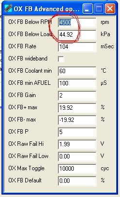

All I changed was the two circled values shown below to '0'. I have a note of the settings so changing them back is not a problem.

The circled figure is just an RPM parameter for lambda feedback.
If its running open-loop and its still having this fault, then you can rule out the lambda sensor and/or controler.
I'd check the coolant temp sensor next.
Or keep an eye on temp correction when its running, and see if this is yo-yo-ing.
Also keep an eye on the load value at idle and make sure this isnt jumping about.
Does the load bar move smoothly over the whole load axis when u slowly depress the throttle? (engine off, ign on, software connected obviously).
When I set both of those parameters to '0' (open loop) the problems go.
It has intermittently been dropping rich and stuttering but it has been gradually getting worse. Because the AFR gauge is reading OK I am assuming the probe is alright and there is potentially a wiring issue between the innovate control unit and the OMEX.
