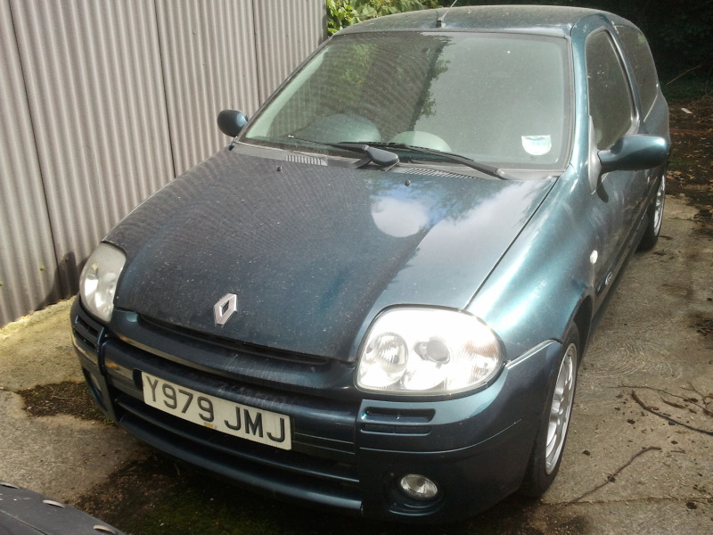

I'v got another one :eek:
Now the eagle eyed CS members may recognise it, and that is because I have owned it before lol, see below:

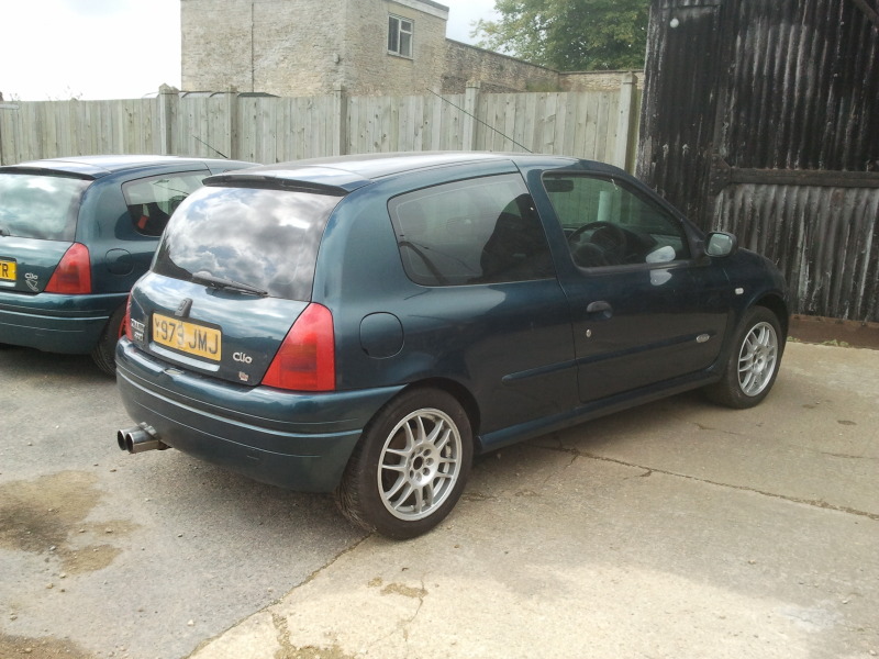

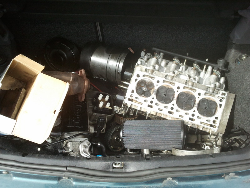

Some of you may have noticed the silly exhaust angle, that is because it has no exhaust manifold on it. And in turn that is because it has no head on it lol.

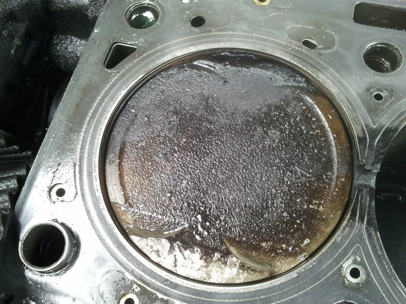

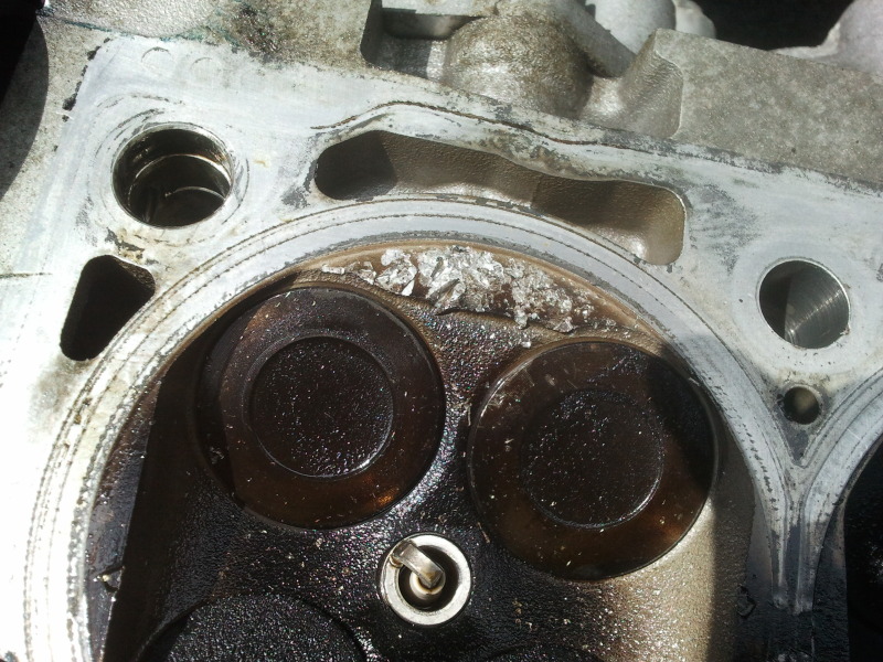

I purchased it from Riley off here (Who by the way is a bloody great bloke, and a pleasure to deal with, if anyone ever wants to purchase anything from him, you will have no problems at all, thanks again mate!) who originally thought it may have jumped a tooth and done some valve damage due to the loud tapping it was making, but as soon as I popped the bonnet I could see what I think has happened:

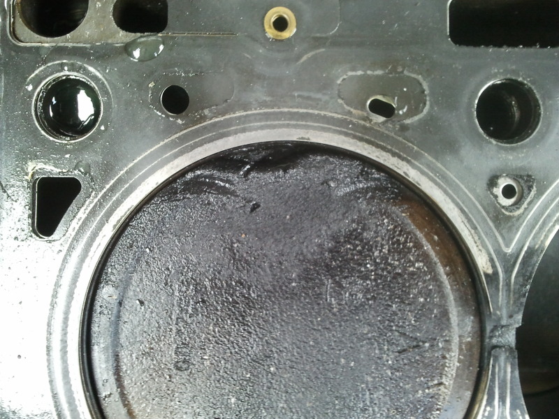

Looks like a chunk of piston has broken off, and from the marks on the head it looks to have been rattling around in the cylinder. Plus the head gasket is split, though im not sure if that was done when removing the head.

The only parts that are missing from when I sold it are the Schrick cams and KW's, the rest of the car is complete, and I sold it on 86k and it's only on 90k now.

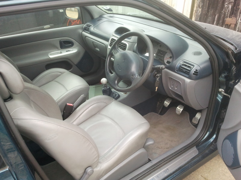

The rest of it is pretty much the same as when I sold it, the bodywork I would describe as ok - a little tatty in places, where as the interior (Including the steering wheel) is like new
And the pile of parts in the boot lol

The more I look at the pictures, the more I think the head gasket has gone - it looks to have some blow marks there, and I'm wondering if the poor map that was on it when I had it may have been the cause of the issues

head gaskets clearly gone, can see where its popped and burnt through in the pics, no way that occurred when head was removed, that's gone pop! that's what the loud tapping was as well, text book blow by into the other cylinder, sounds like a rattle.

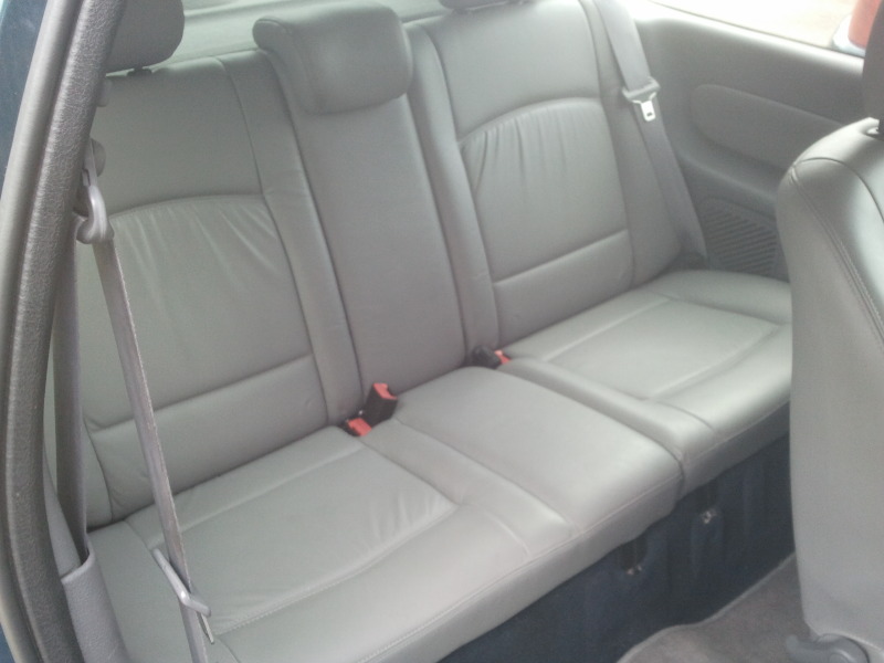

Those back seats look virginal. They need christening....
D.
I think they have probably been sat in a handfull of times lol
Yeah I literally opened the bonnet and took the picture, now Iv looked back at it, I can see it's gone. Odd though as F4R gaskets going are like one in a million, I knew it had a poor map on it when I had it, I think that was the killer.

What where they thinking when they made the interior?
Looks decent though!
Yeah it is a bit marmite, but it's probably the best condition one around! lol

As for head gasket going, didn't even notice that myself but I just took the head off and looked at valves to be honest. But dont forget the last owner that fitted the cams had the head off when he did that so could be why its gone. I.e the heads been off since it left the factory

That interior looks factory fresh!! Genuine no sags in the leather or anything, I've seen audi's with 3k on the clock and the seats look more worn than that!
  53 Clio's & counting
The interior is seriously the cleanest newest looking in any clio I have seen, the rear has barely been sat in, and the front seat only has a tiny tiny mark on it, door cards are clean, carpets like near new :)

Imho It's detted it's tits off (bad map most likely reason) that's done the pistons in and started the gasket on its way.
Gasket is a symptom not the cause.
But if the other pistons are mint its more likely an injector than the map.

il give them a clean off and have a good look mate, I used to det under load under 3k anyway, the map was not great
true mate, I have not checked properly, I'm off over my lockup on Friday afternoon, so will know then :)
May be just a brilliant bit of casting by Renault on that piston again lol
  182/RS2/ Turbo/Mk1
Its possible I guess, piston breaks away due to casting imperfection (which they certainly like a bit of) and then as a result extra oil enters the combustion chamber as the rings dont seal properly without the piston there, this lowers octane rating which then introduces det.
Quite hard to tell TBH unless you start doing things like flowtesting the injectors.
CLEARLY its had an issue with det, but as to what introduced it, thats harder to say.
I can only assume it may have been the map, only because of how much it det'd when I had it, but still it can't be re-used as it is so it will be coming out anyway lol
