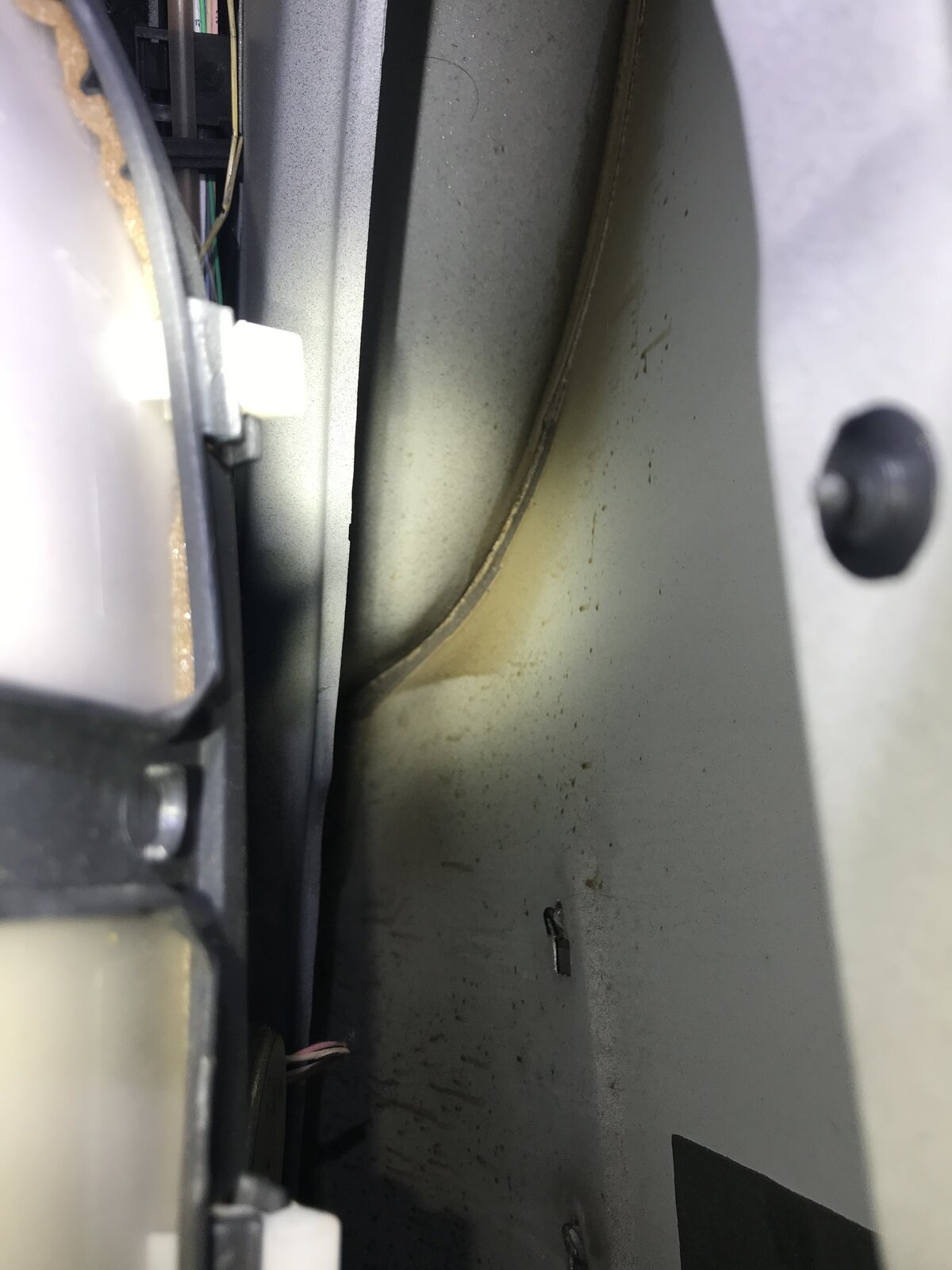

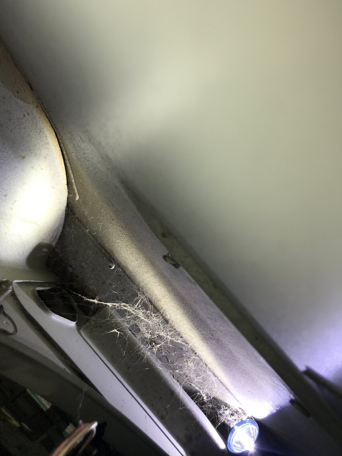

I had a look at my car today (53 plate black 172 for rust as I keep reading “it’ll be rusty on the inside”
Now bare in mind my car hardly ever gets cleaned BUT the key for me with these is my car has its original factory paintwork (except the front bumper has been touched in years ago)
I see a lot of these rusty now but suspect it’s from previous damage repairs or were there factory changes.
I know people say it’s a myth they don’t rust but how many people who know their bodywork is original and not prev repaired (remember galvanising is only a top layer of protection so once sanded.. rust away) have had their cars rust?
My mate has the exact same MY in black too and his one original arch inside and out is perfect yet the O/S he bumped it and it’s rusted.
BTW my car has done 130k and hardly ever gets washed. I was expecting to see some sort of rust free for all behind the covers but... just spider webs.

jameswrx
So I picked the wrong side to check? My thinking was N/S being in more road debris and water should be the worse.
So it could still be rotten as a pear! My filler cap area does look like you could grow plants in it so will look.
I actually went out to throw a load of bilthamber down inside thinking it’d be a mess in there. Perhaps my friendly spiders drink all the moisture for me ha!

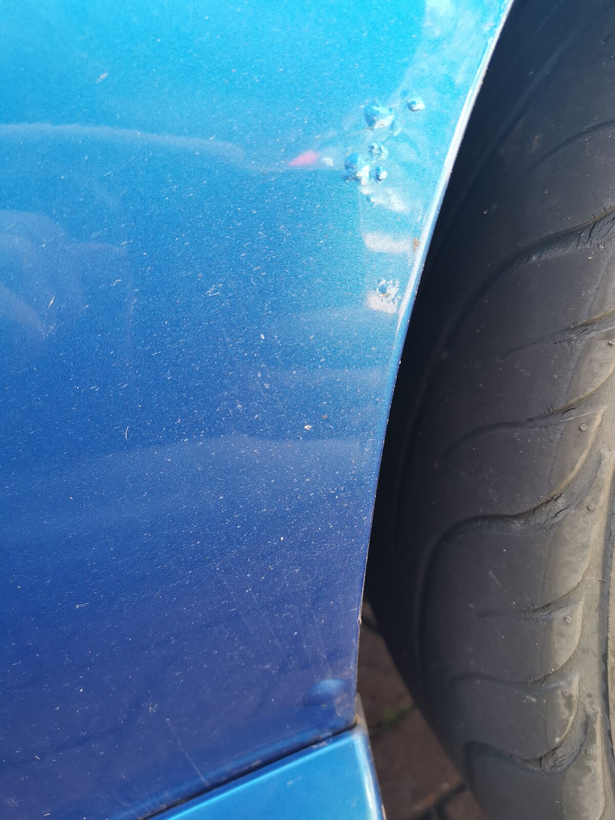

I have two small areas of bubbling on the rear quarter panel but nothing serious, I'm startig to suspect there has maybe been a repair done in the past, the other side is spotless. Hard to be fussed about paint though when you have binned it in the gravel before :rolleyes:
If its bubbling on the lower rear quarter, your sills will be fucked by now.
Have a look behind your doorcards and take the skirts off, I wish you the best of luck 😂
Is it the drivers side? Run your hand along the underside of your arches. Bet you'll find one side is rolled and the other isnt

Na its passenger side, both arches feel the same I think.

There's no sign of it rusting on the inside in the same place as the outside. Tiny bit visible at the bottom corner on the inside though...
I'll take the skirts off when I have nothing else left to worry about :LOL:

Surprising that, you're lucky 😂
Must be a repair that as sills arent bad.
I'd still look at treating and protecting them whilst there's something left to protect haha.
Yeah I'm thinking repair. I think they used titanium paint instead of iceberg too, I just never really noticed because of how different iceberg looks in different light.
And yea I will defo be treating whatever I can when I get a chance to look at it properly (y)

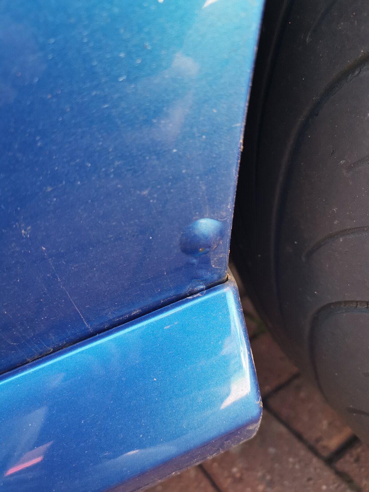

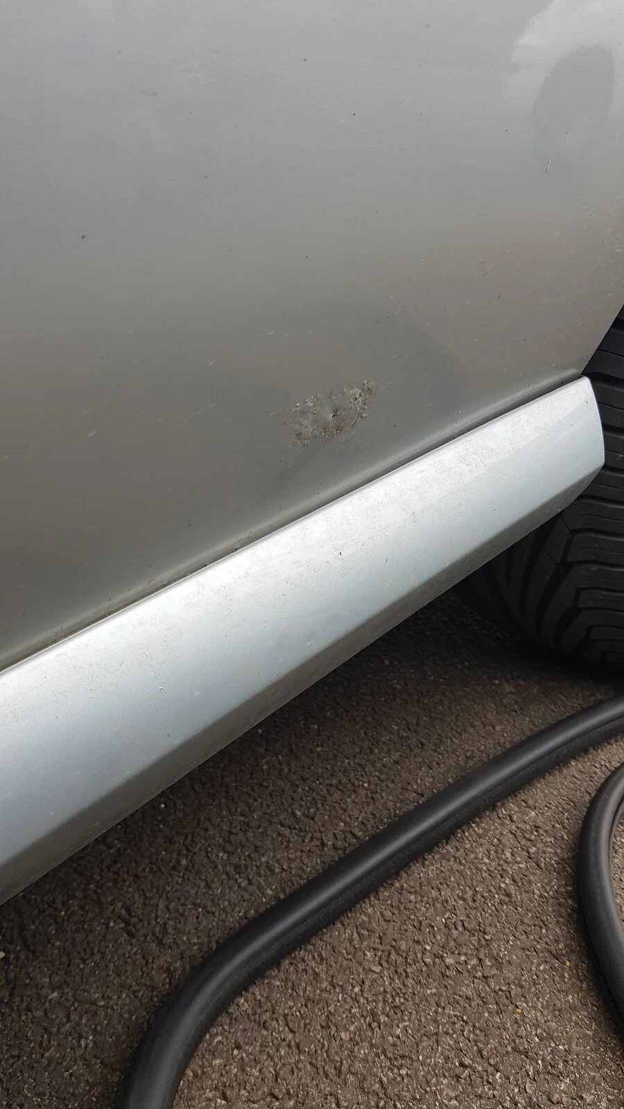

I've been keeping an eye on some light bubbling on the rear N/S quarter for a few months now.
Thought I'd check it today whilst out on the drive and there's a big bubble further down towards the skirt.
I dread to think what the insides look like.
Is this a simple repair for a spray shop to sort or will it cost big money?

Thanks dan 👍 I had similar on mine when I bought the car. I had two options to treat rust and paint with the certain chance of it returning or have the arches cut and replaced. The inners were totally gone glad I didn’t go for the easy fix. Body shop did an awesome job mate and well worth it if ur keeping the car long term

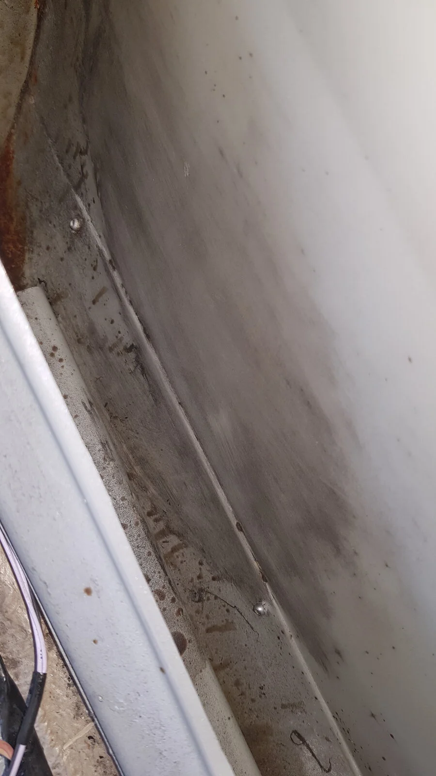

With the inner sills, what’s the cause? are they rotting from the inside out or are the skirts holding crap causing the sills to rust?
View attachment 1467844View attachment 1467845
Mine are starting to look similar, I've looked inside the rear quarters and they're absolutely sound in there.
Plan on getting it sorted at some point, im in no huge rush now though as if they need cutting out anyway makes no difference really.
