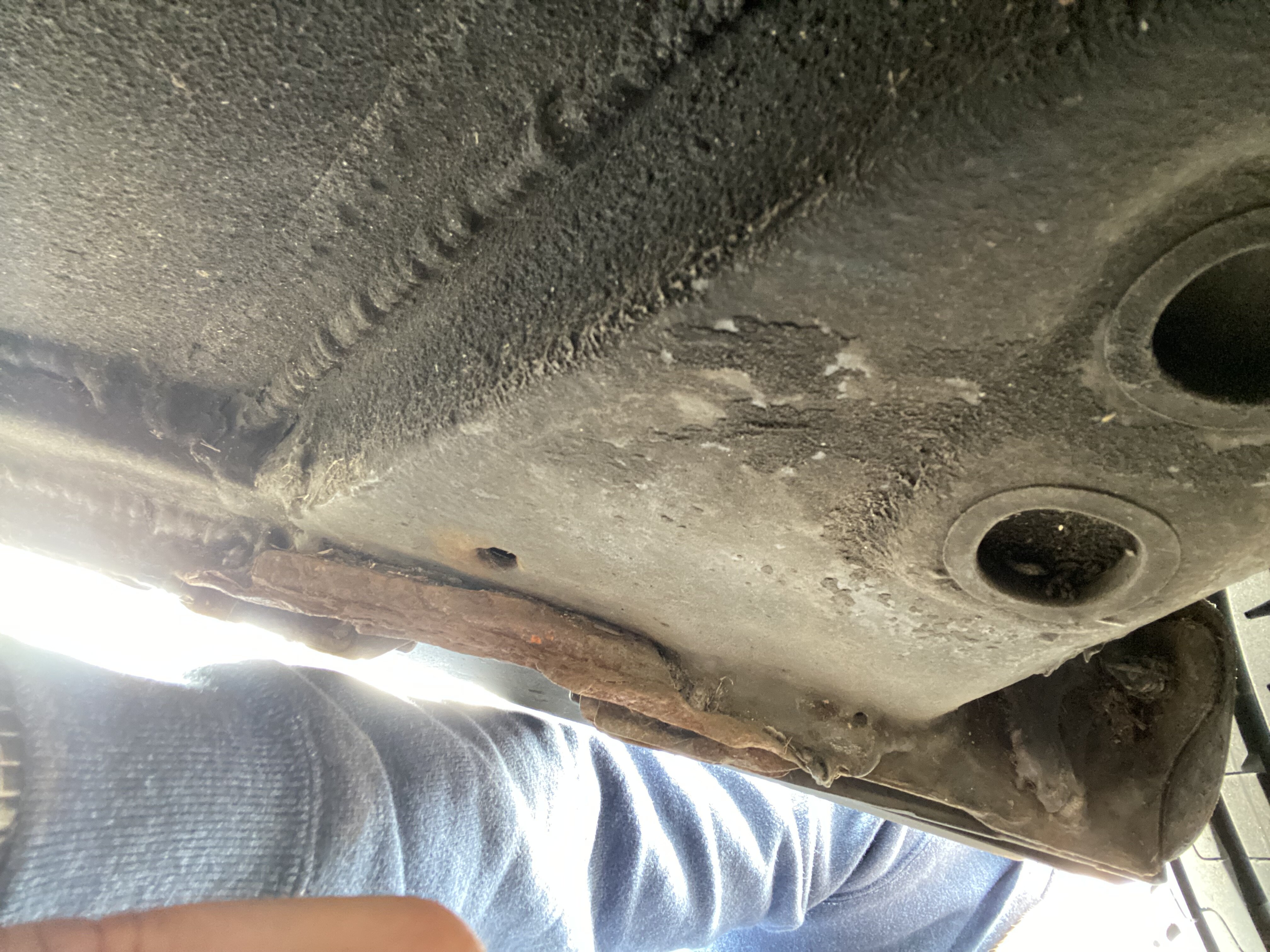

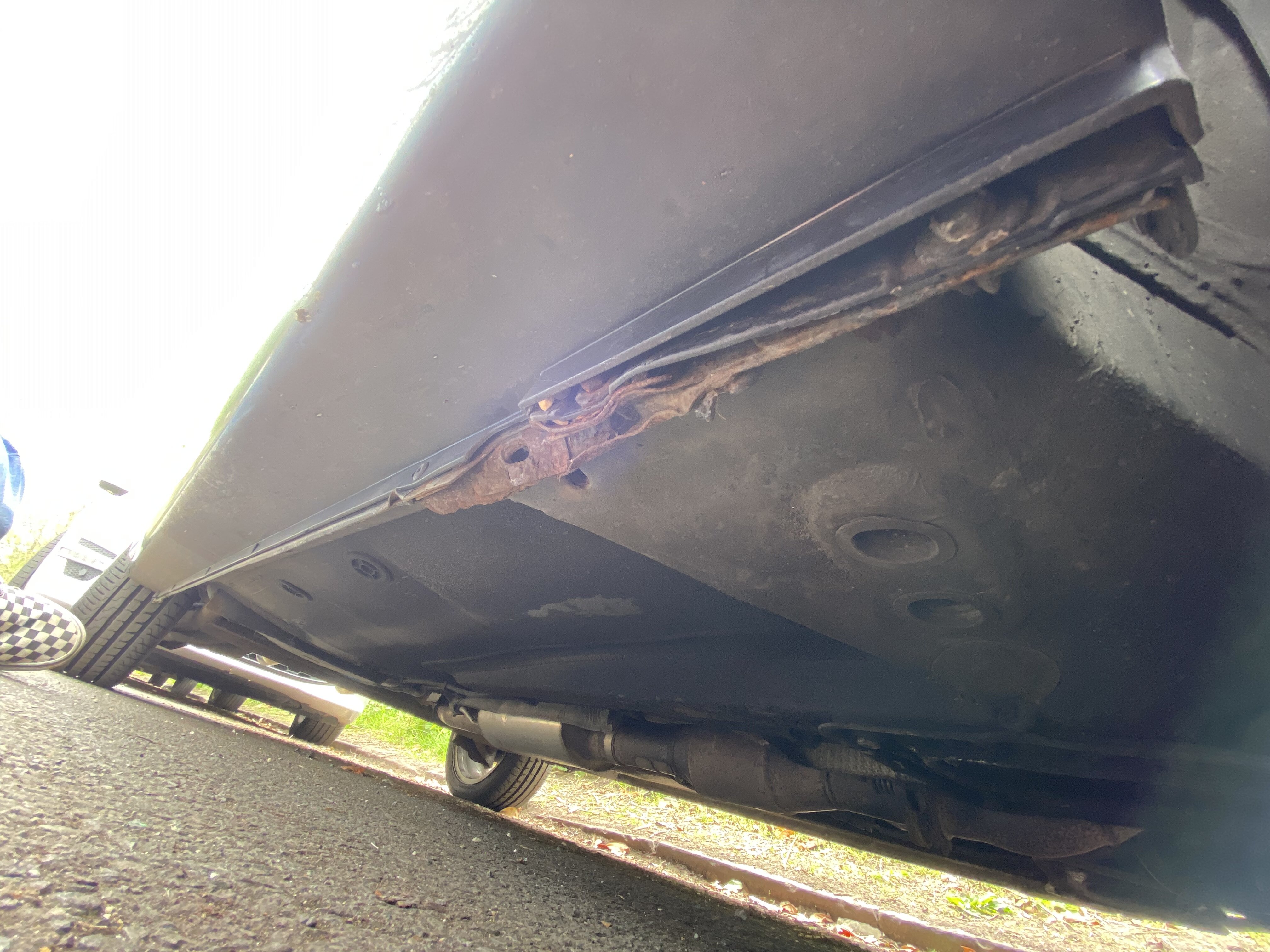

I was hosing down the underside of my 182 to get the last of the winter gunk off and I noticed for the first time that my front jacking point is a bit mangled and rusty.

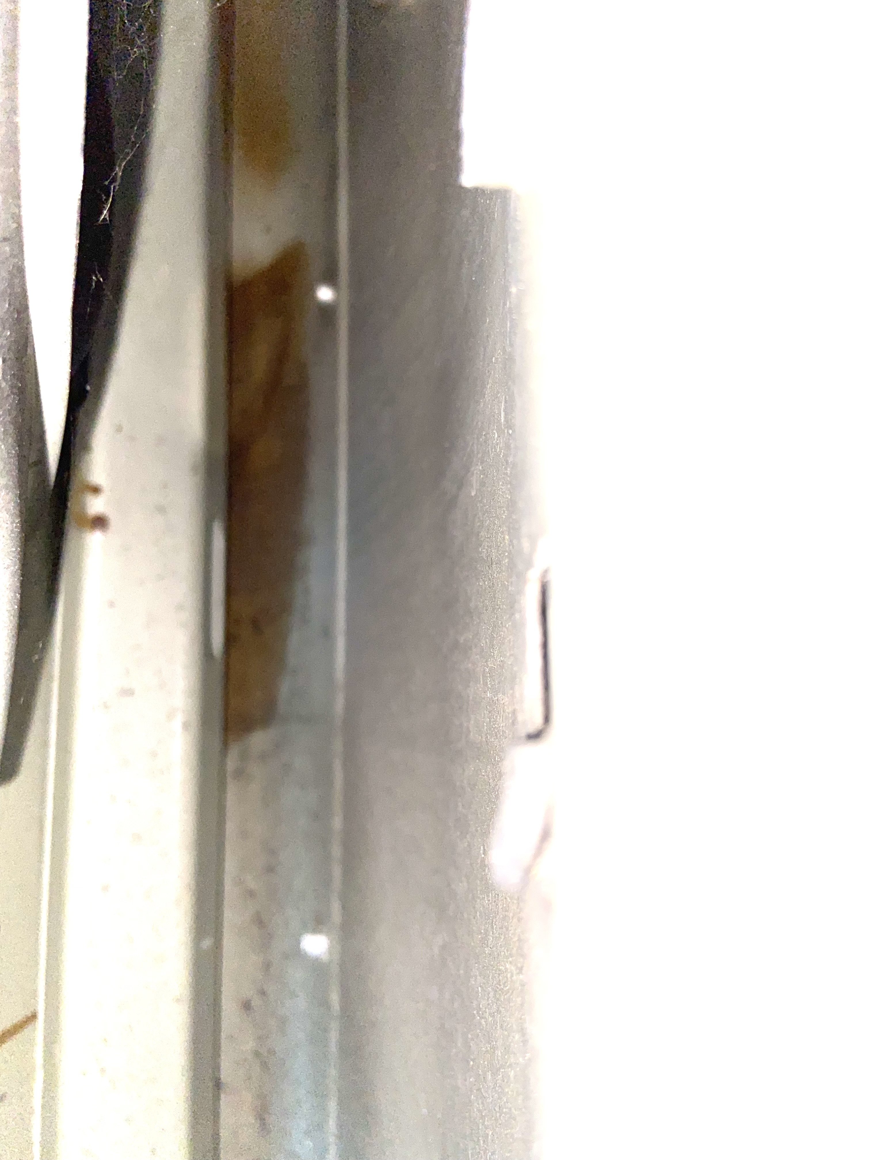

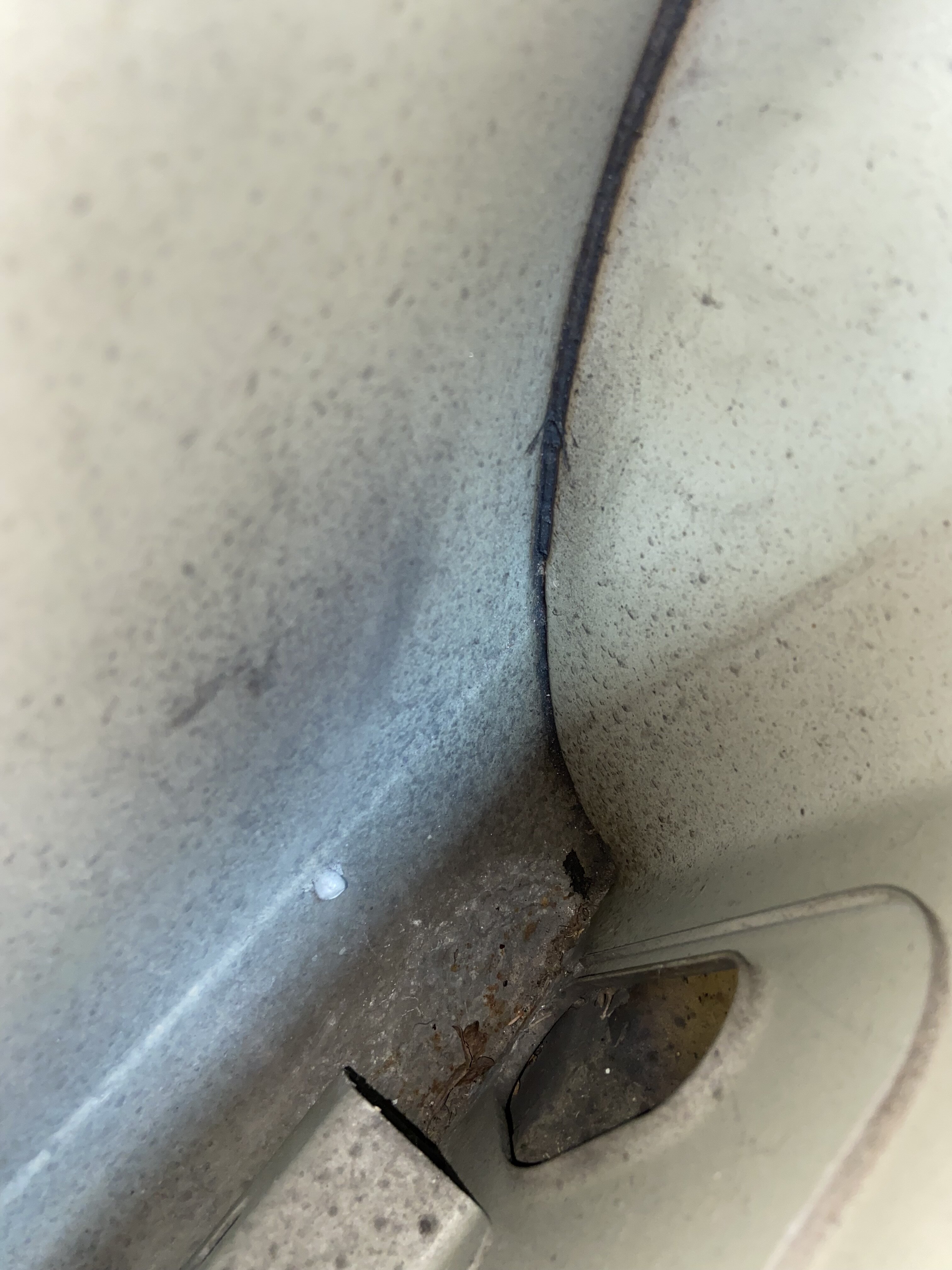

Of course, as soon as I saw this I got rust paranoia and started investigating elsewhere. Bugger. I spot a 3-4 tiny bubbles on the lower rear arch. I realise from scouting around the forums that this is pretty common so I whip the rear door card off to have a better look. Lo and behold, rust at the bottom.
I've seen some people have had success using Kurust and Bilt Hamber products to stop the rust in its tracks, but as my rust has penetrated through the metal to bubble the paint, is it too late for that?

Defo fixable. You should see the state of the Jap cars! Ep3 rot from the inside out in the arches/door pockets too, mine were much worse than that. Can't see it being an MOT fail but now you've spotted it, be daft not to stop it in it's tracks.
Wire wheel clean it up, kurust and some zinc primer - if it doesn't create any holes anyway. Clean up behind the petrol filler neck where it collects all the crap first.

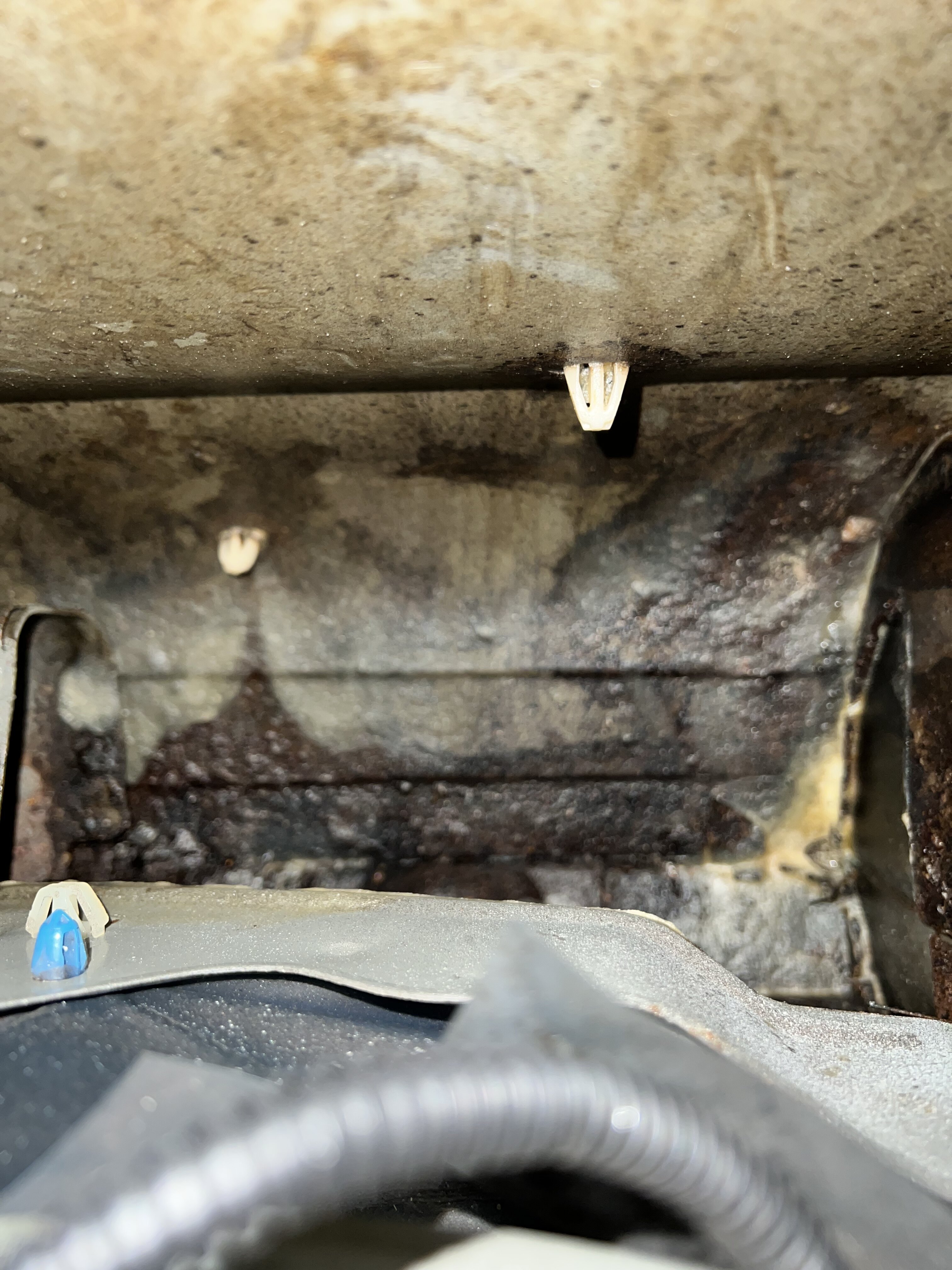

As my esteemed colleague above has said, thats in no way concerning, here is the inside door card of a 74,000 mile old Type R…
