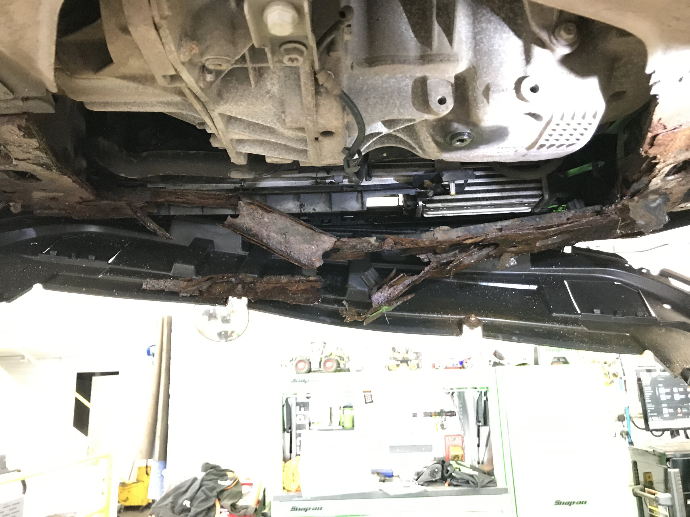

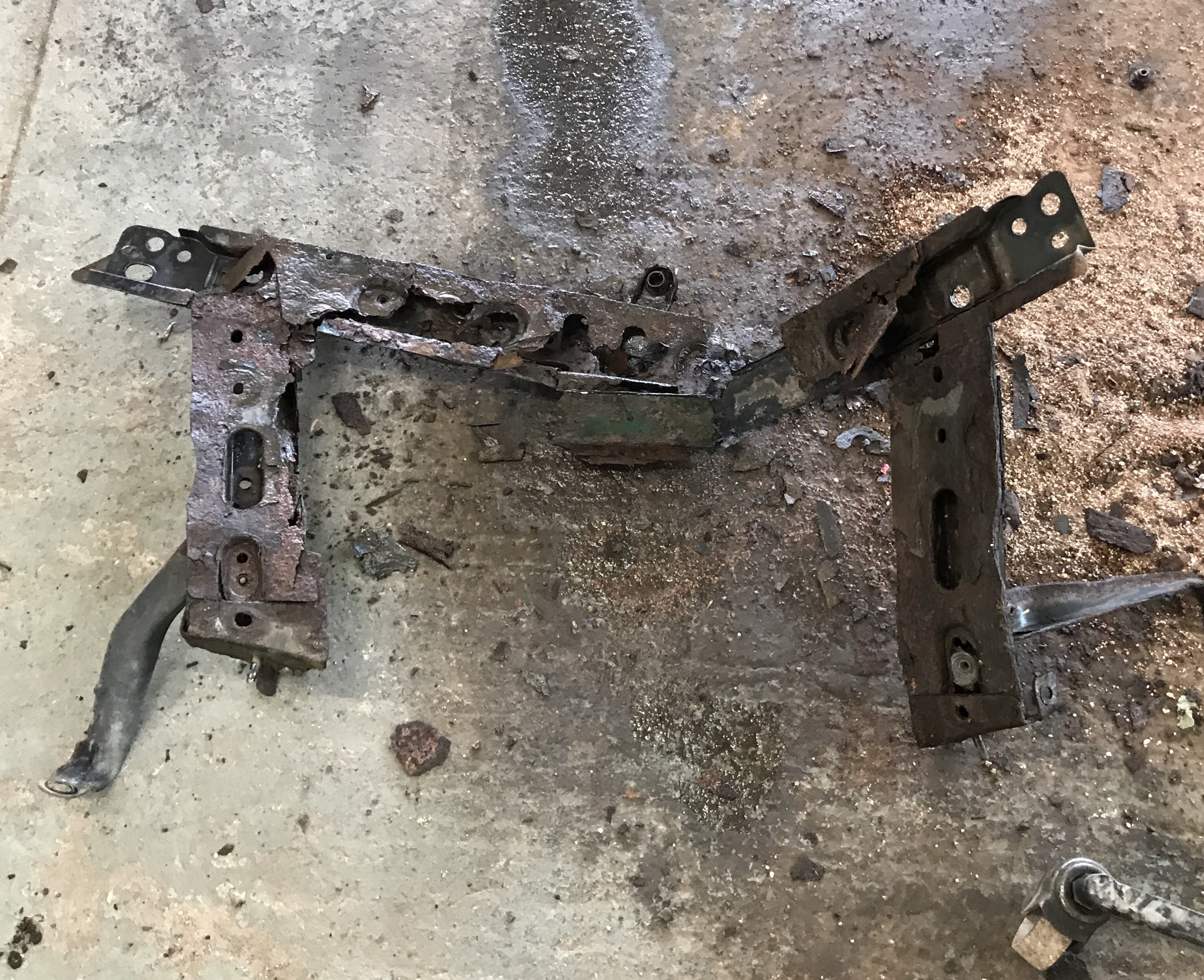

A 2011 clio I put a new rad support sub frame on at work this morning. Watch out for that one people 😣
Most of its in my eyes still haha, even the safety squint didn’t help. Was lovely this morning doing it, rain soaked so was just raining rust and crap all over me.
Customer wanted to view as I was doing it as I think he was curious how rusty it could possibly be for an 11 plate car.
I’ve been quite surprised seeing some of the cars in the garage recently with rust. Some of the VAG stuff like similar age polo’s to this, rotten as a pear through the sills. These cars seem so new to me having really old bangers so it always shocks me.
Renault dont even stock the correct replacement part for the 200 either, the bracket is in the wrong place on the radiator supports.
Need cutting and re-welding, at which point you may aswell get one of the aluminium aftermarket variants someone makes on the fb groups.
