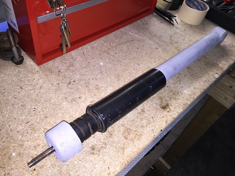

I bought two rear dampers from Renault Parts Direct (link below). They don't come with the top bump stops (as shown in the photo on the link) so i thought it would be easy enough to re-use my existing ones. However, i cant for the life of me work out how i remove the lower bump stop from the existing shaft? The end of the threadded damper shaft has two flats on it but the bump stop seems to be welded on or something?

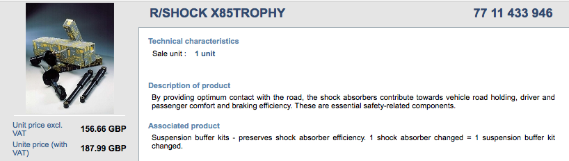

The RRP for the genuine dampers from a renault dealership are in the pictures below. -

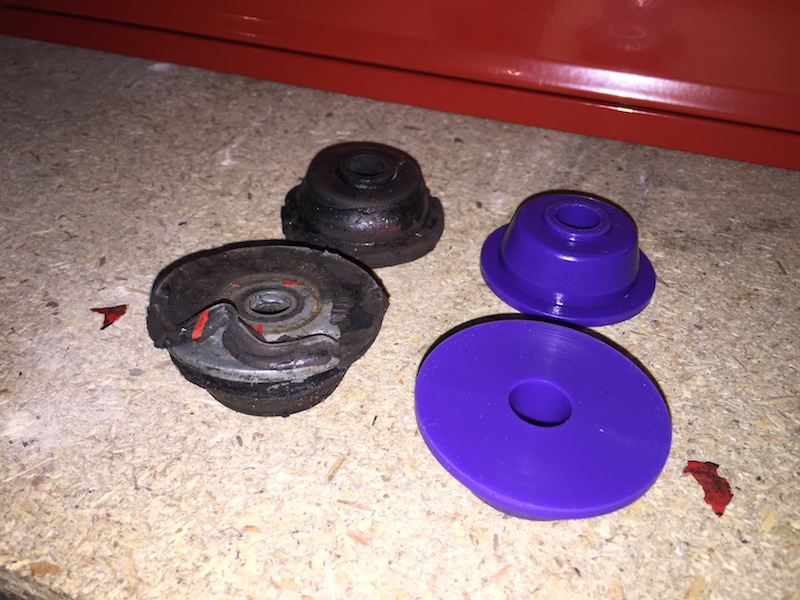

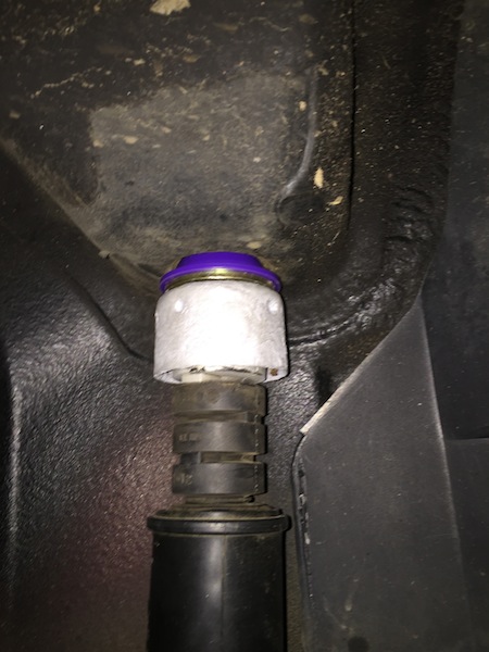

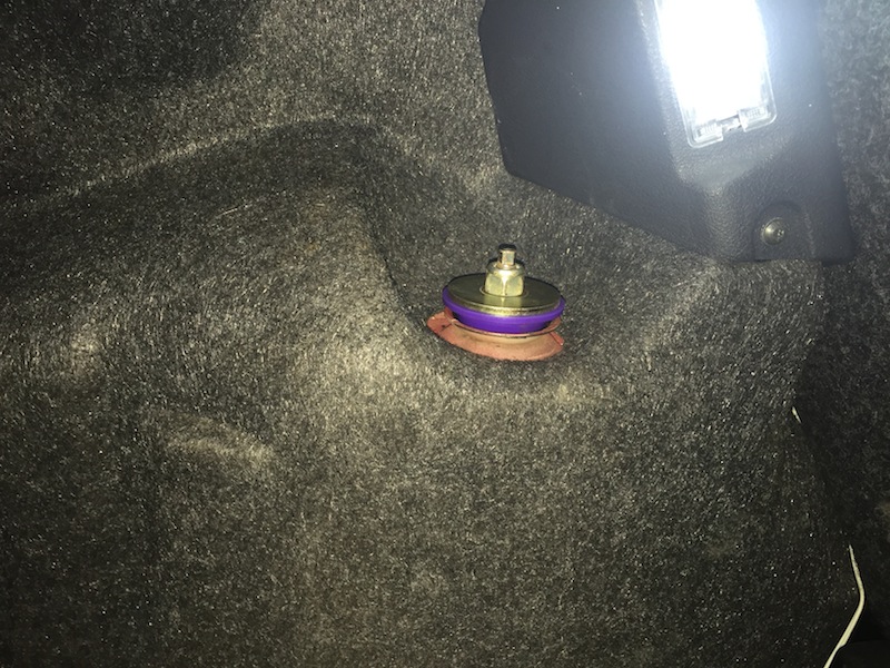

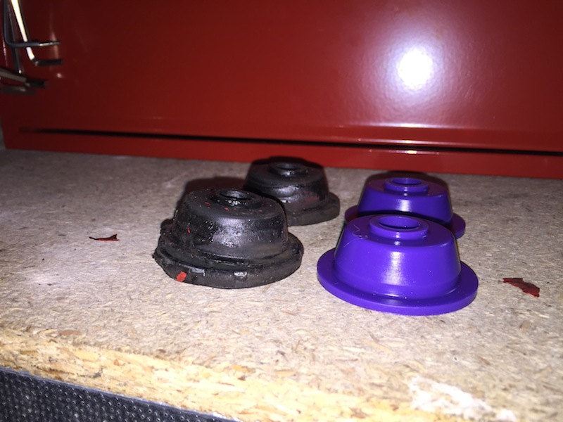

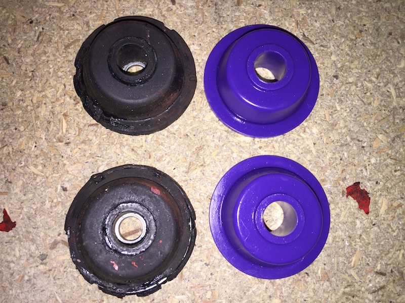

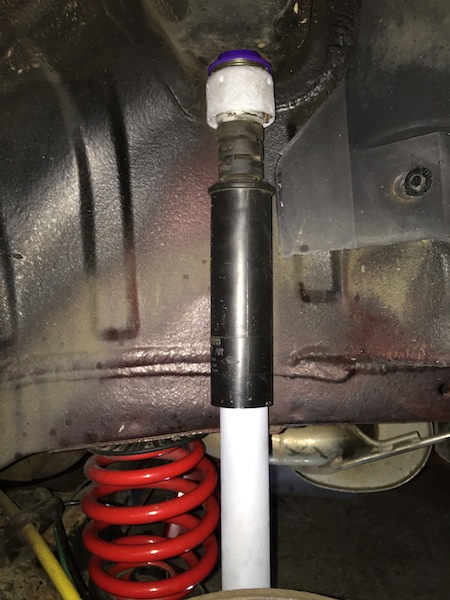

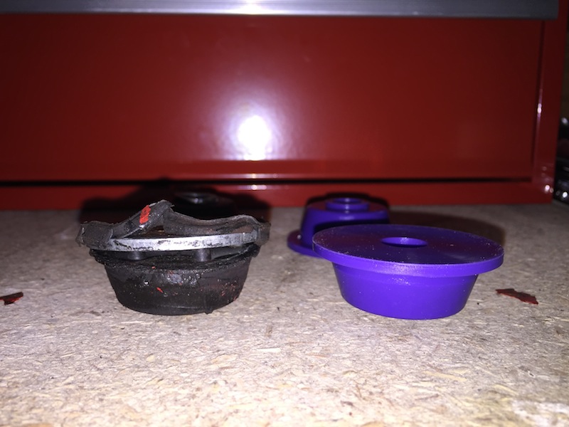

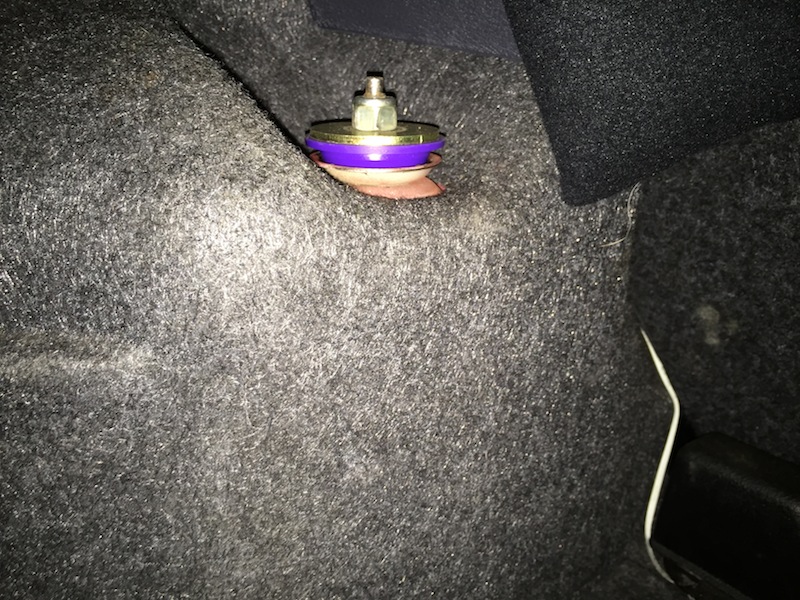

Some of these pictures might help you, as i change the bushes as they where all torn and burst -
  172
Any tips? Should i just not be re-using them and buy some more, if so, where from?
Nope just pull harder.
10 years of corrosion and speedbumps/potholes will have absolutely rammed them on, but no they're not welded on or anything.
As for reusing, just inspect them for large cracks or tears particularly on the top and bottom surface (shine a torch up the dust cover).
