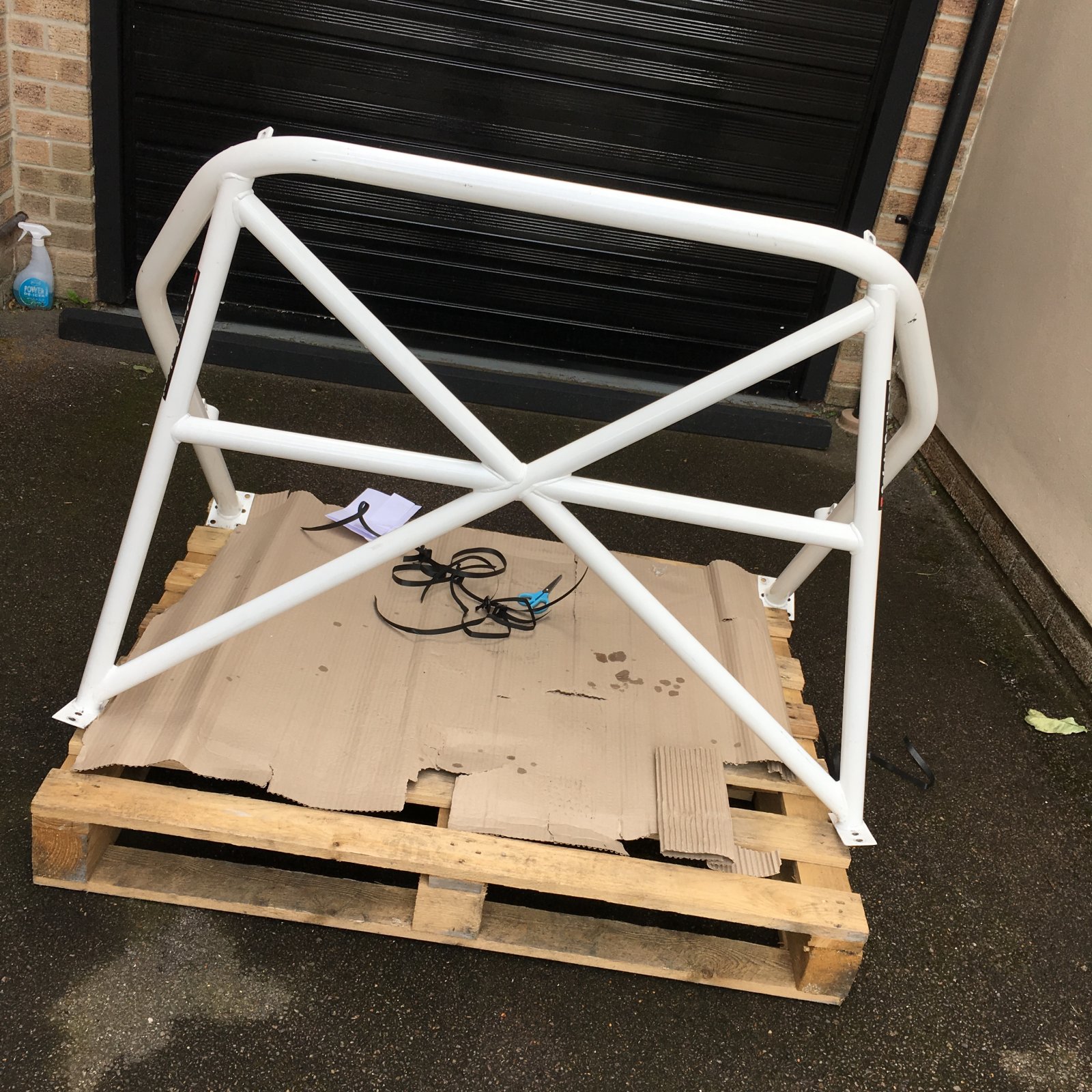

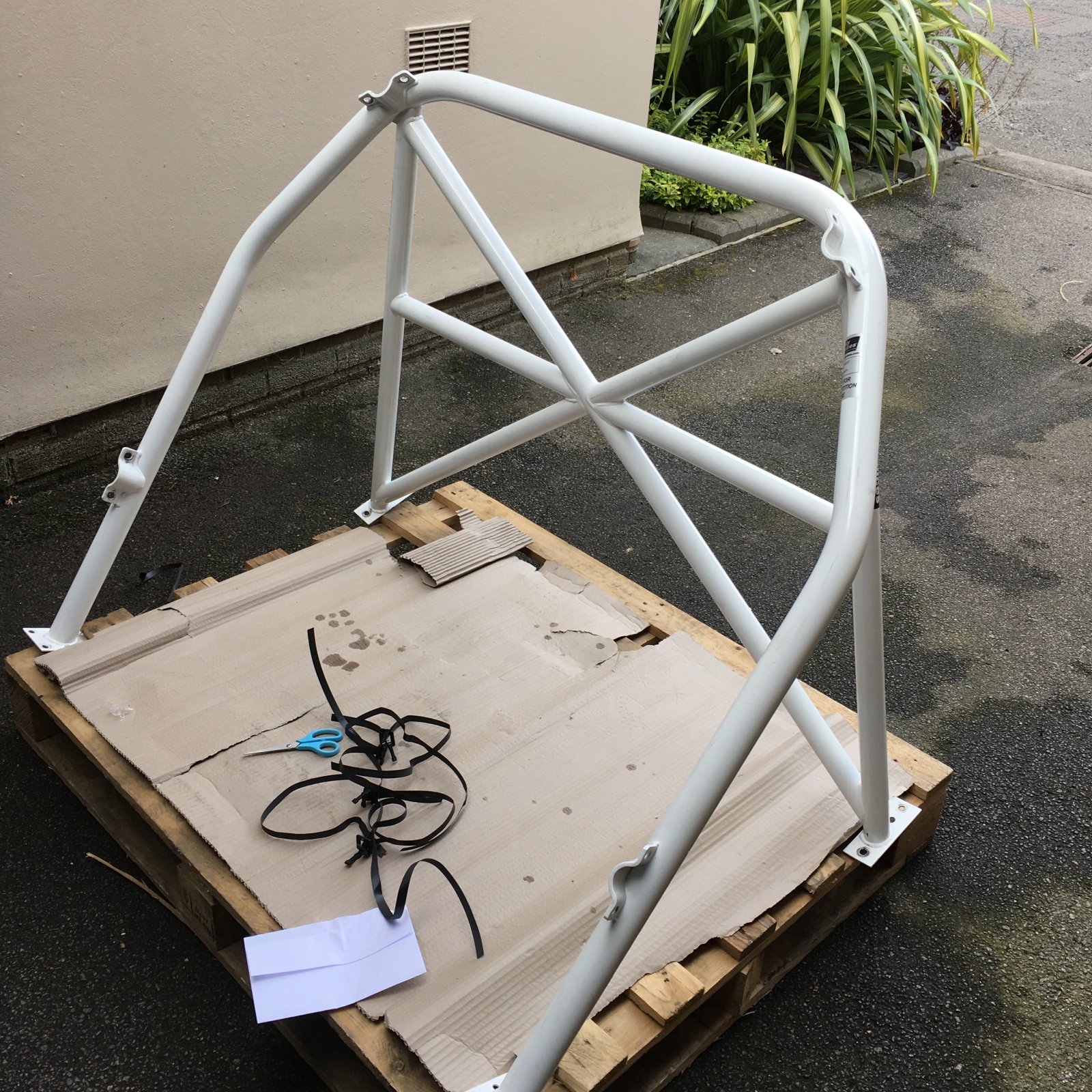

I've recently purchased a rear Safety Devices cage for my Clio 182 however I'm after a little help regarding fitting.
Below is a picture of the cage and fitting plates however I'm after a little help/guidance on fitting:
Cage:
Fitting plates:

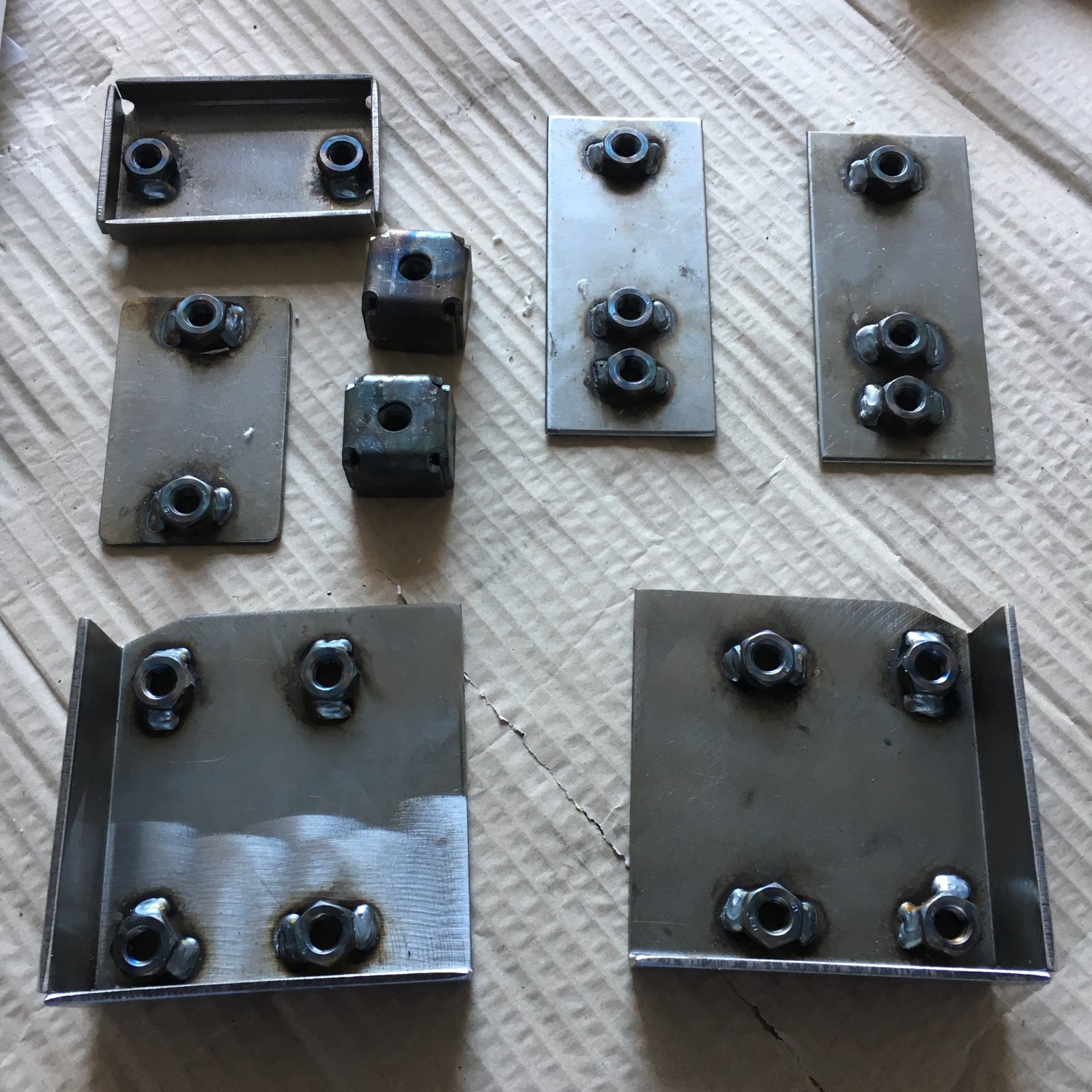

Firstly I wanted to ensure I was holding all the bracket/plates required? As this was second hand from Safety Devices & secondly I'm at a slight loss so to weather or not I'm require to weld the plates to the floor?
Assuming I do not need to weld plates, the two plates in the top right of the final pic cover the wheel arch mounts but what would I use on the front mounts of the rear cage? I can't imagine you fit the bottom two mounts with the lip on? Although I may be wrong?
Any help would be great.
Tom

Plates are welded to the floor iirc mate
Those bottom two plates with the lip weld in the other way up on the rear foot wells up against the bench seat
I did think that was the case however there are very limited instructions provided so hard to work out for a idiot like me! I didn't know if welding could be avoided? Assuming welding is required does Steve (I think that was his name!) weld on cars?!
If so I may be over again one day!
  Clio 172 Merc ML55
Unfortunately welding will be required I'm afraid, the rear arch stays are bolt through but as mentioned above the feet are welded to the footwells. The other brackets in the top left of the pic aren't required (these are for extra supports that you're cage doesn't have)
Perfect.
Thanks for the confirmation. Just to find a welder now!

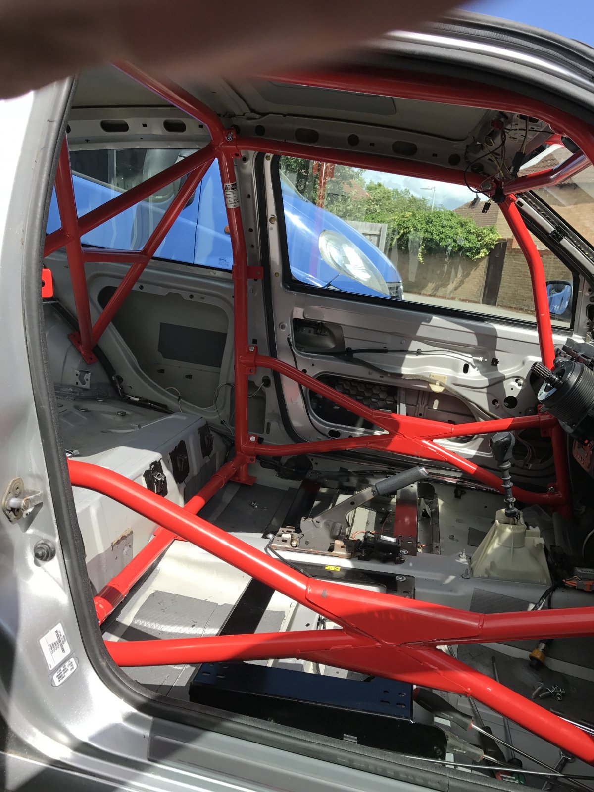

Hey, where abouts in Essex are you? Welcome to have a poke around my 182. I have the same cage fitted and plates welded.
I'll take some pics in a little bit and upload here to give you an idea. I'm in Benfleet if you wanted to take a look.
Cheers @RyG I may take you up on that. I have a welder lined up but it'll be good to look at yours before we battle with mine! I go on holiday on Thursday but will drop you a PM when I get back if thats ok.
