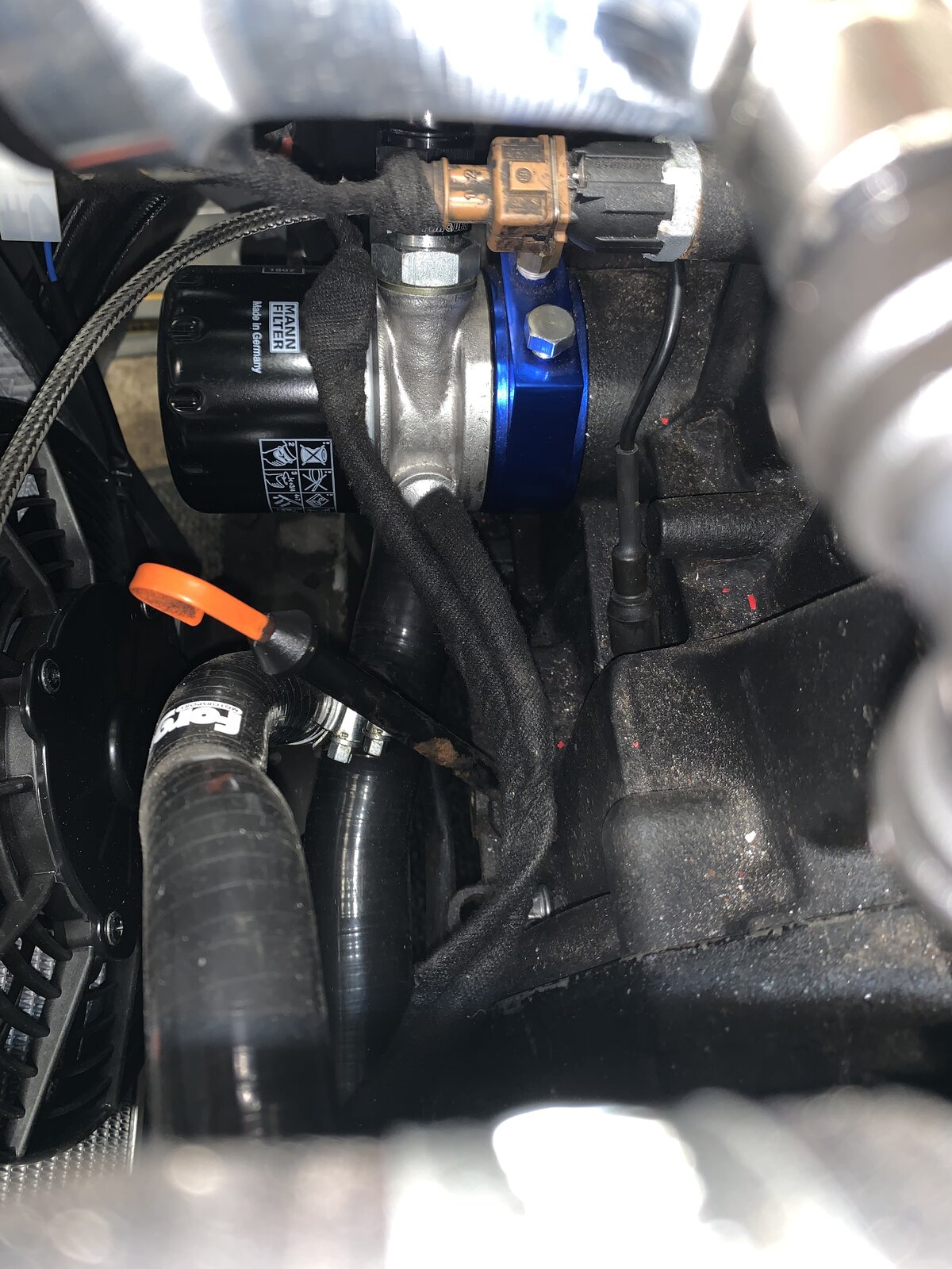

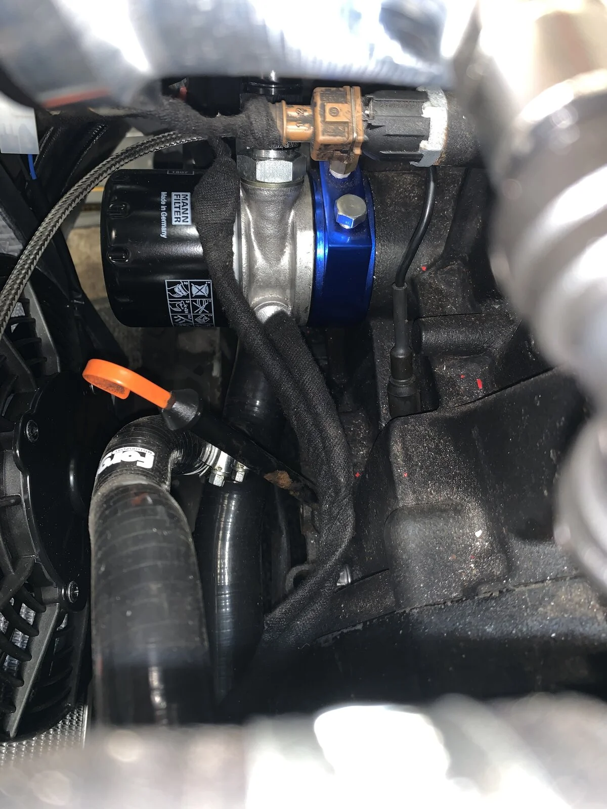

I run two sandwich plates. A mocal stat one and a torques plate for the sensor take off.
There’s no real risk other than a leak. I’d much rather have the 2 stacked then run one with out a leak and I’d only run a mocal stat plate.
I’ve personally never had a issue and I really work the engine hard, when it was running lol
