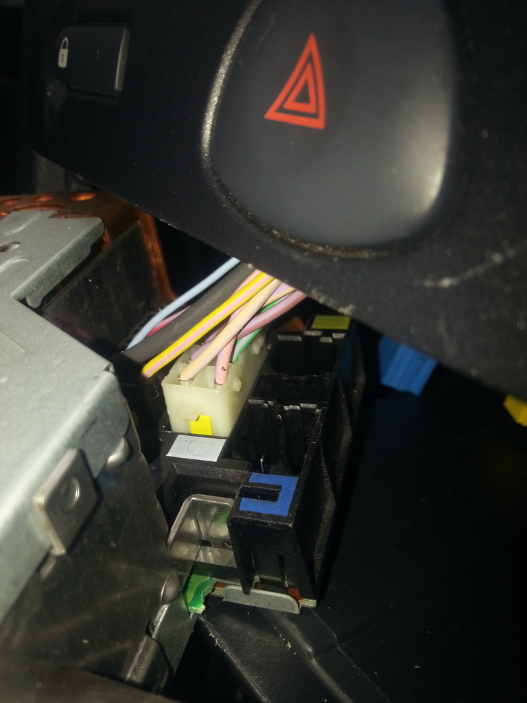

Had the radio out today, and im guessing I can't use a connects 2? All of the block was taken.
There was the blue connector from the CD changer, and then a yellow i presume that went to the satnav? I could always do without the cd changer as I dont use cd's.

Right, I've been looking at getting a connects 2, but have now seen most of the adverts state "this wont work with the 6CD Changer". I presume this means that my Cabasse auditorium tronic will not work with a connects 2 kit? Can anyone confirm this? Not much point my buying something and it not working!
If I'm right, the kit plugs into the cd changer slot meaning you'd have to loose the CD changer in order to have the connects2 kit installed. The yellow plug is for the display in your case the Satnav screen. So in theory yes it will work but you'll have to unplug the cd changer in order to get it to do so as the connects2 "pretends" to be a cd changer in order to allow the aux input.
