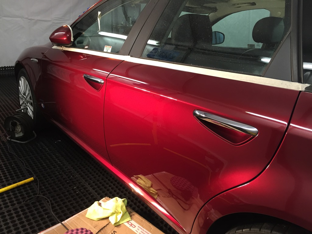

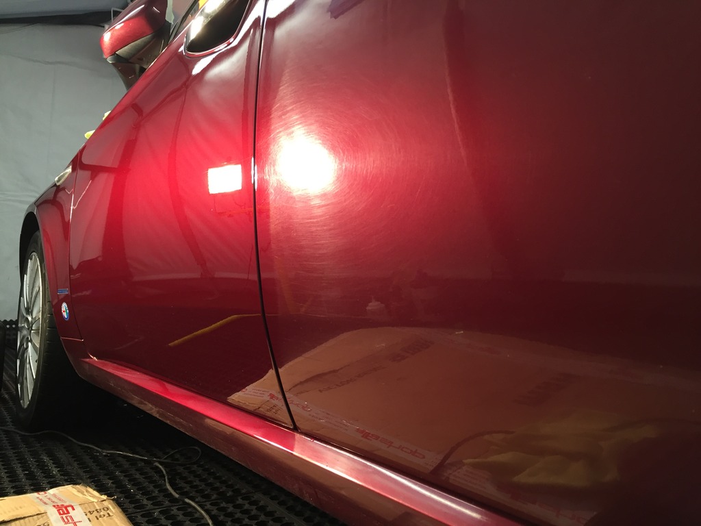

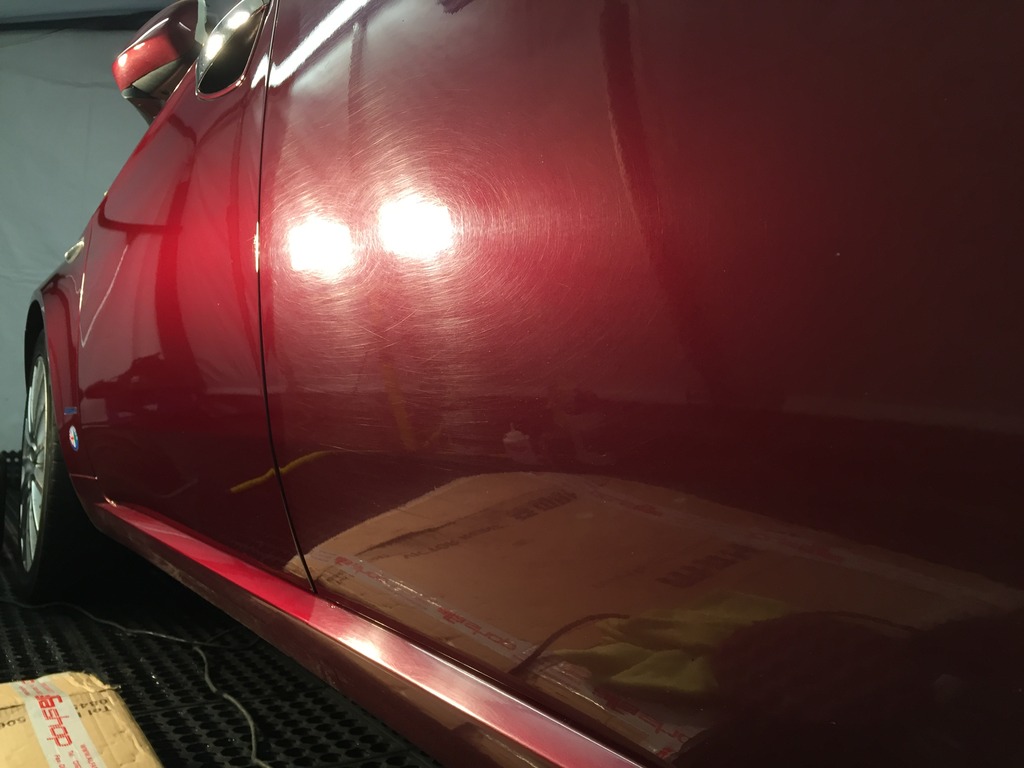

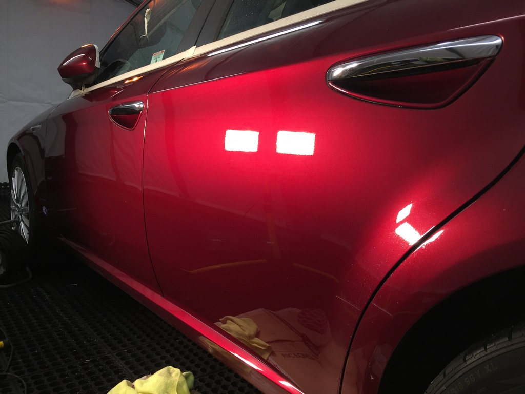

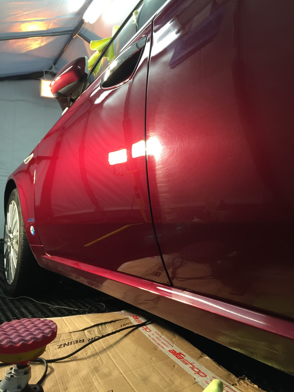

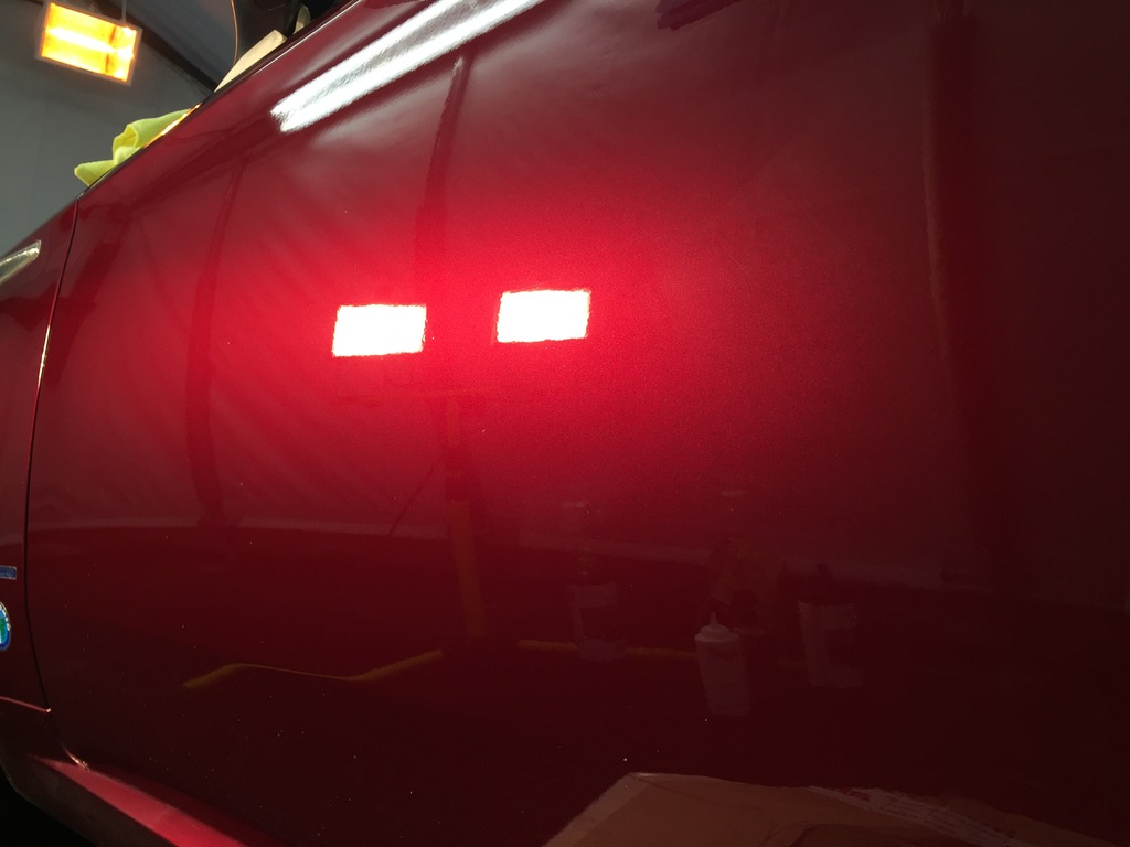

This colour is severely hindered due to the dull swirled paintwork, that's where I come in! Amazing colour in the light.
Megs 101 on an orange Hex logic pad finished up with 3M ultrafine on an Elite red finishing pad. :)
VIICarCare
  255, 230, 172, R26
cheers! It took around 3 hours to correct the bonnet, wing & the two doors. The paint is medium I'd say, took a few hits so not at all too difficult.
