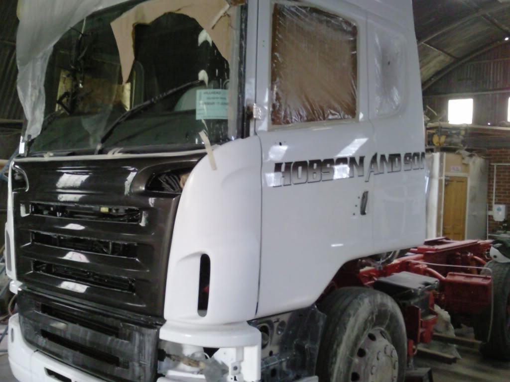

it started out as a scania v8 p340( think iv got the model right) then after a trailer got reversed into the back of it its had a full new front end fitted from the R series which required a fair bit of fabrications.
here are some pics anyway.

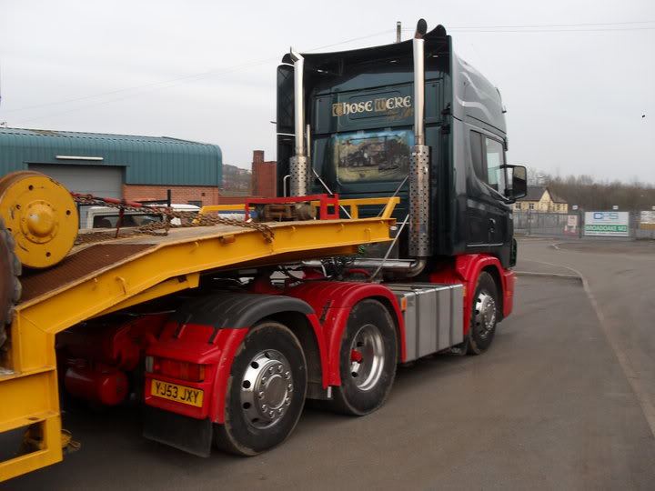

this wasnt the actual truck but started of in the same colours

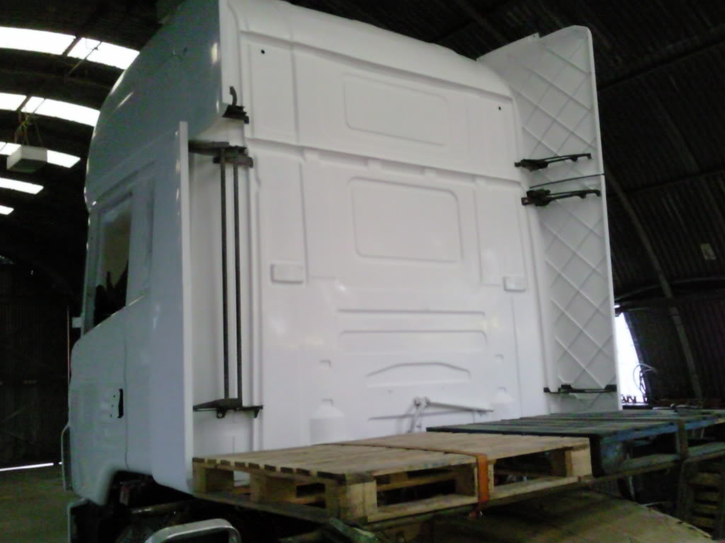

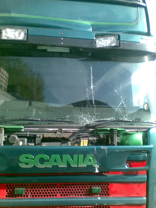

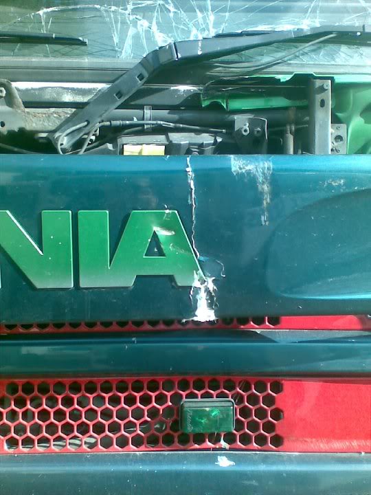

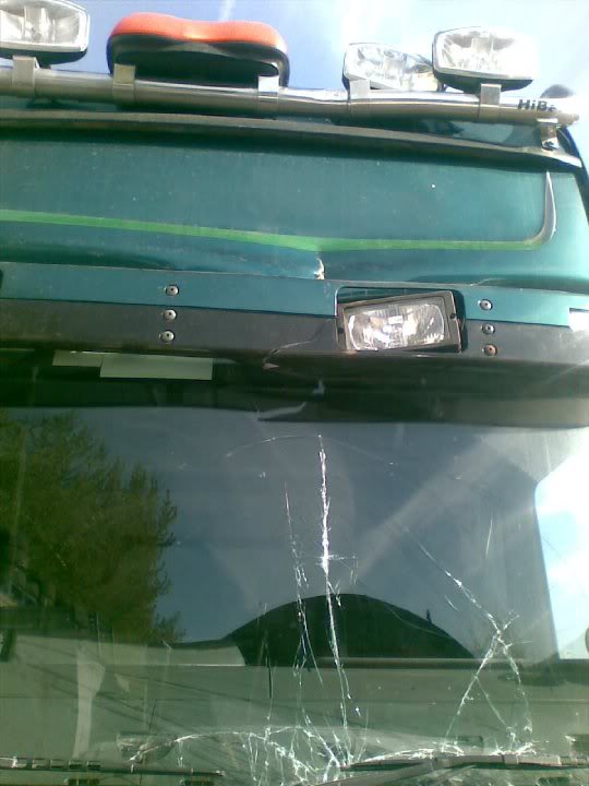

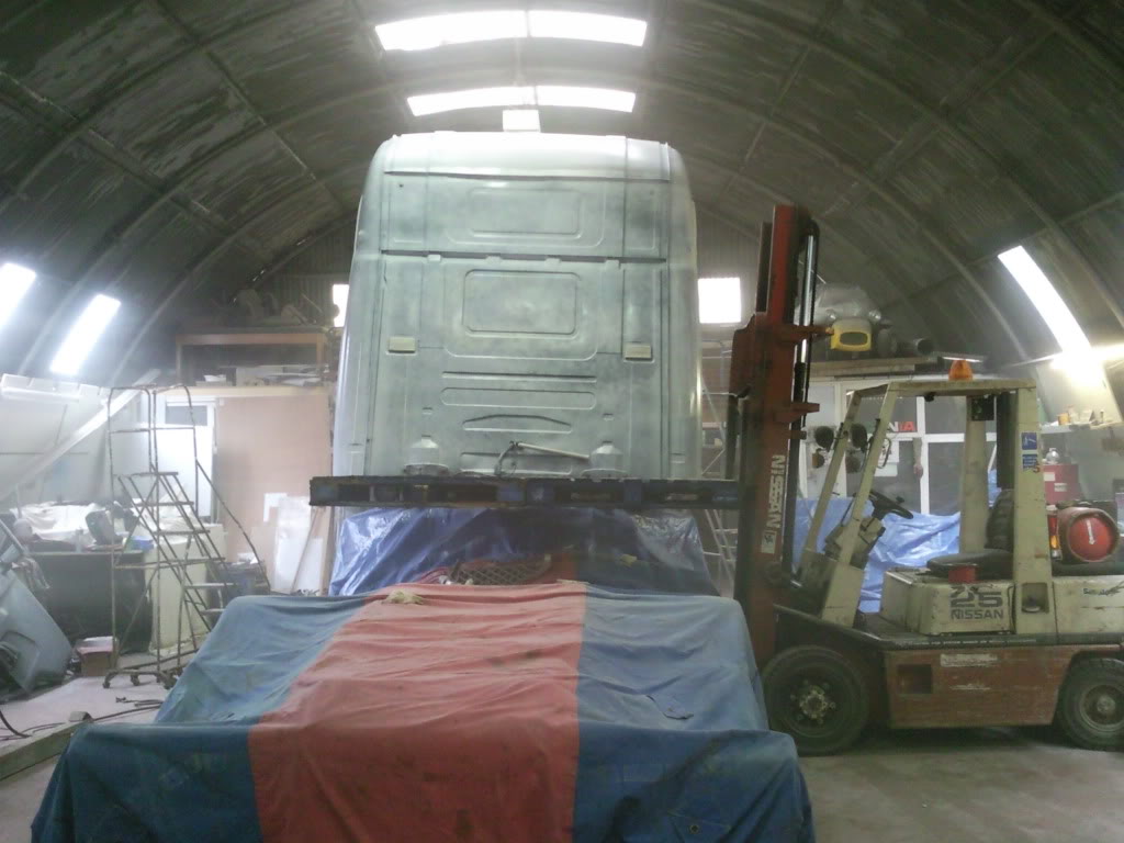

heres some pics of the damage after the trailer went into it.

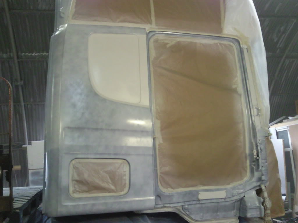

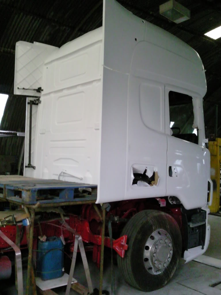

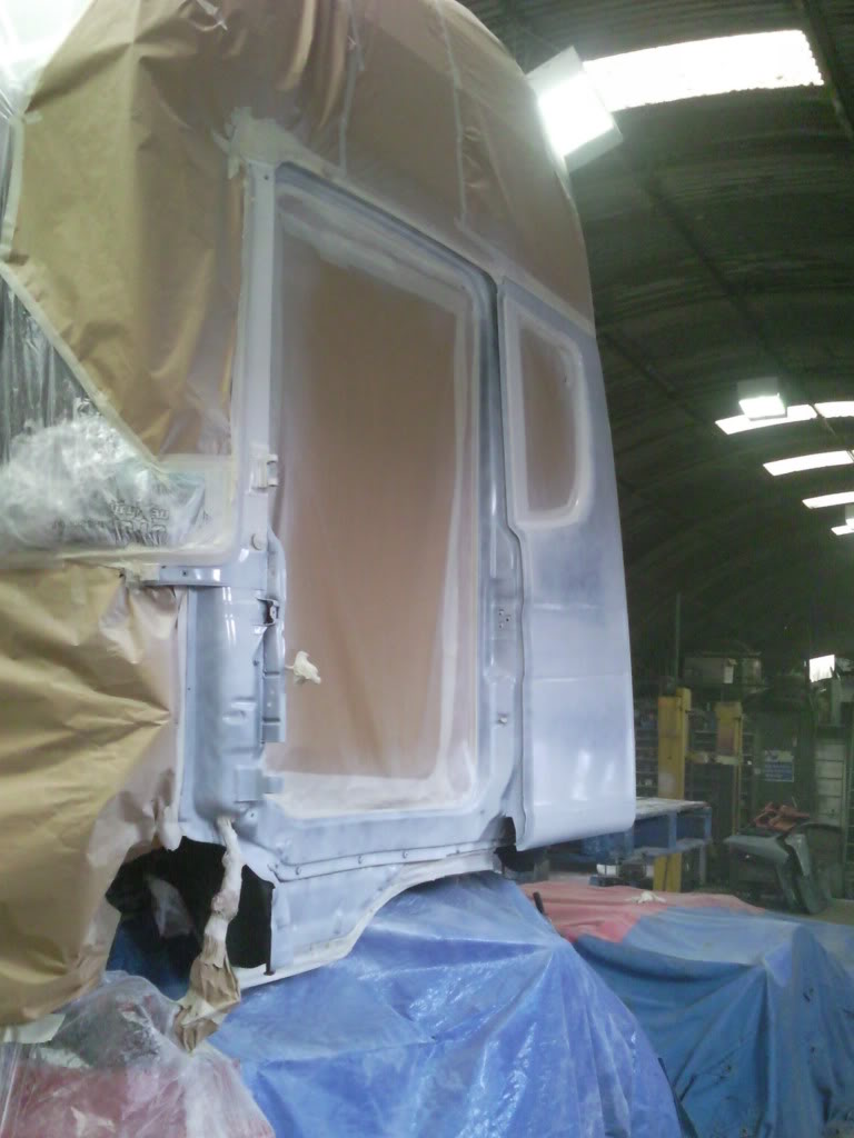

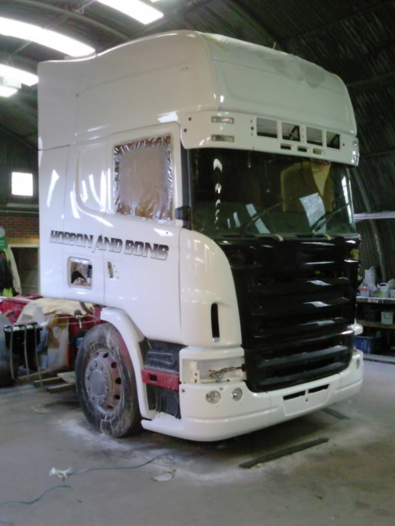

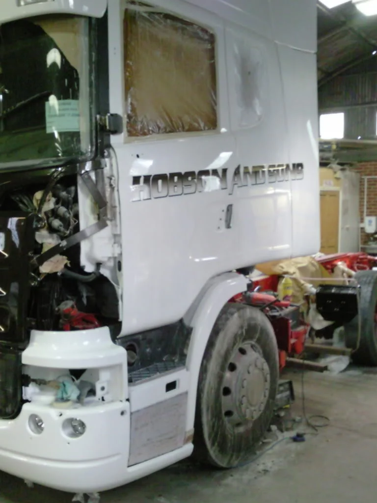

after this the lorry was stripped down and repaired then prepped ready for paint.didnt get much chance to grab many pics so only took a few after the first layer of basecoat went on.

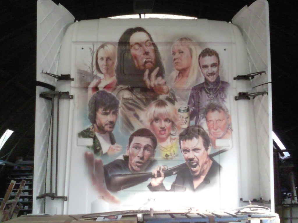

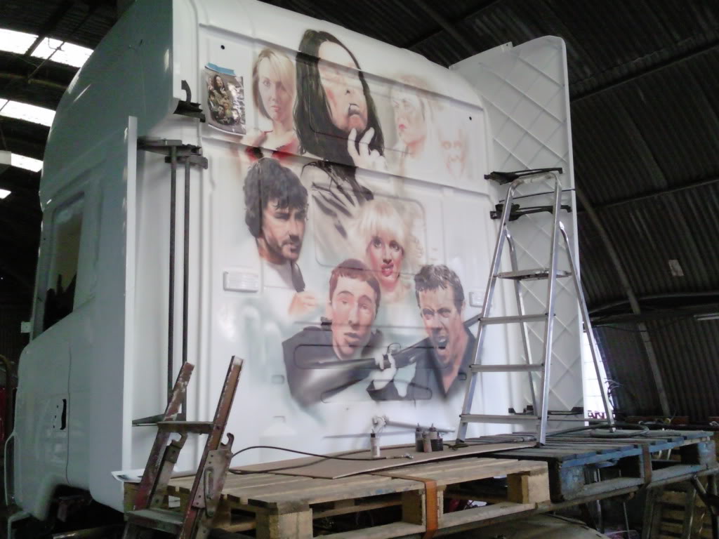

then after it was painted and left to dry the paint was flatted back till it was perfectly smooth and prepped again for adam from scrawl ( considered to be one of or if not the best airbrusher in the country) to come and do his stuff.
here is it in the prep for adam

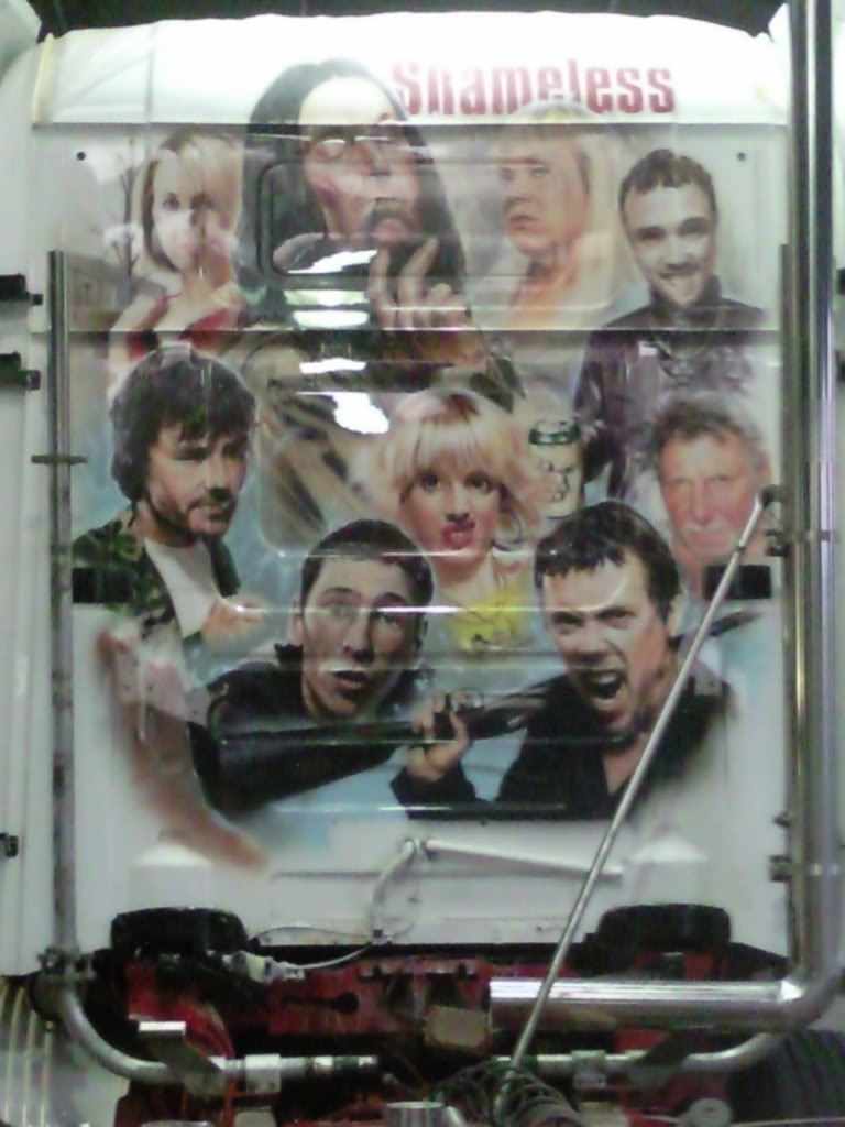

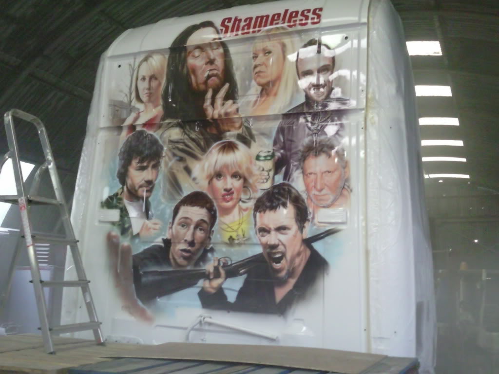

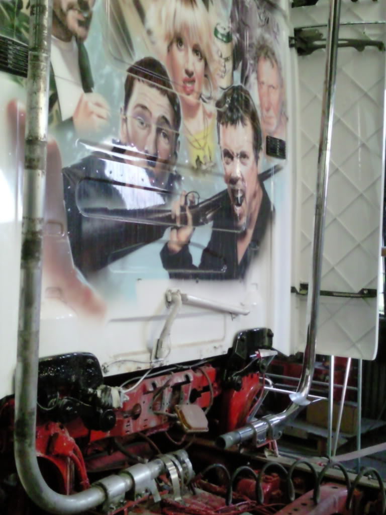

then as adam got to work
then after he had done the cab was given a quick wipe down and laquered

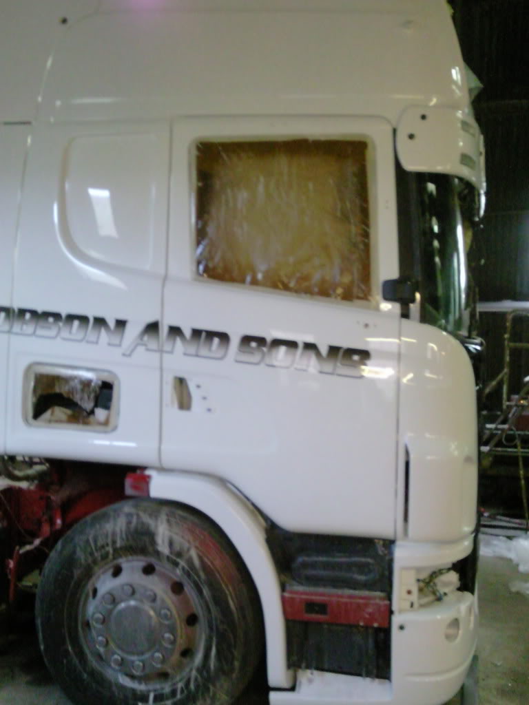

which i then fully flatted and polished to bring the colours out at there best

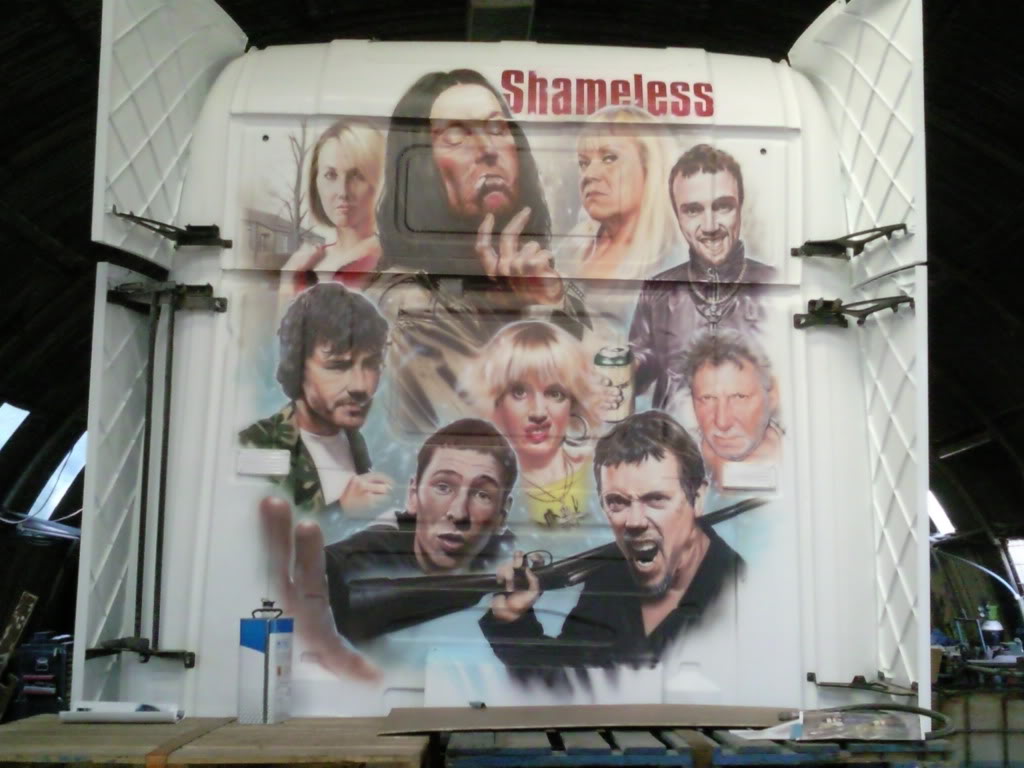

adam then airbrushed the sides on the lorry, originally it was going to have alot of detail done on the sides but it was felt that overall it didnt need to so the company name was just brushed on the sides.

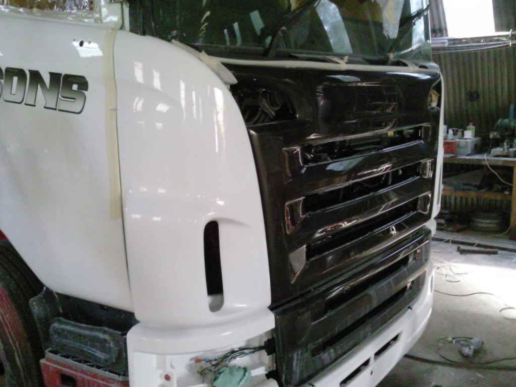

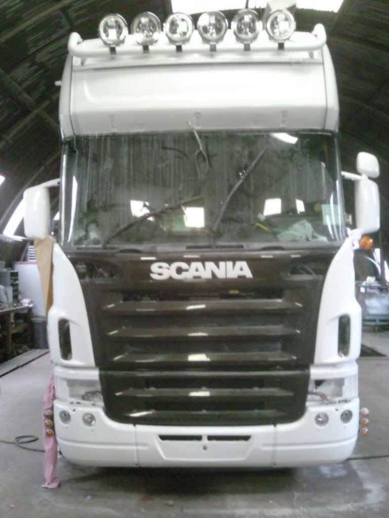

Next up was the grill, the p and r series share the same cab but the slam panel and other mechanical parts are totally different, chris looked up the prices on the scania mounts and fittings for the grill which came to alot of money so decided to fabricate his own from scratch. which took a fair while but got it perfect in the end.
then a pic with the visor painted and fitted.

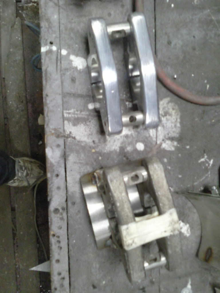

next up was the steps , the p series had fold down steps which were a £2k extra so were worth keeping on the truck , were as the r series discontinued the fold down steps in favour of fixed items.
due to the lorry now having the optional lower bumpers fitted something needed to be done about the steps so i set about using the originals as a mould and fiberglassing them into the correct length and shape.. took some time but it is the only r series with fold down steps and looks wise really makes a difference.
pic of step test fitted after shaping

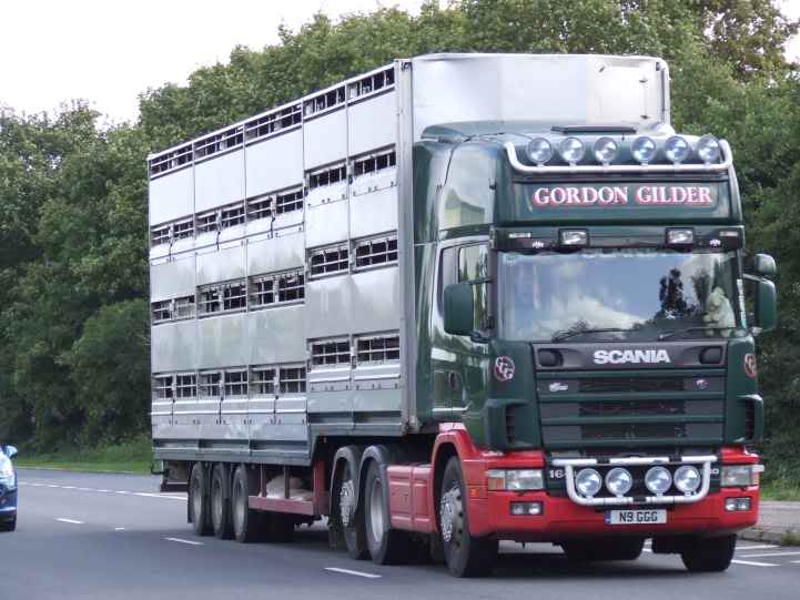

Brave man buying a truck off Ginger gilder!
Edit just seen the top pic isn't the actual truck. Anything with 3xx won't be a v8.

majority was done free hand he used a projector to get the rough outlines and went from there by hand . was amazing to see it being done
  Astra GSI, 172, Golf
he is very very good, the trucks he did artwork on this year placed 1st 2nd and 3rd plus the majority of the contenders lol.. il load some pics of the others up from this firm shortly

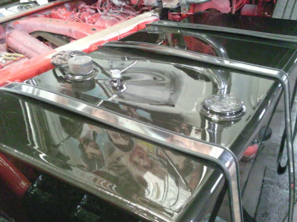

it originally had ali tanks which were heavily oxidised , the rubbers were shot and the straps had seen better days. so the tanks were painted to match the grill then flatted back till like glass and polished back up again.. rubbers were replaced and the straps have a very good polish.

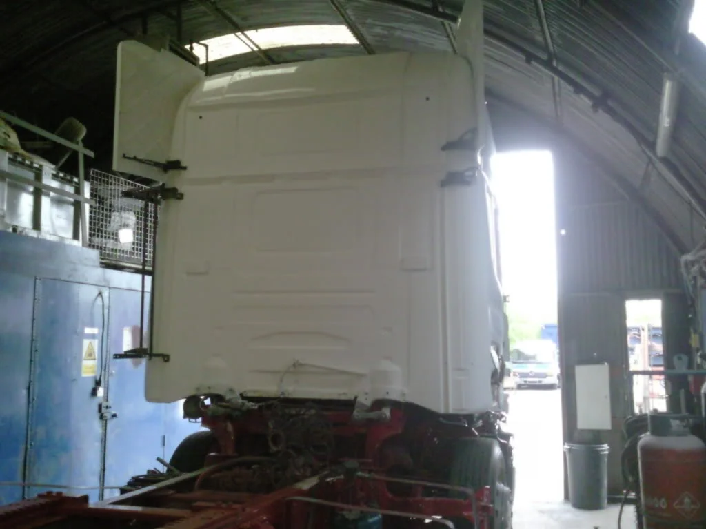

also forgot to mention that the chassis was shot blasted then primed using a airless system and painted in gloss red. almost every other removable metal item was also blasted and powder coated .

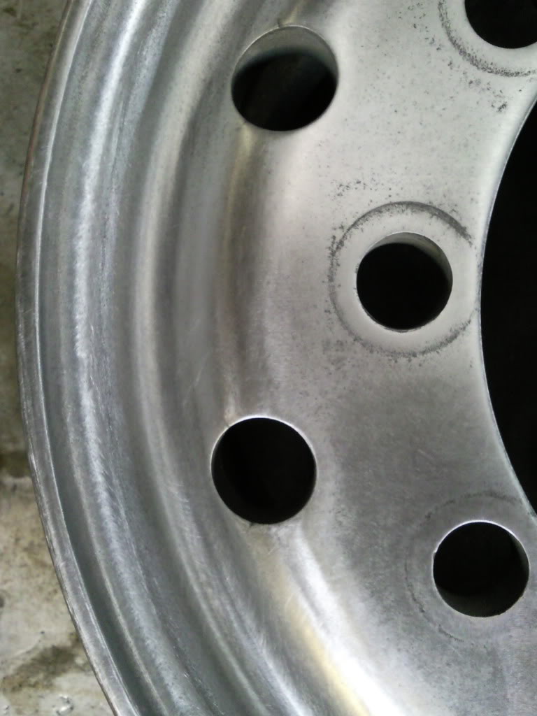

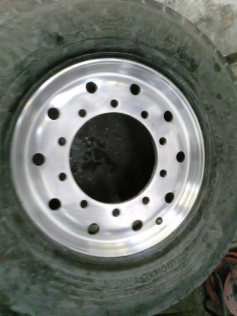

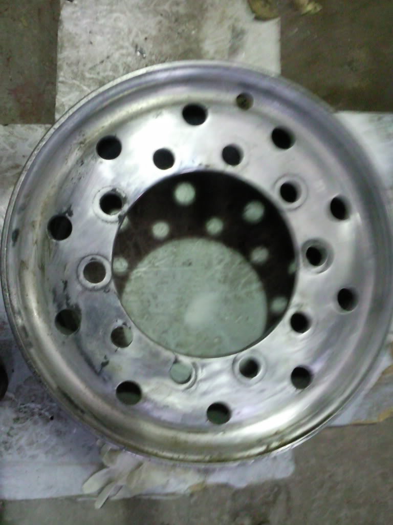

the truck originally had alloys on but he wanted super singles on the front, and is it tag axle ? on the back .. so a set was sourced and sent of to tyre trax to be polished as they were known to be the boys for polishing truck wheels... for howmuch the service was no body was very happy with the outcome so it was my job to redo them again and bring them to a show worthy state. there are also 2 fittings for these wheels standard and retro fit... retro fit require new nuts @ £200 per axle
heres the before and after of the wheels.

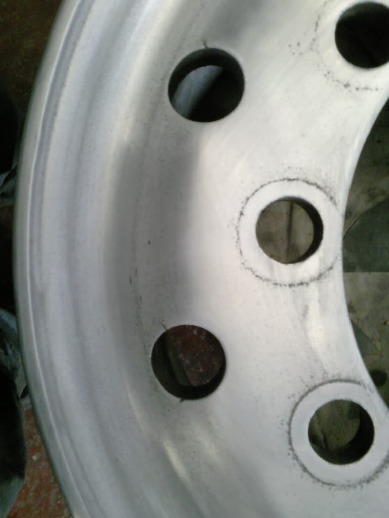

this was the last stage before polish, flatted with 2000grit wet sandign paper
to polish them up i used peek polish, with a farecla gmop which worked perfectly.

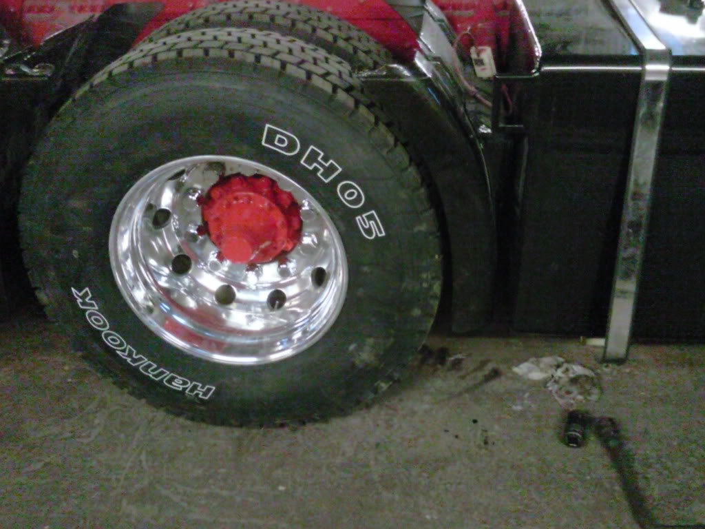

this is one of the wheels i did fitted whith brand new tyres and the lettering painted up

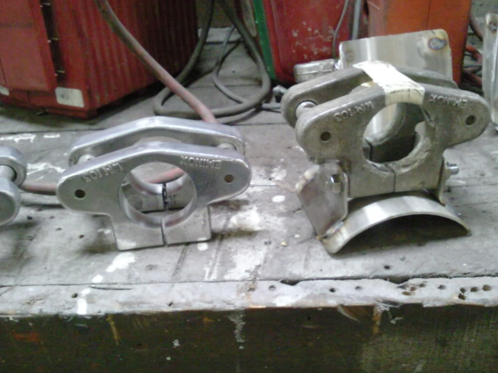

also while i was polishing i did the eminox exhaust brackets
cant really see it to well here due to phone camera but the left hand side is untouched and the right hand side went through the same process as the wheels did

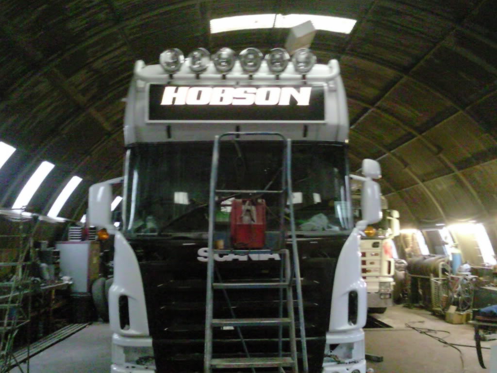

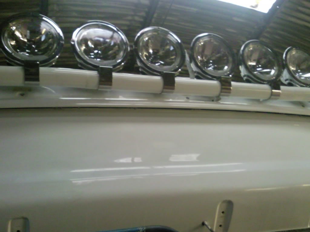

next up was the lighting he wanted dutch styled truck so lolipops were fitted along with some indicators on fitted to the new low bumpers. he also had his kelsa light bar painted white and 6 spot lamps fitted along the top.
the scania badge was also painted white to help it match in better, which i think looks good.

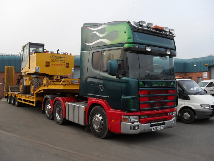

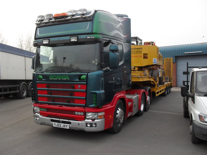

cant workout how to edit the original post but just found some pics of it before any work started.. turns out it was a 580 one of the others must be a 340

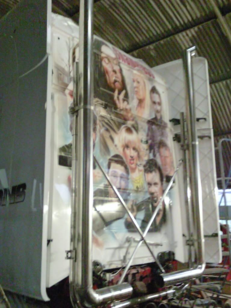

just found the orginal air brushing... how nice
  Mustang, S13, AX GT
It'll probably be a 540 I'd imagine. Looking good though, love airbrushed and chromed Scania's
edit: or a 580 haha :)
