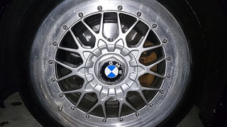

Sheer laziness and idiocy I took my 328 sport down to a hand car wash and it seems they've used an acidic wheel cleaner on the wheels and my once shiny rims now look fish scaly like this.
Are these wrecked now? Or can they be polished out? I have 2 spare ones so I need to know whether i should cancel the ebay auction on them that ends tonight!

No idea never used anything as aggressive as they use. My friend used them regularly and they tarnished the wheels on his Seat Leon .
Have you got any mild polishing compounds to try and see it it's just residue on the surface?

Can't see properly but I reckon that's fucked the the lacquer. It's probably lifted it from the metal.

I immediately got some liquid metal polish (brasso type stuff) and gave them a couple of goes by hand. That's the pic AFTER doing that tho!
I've cancelled the listing for my spares now so I'm just gonna have to get them on and get a polishing head for my drill and try that.
Just google searched and it seems they can be recovered but will take some elbow grease!
I'm not a car detailer so I've got nothing with me except my brasso and Autoglym wheel sealant which is not much use now. Bummer. You live and learn.

Looks like bare metal on the rim and painted/lacquered spokes (but they aren't affected).
  Golf GT & A4 Avant
If its bare metal that's affected, get some metal polish. Halfords should sell autosol and try working that before you go at it with drills and dremels etc. The least abrasive the better

Yeah maybe the shite I bought (brasso style) isn't up to it. Will get a tube of autosol on it (the paste stuff in a tube?)
cheers chum. Might give the rears a go too - think they're brand spankers and look more of a brushed aluminium rather than polished like the fronts.

Well I tried the Meguiars 'metal polysh' (yes correct spelling!) that was suggested on e36coupe.com and I opened it up and wasn't that impressed to be honest, smelt and felt more like hair wax than a metal polish, but had a gift card to use up so thought what the hell, it's the most expensive one at Halfords.
OH MY GOD!!!! It's brilliant!!!! The second it hit the metal I saw instant results. I'm gonna need a LOT more cloths/paper towels, the brand new cloth I bought is completely black from 10-15 minutes on one wheel. There are some stubborn areas that will need some more attention and I'll probably need to get a machine to get to the fiddly areas, but I am SO impressed with this product. How could I ever doubt Meguiars.
I'm so impressed I'm thinking of taking my brand new (still clear coated) rears off and polishing up my spares and fitting a pair of rainsports and putting them on.
The polished finish looks brilliant.
Anyway, a lot of elbow grease to come this weekend, but there is light at the end of the tunnel and massive thanks to all that chipped in.

Very happy! Polished rims looks amazing. Just got my dremel tool that I bought once and hardly used and it's got polishing compound and pads all there untouched! Bonus!
