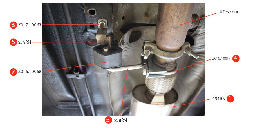

If you want a extra hanger for the 494RN scorpion Resonated Centre Silencer Box then they will send you one. If you click the link below then download the PDF Fitting instructions, all the info you need is there.
Scorpion know there is a designs fault with there part, at least they admit it and take the time to come up with a solution to the problem.
http://www.scorpion-exhausts.com/product-details.html?autoid=343

I take it you mean this bit?
First time I have seen this. Does it fit the RS192? My cat sags there which is highly annoying.

I have one of those brackets on my exhaust, still hangs down and I still scrape it on speed bumps! Words cant describe how pissed off I am with my scorpion exhaust. Honestly think id be happier with the standard exhaust right now!
