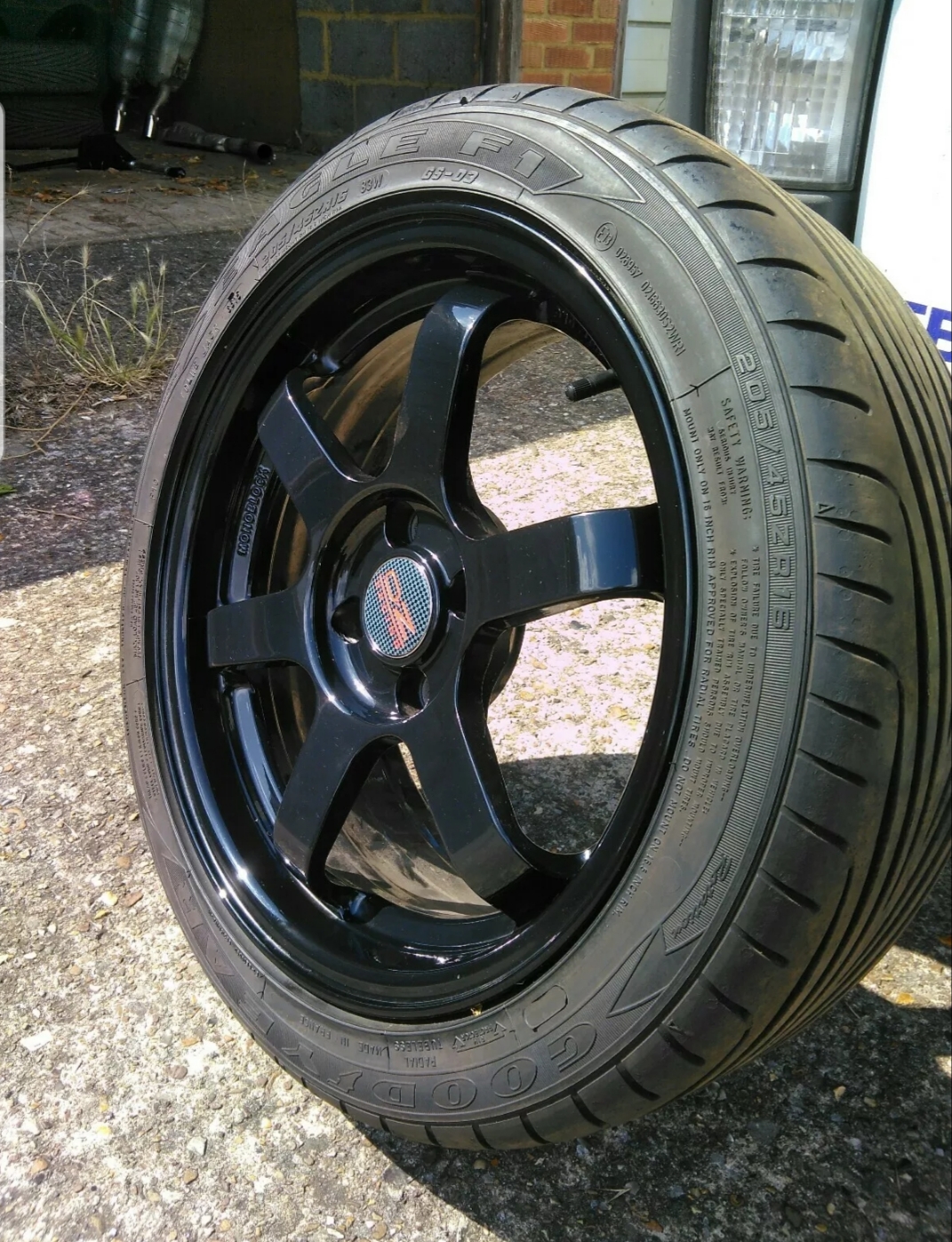

Just fitted new wheels on my 172 which are et25 7j running 205/45/16 tyres. Also lowered on sportline spring.
Had to re-align my rear bumper as they are very close to the arches, which has stopped them scrubbing. However when I took the wheel off to do this I noticed marks on the shock cover where it looked like its been rubbing.
I am thinking surely these must have been there from the previous wheel. Would there be any logical way of the wheel catching the shock when they are so far out in the arches?
I did have a look as best I could but harder to see once its on the ground. Might try looking with my phone camera after work :LOL:
The wheels are et25 so cant put spacers on them as they were a close fit as it is.
These are the wheels - Dont know the make unfortunately (suggestions welcome)

I checked and the wheel is clear from the strut, just strange as the wheels I took off were original OZ f1s so cant see whats happened?
They look like Rota Grid wheels :)
That is what thought they were ?
