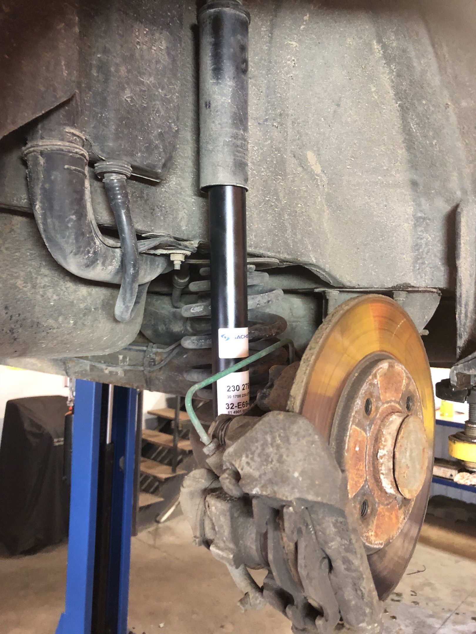

hi all, after long time i’am back with ph1 sport, but i’am having firdt issue.. my rear left wheel scrubs inner arch at the time iam making turn to right.. clio sits on standart r16 wheels.. tyres not too vide

my rear shock is leaking, will try to get new after holidays, ant i what to get f1 wheels instead of current r16
again here, so, i replaced my rear shocks, bet scrubbing still here :( on upcoming week i should get oz f1 r 15, maybe this will help me to get it done..
