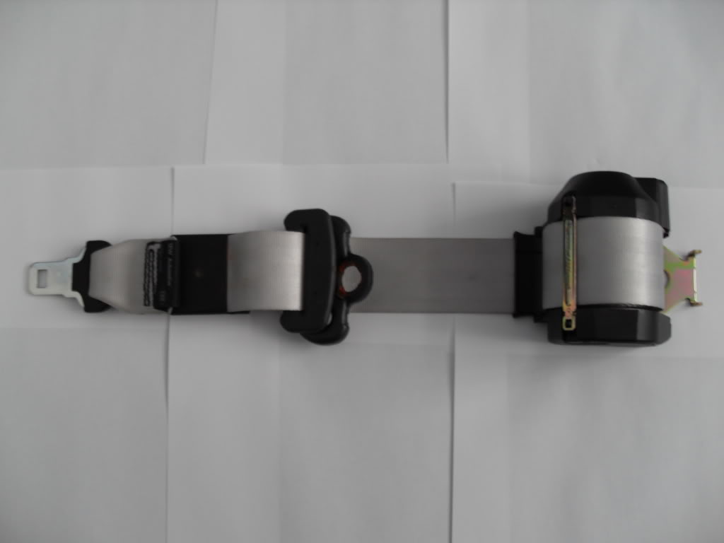

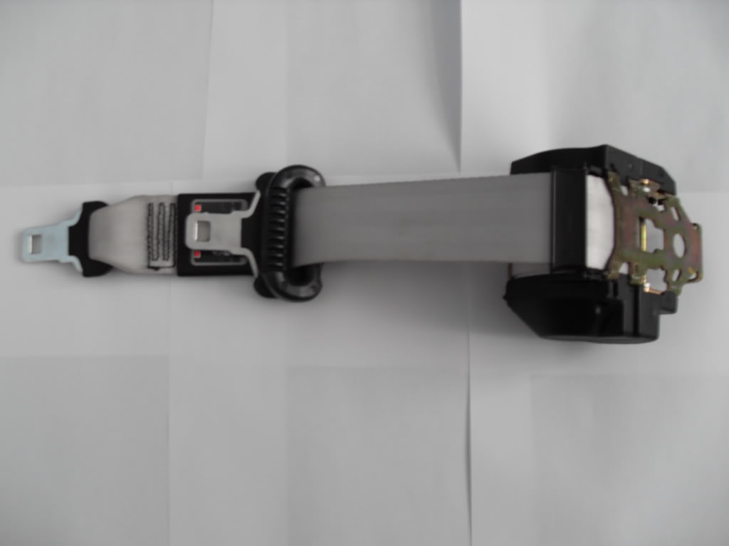

Ill post some pictures up of the culprit.

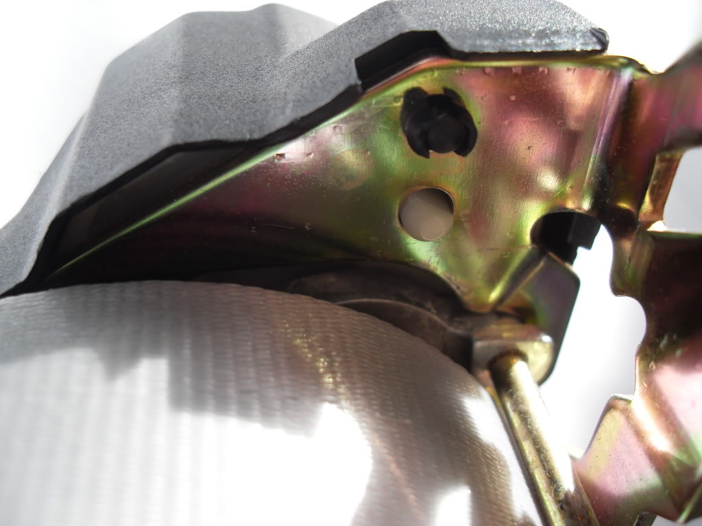

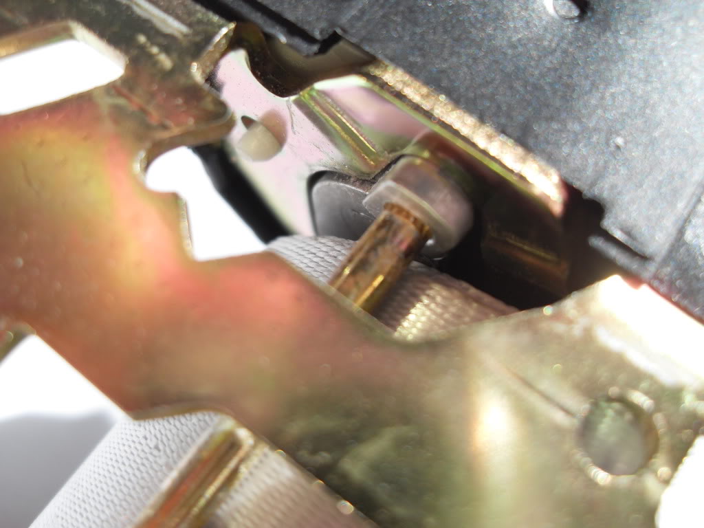

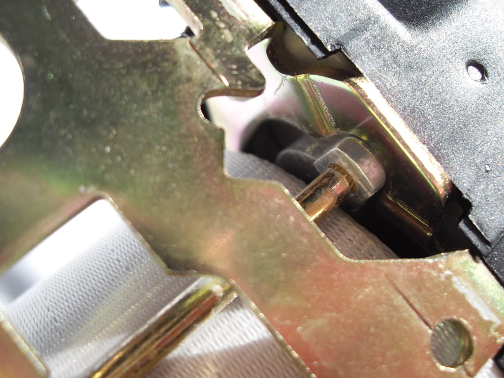

This is the problem part:
This is it without any pressure:
This is it with a small amount of pressure:
