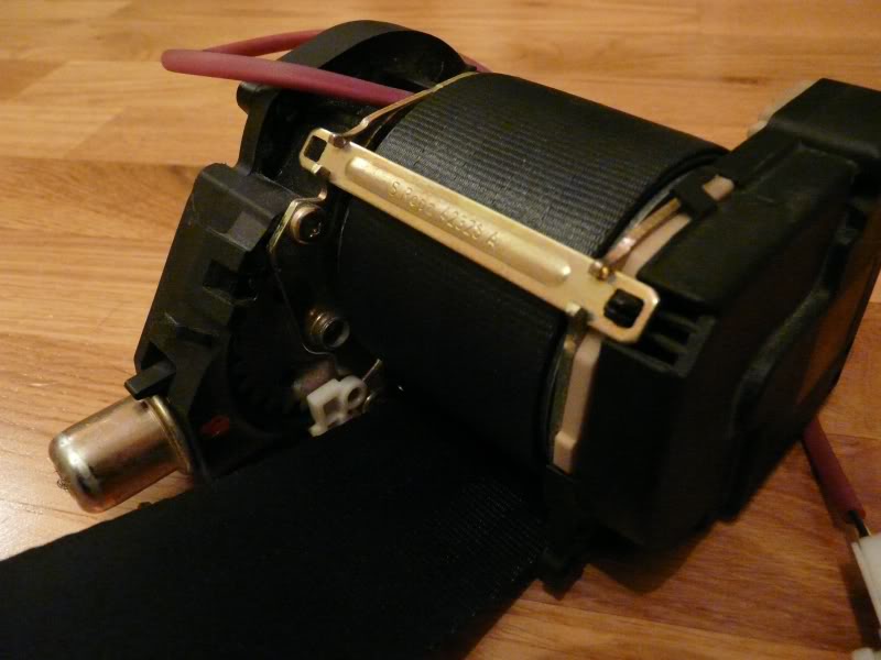

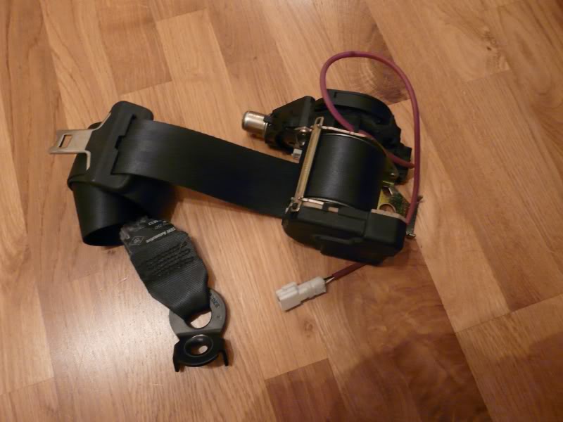

best i can do mate. Looks like they do have a pyrotechnics charge inside the reel after all. This was taken from the rear, so it may differ on the front, sorry... not as much help as i thought. Can't dismantle it anymore than it is, as there are warning of explosion all over the covers lol.
think it might be a new unit needed, as it is impossible to rewind this thing. Like i said, if you are replacing... don't buy new if it can be helped, they are a ridiculous price
that was quick! thanks a lot for that; does seem that new reels are going to be the simplest answer
ed. thinking on, if that's the rear belt, may be there isn't a second charge in the front system (as you say); will have a look at some point anyway
