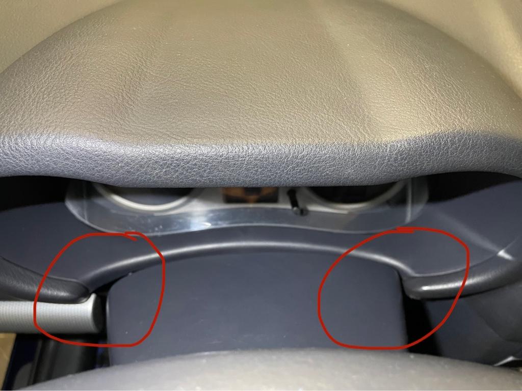

Already know that the seating postion isnt straight like it should but in my case i think it is a bit too much.
I have a clio 2rs ph2 2001, we changed to a electrical column but before it was the same.
I also unscrew the seat and the column to straight it out, it helps a little bit but still not straight like it should..
Does anyone fixed this or have the same issue?
In this foto you can see the steering isnt lined up.
Thanks
Enviado do meu iPhone usando o Tapatalk
Beauvais Motorsport
I'm not sure if the lhd version has the same design as the rhd, but the wheel is offset and angled in the rhd cars.
You can grind some material away from the bracket mounting holes to gain a better position of the wheel, but its not a major difference.
