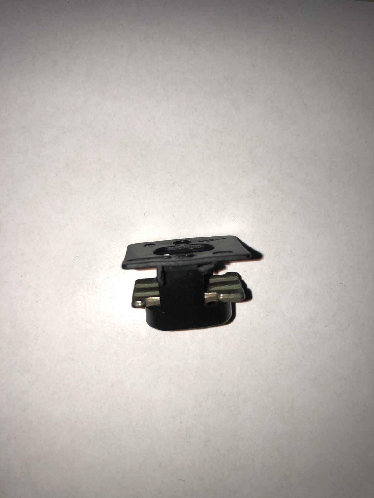

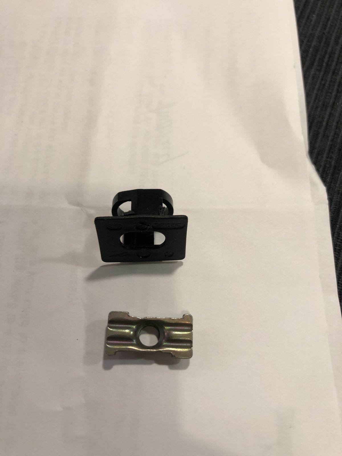

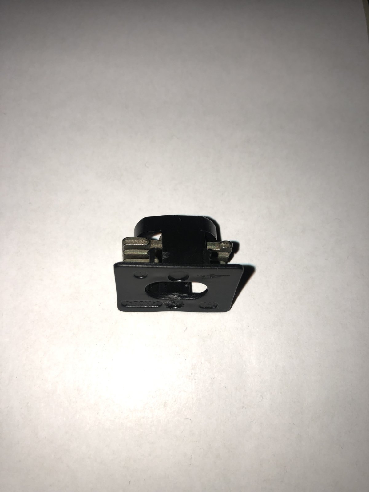

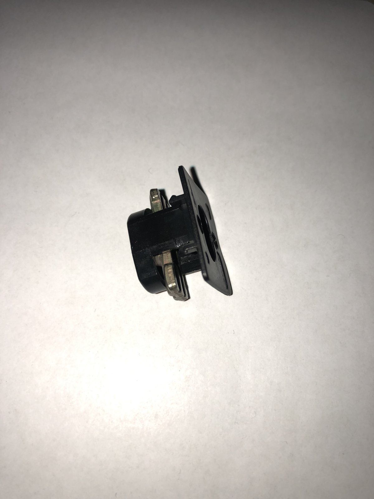

It’s this that you need. I got this from a scrap yard. It’s a bit fiddly to get off without breaking it.

Hi Eddie
Thanks for the photos.
That's the part, are go to the breakers yard tomorrow, How did you get it off, a flat head screw driver?:)

It’s really fiddly. You have to put your arm behind the door skin and turn and separate the metal piece from the plastic clip. Then prise the plastic clip out of the door gently without breaking it to pieces as it’s quite fragile. If you can imagine that the metal screw part is what sandwiches the door skin with the plastic part which then holds everything together as you put the screw in. When you see one in a door you’ll understand it more.
