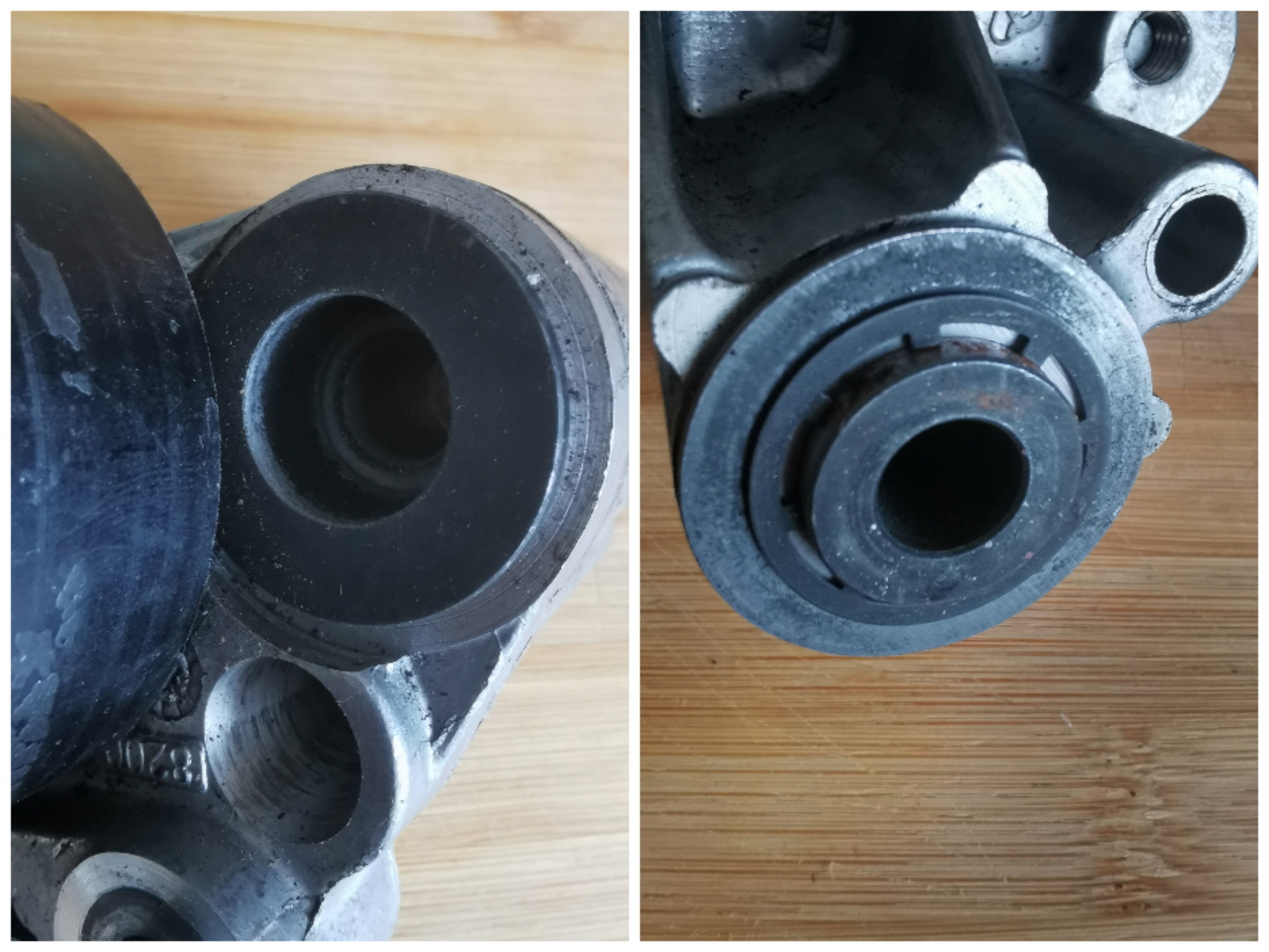

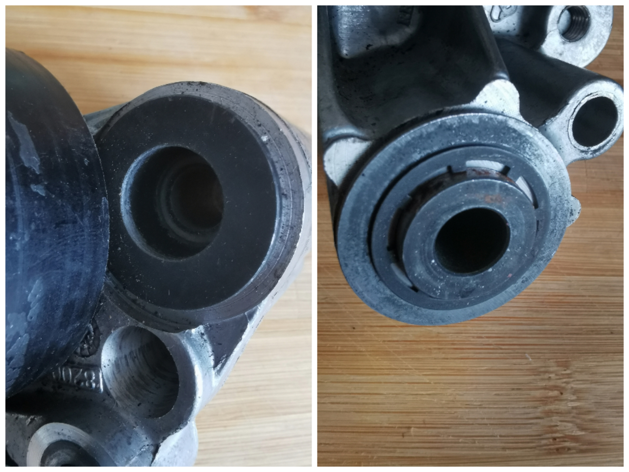

I got hold of a 2nd hand aux belt tensioner.
I did tag this onto a previous post of somebody else's but nobody responded.
The black part thats held in with a bearing clip. Is it supposed to spin freely? I think it is supposed to, but just want confirmation.
It doesn't look rusty so maybe just needs a bit if lube?
Mr Underhill
It doesn't look rusty so maybe just needs a bit if lube? View attachment 1680073
I’m 99.9% sure that bush is meant to be tight in the body of the tensioner. The circlip is there to hold it in place.

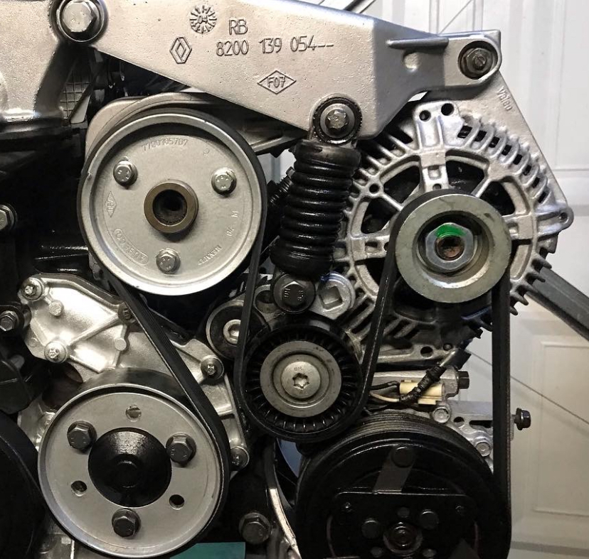

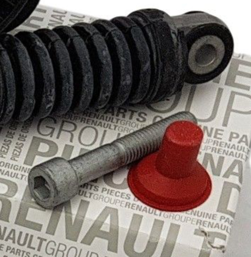

To facilitate belt removal with the tensioner tool, it must be able to move and pivot as needed. So it’s fixed in with a partially threaded bolt - see picture below. I can remember it never fully tightening, so it rattles slightly.
Here’s a side view of it fitted to my engine.
You can see it just to the bottom left of tensioner spring held in with the Allen bolt. The bolt only goes in so far. So the bush moves around the bolt.
Here’s a picture of the bolt.
It was a few years ago mind, but I do remember it never fully tightening. I remember stuff like that 😂

MRBILLYUK
  FF Jeden Osiem Dwa
Thanks for the reply 👍
I have another one where it does move freely, as in this video.
So the one that doesn't move at all must be seized? I've just given it a good soaking in plus gas and see if it does free up.
