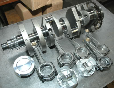

Do you have to take the rods off to fit the pistons?
How else would you fit new pistons?

lol was that a stupid question?
How does the piston attach to the rod? You have crank to con rod and con rod to piston connection dont you?
Cant you use a low comp piston on a standard rod?
On this picture you have crank, con rods and pistons.
Cant you leave the con rods attached to the crank and just fit low comp pistons?
No, because you wouldnt beable to get to the gudgeon pin holding the piston onto the rod.
Taking the rods off the crank isnt too bad anyway
