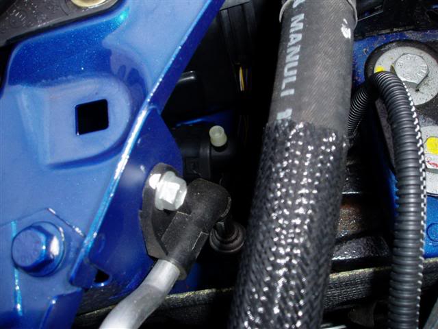

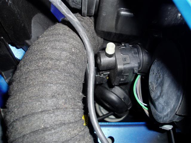

i know the xenons are self levelling on the 182 but is there a way you can adjust them because mine seem really low? Anyone else having this problem?
Stu
  172 cup'd extreme
under bonnet , above the light unit there is a white 5mm hex nut drive to a wall in the dark and adjust away dont have them too high, if you find you have overshot then just use your leveling switch near the esp switch to adjust them

mine dont appear to self level some you can actually see move into position but mine just ping on. I have adjusted them now so will see how i get on. Its difficult to get it exactly right.
