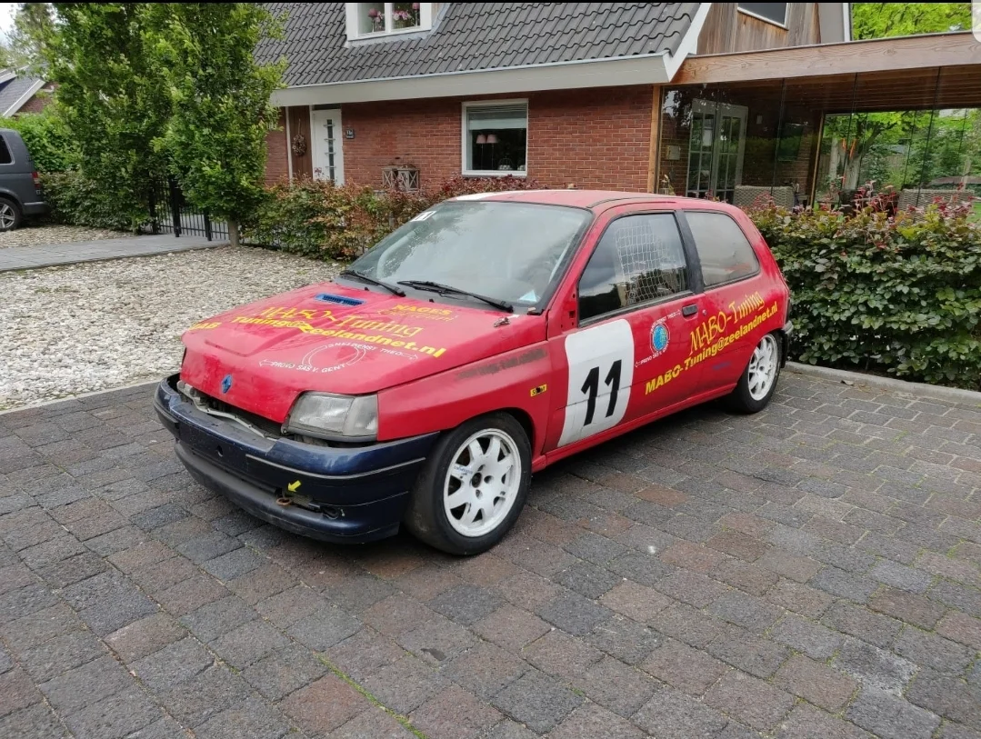

Here is my thread of my Mk1 clio cupracer i bought in the summer of 2018
I bought this clio initially to have a cheap tracktool project i was going to race in the timeattack series here in the lowlands of holland.
it was in quite a sorry state to say the least :(
it had awfull white wheels, a bent front chassis bar, f*cked slicks and didnt run.
all in all it was a mayor question mark for me. but i did find one thing. J J initials stamped into the alloys.

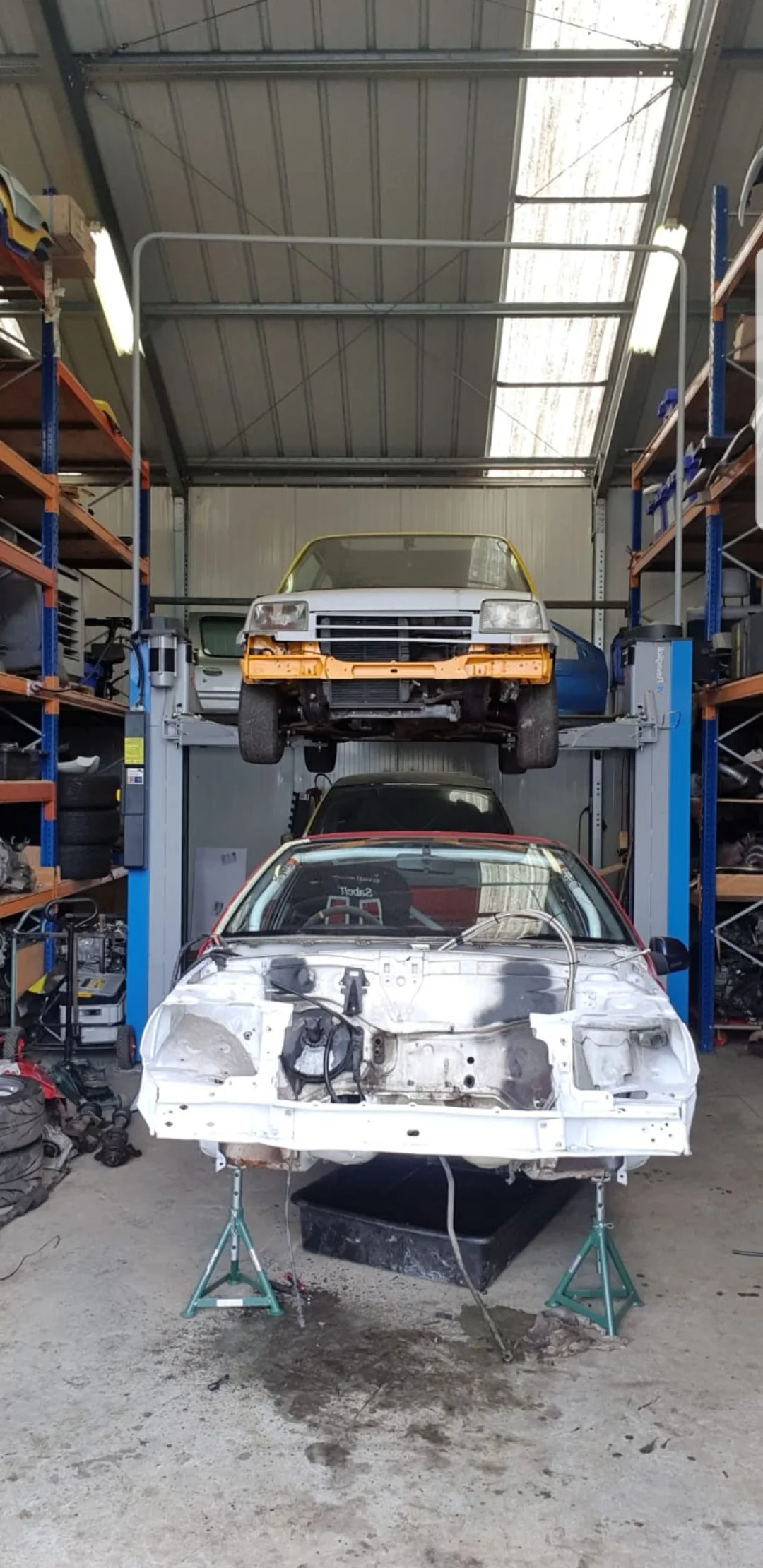

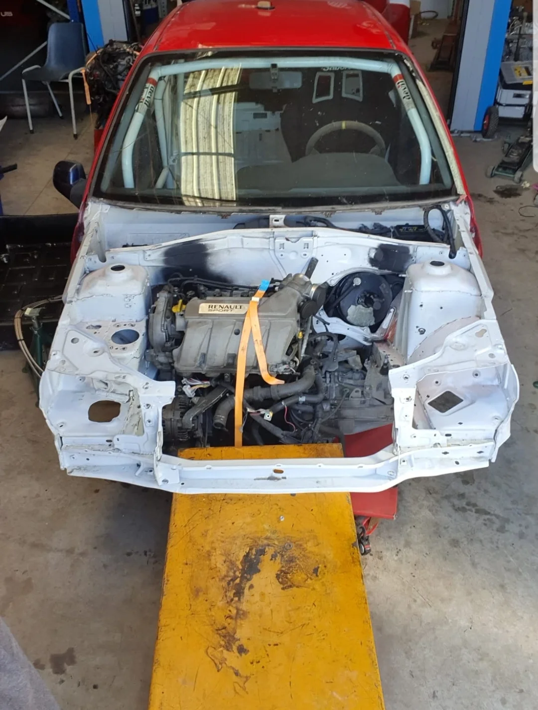

in 1 day i stripped the entire front end back to bare.
and for funsies i also tried to fit a 197 engine into the engine bay. it just about fit in there.

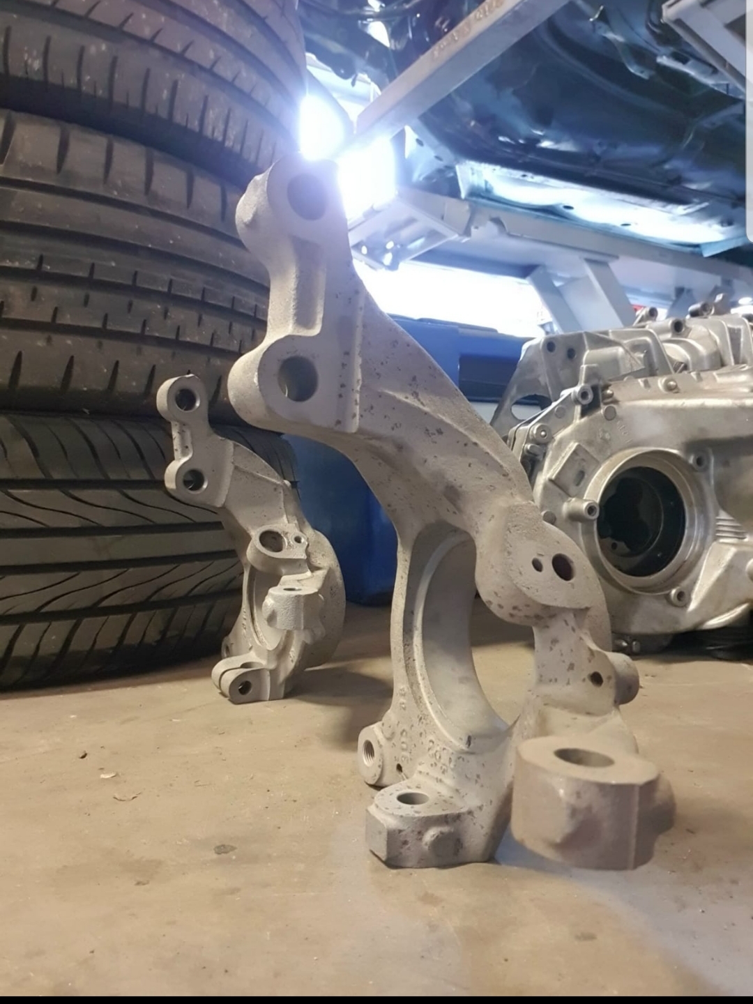

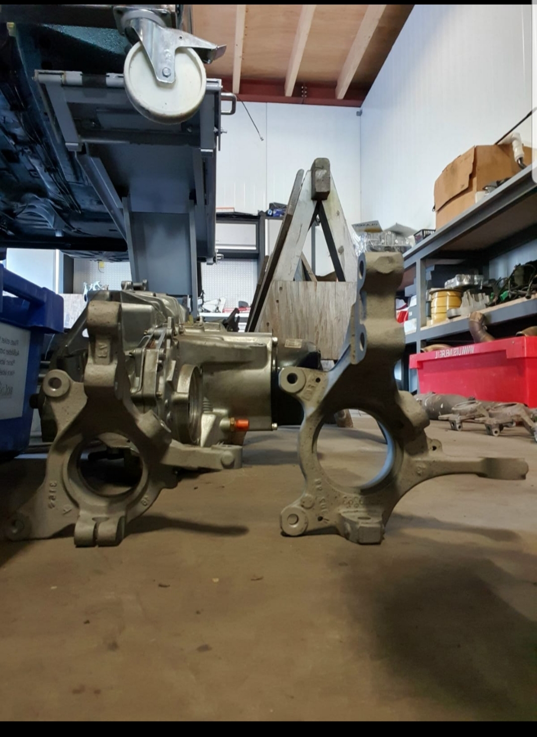

during the 2 year period i have owned this car alot if developments have been done by the valver groups on Facebook. Paul (harlowcupracer) told me about the 172 wide track conversion and the stub axle conversion where you basically make the 16V a much more modern track car
needless to say i got to work, since i work really close to a Renault specialist i have access to a huge information supply.
needless to Say me and Henk went to work on parts number from the hubs from the following cars:
172 ph1 (54mm)
182 cup (60mm)
x65 cupracer (65mm)
Henk had new ones around so i got those for experimental work and i got to work,
i found out that the Scenic RX4 and the Laguna 1.2 uses the same 60mm hubs as the 182 cup/trophy.
the Laguna 1,6 16v uses the exact same as the 182 cupracer. where most people would use the 2.0 12v ones which are just a bit different as the 2.0 dont have abs holes and the 1,6 does have them. the cupracers also have abs holes but werent used regardless.
172 ph1 (left) vs X65 Cupracer (right)
the cupracer ones also use a slightly different wheel bearing that is 0.1mm thicker then the normal laguna one as the laguna ones have the abs ring directly on the bearing face.
i've yet to bring all the parts to the powdercoater and get on further with the process but that will come eventually i guess.
as the mk2 cupracer use a 65mm spacing between the holes of the coilover i needed to get me some mk2 cupracer shocks but ive found another way around that issue as the bilstein inserts the mk1 uses fit directly in the mk2 coilover body therfor letting me switch from the mk1 outer bodies to the mk2 ones which are also adjustable.
there for i can make my mk1 alot more modern and increase the track width around 30mm per side, now i have created another bigger problem as my front arches as to shallow to fit the wheel behind, god do i love the issues a 30 year old car brings along.
now i just need to figure out what to do. wheter to keep the x65 cupracer items and use those or switch back to 172 ph1 parts as those let me retain the standard front arches.

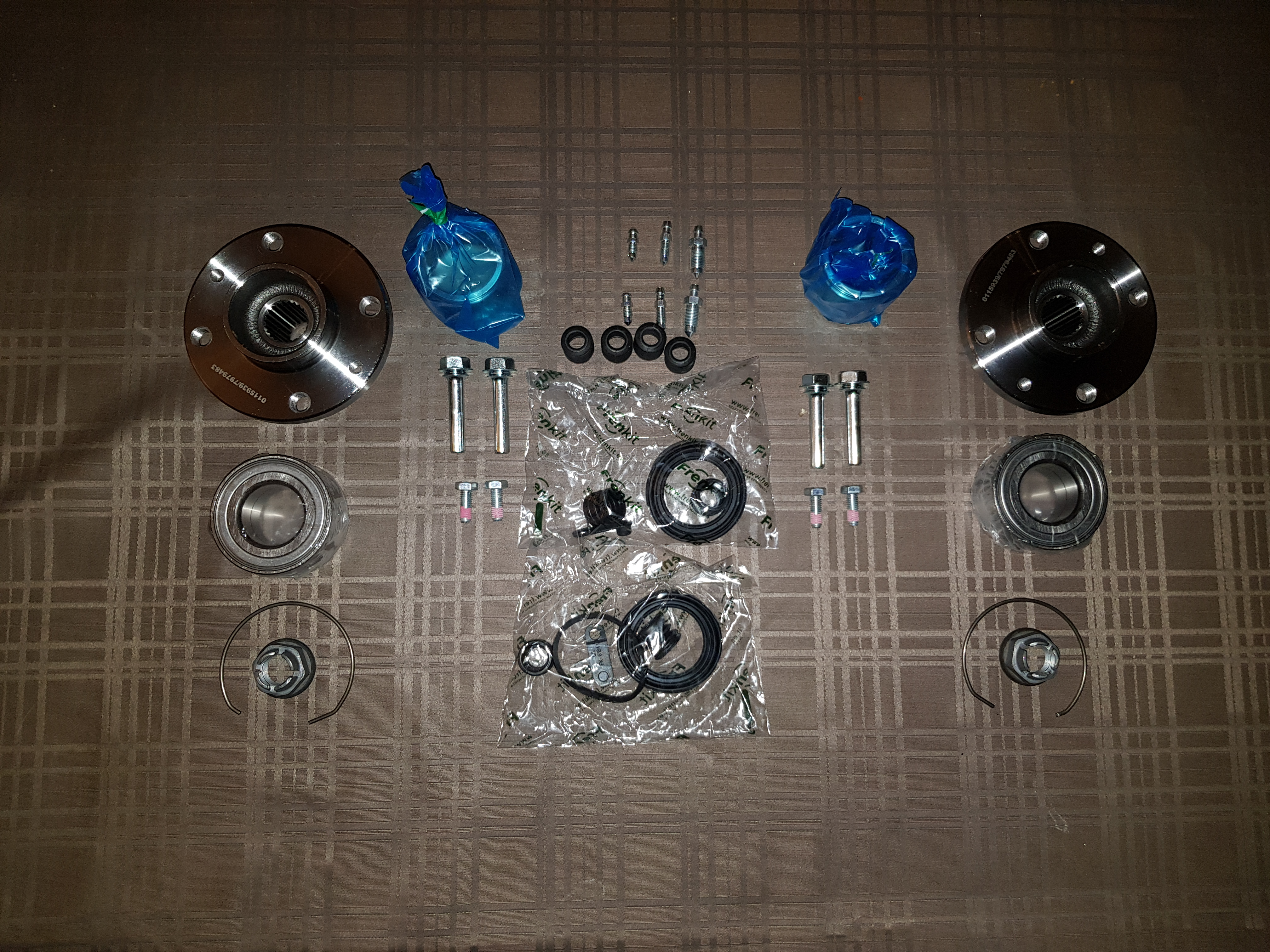

Its been a darn long time since postings but alot has happend, cars were sold and new came, along with their problems.
Yet i never began to continue the hub exchange service i was going to do.
But now the first bits and bops came in, i can get started.
I bought the supplies and the Cerakote Oven.
Here is a picture of the bits i will use on my first official set:
People who are intrested can always send me a message about the hub exchange programme or other questions regarding, cerakote or restoring the suspension of their 172's or 182's
