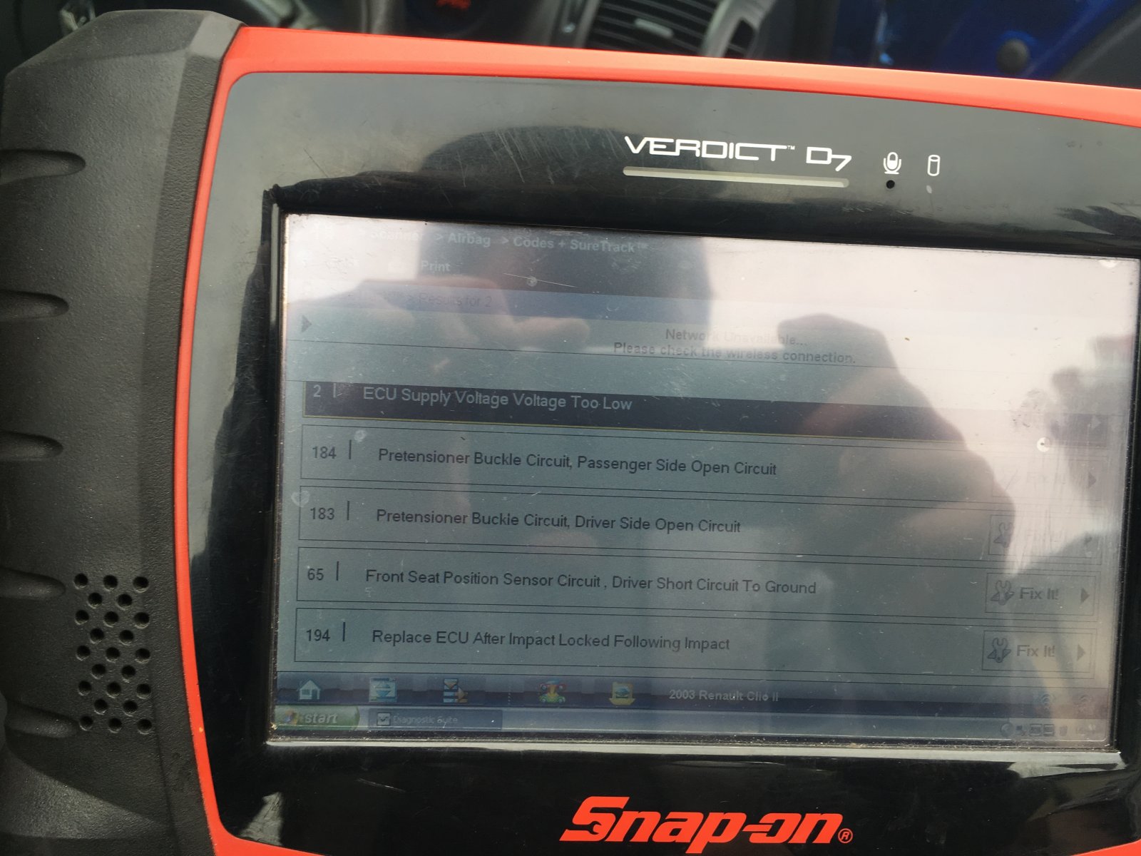

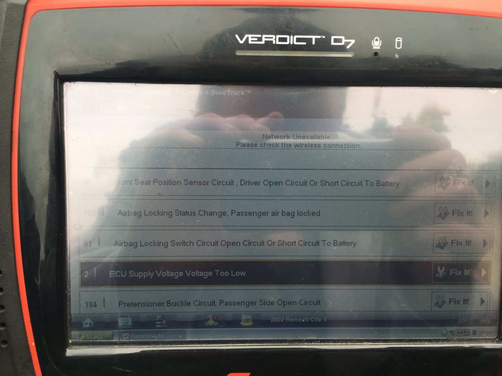

SERV and airbag , got picture of faults but dunno what the bottom line is
  172 cup
can someone tell me in a nut shell for a dummy what my faults mean! many thanks
been having nothing but problems since failing its MOT and trying to fix it , can someone give me the bottom line on what needs doing to it or replacing to get it fixed. many thanks

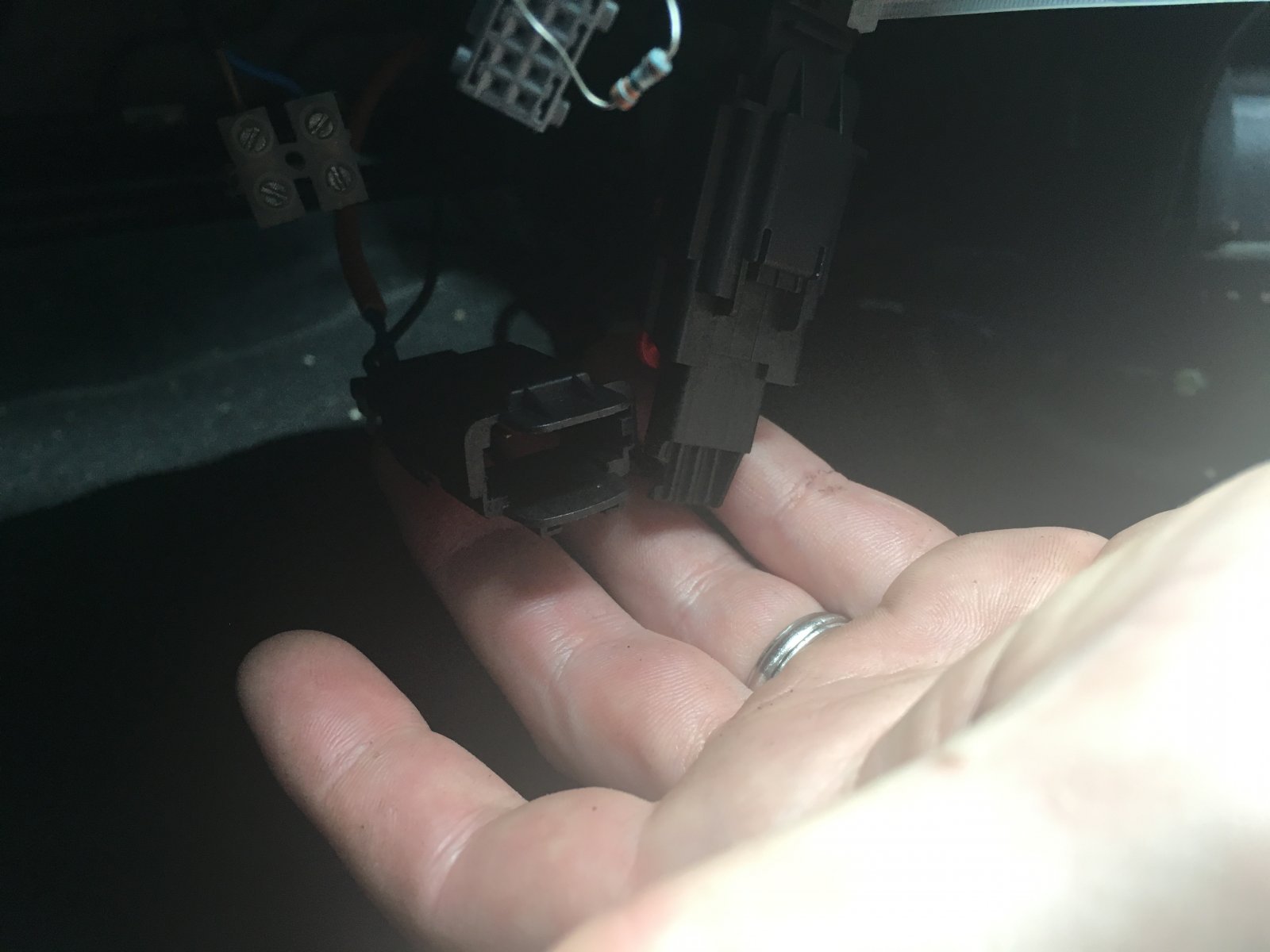

under the seats I don't have these connected dose that matter ( what are they for anyways) but the guy did say that the wires going into the grey connectors where thicker on one side than the other unsure why so that affected the resistance or something,

so if I get it wiped / a new one . id still have to replace the faults with the serv and airbag lights?
the lights wont go out because its been crashed?

If the ecu reads crashed data it will not remove if you fix all the faults they will still show

What happened with all the seat wiring ?! You need to sort this properly and see what codes disappear.
Perhaps the knock has triggered a sensor and locked the ECU, if so, you'll need an airbag ECU with the same configuration code which is written on the top
(Cup spec - No seat airbags, some seat belts have wiring plugs some don't etc)
  dan's cast offs.
you need the crash data clearing first before you do anything. once that is done or you chuck another airbag ecu on then see what faults come up.
