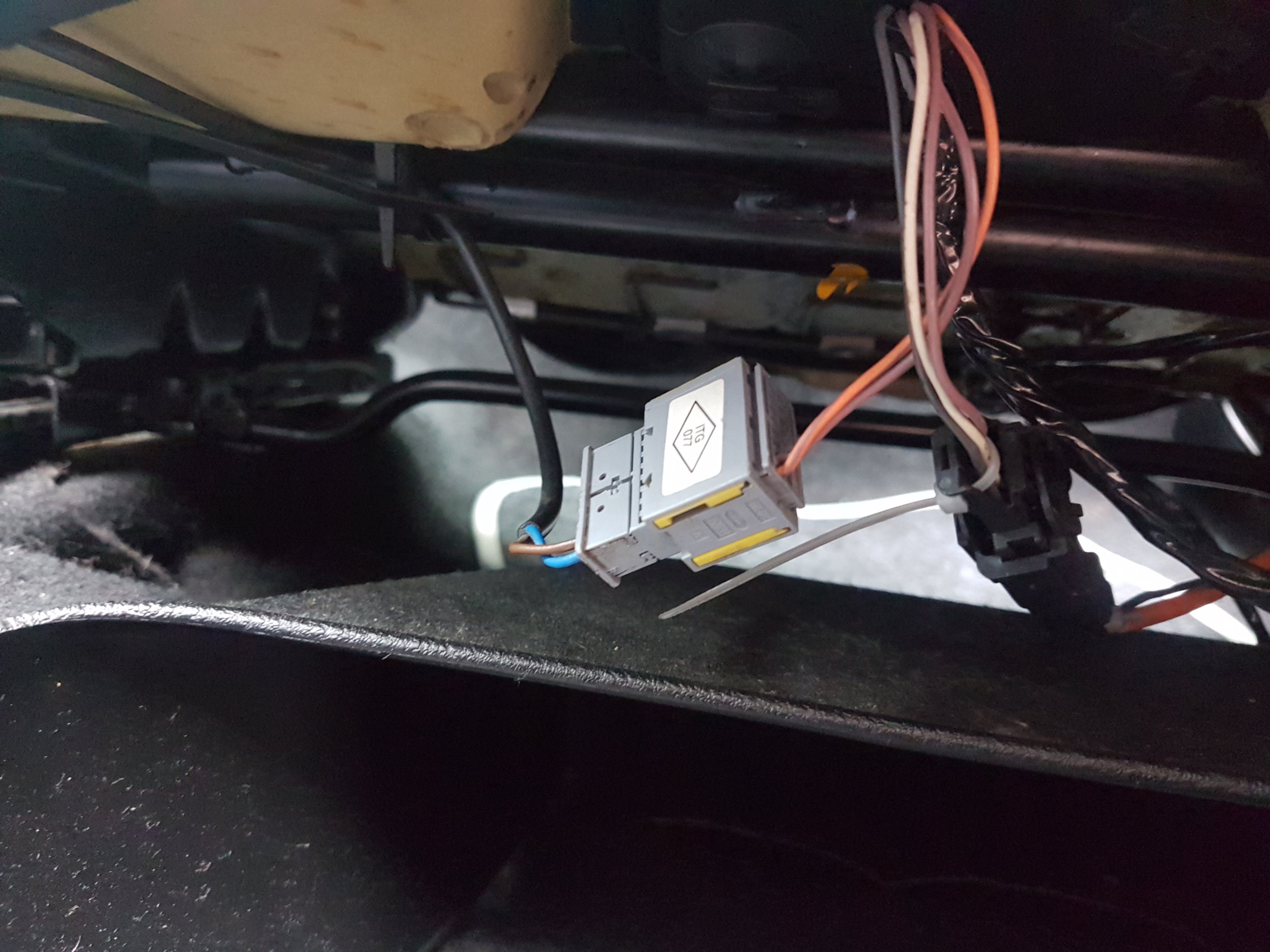

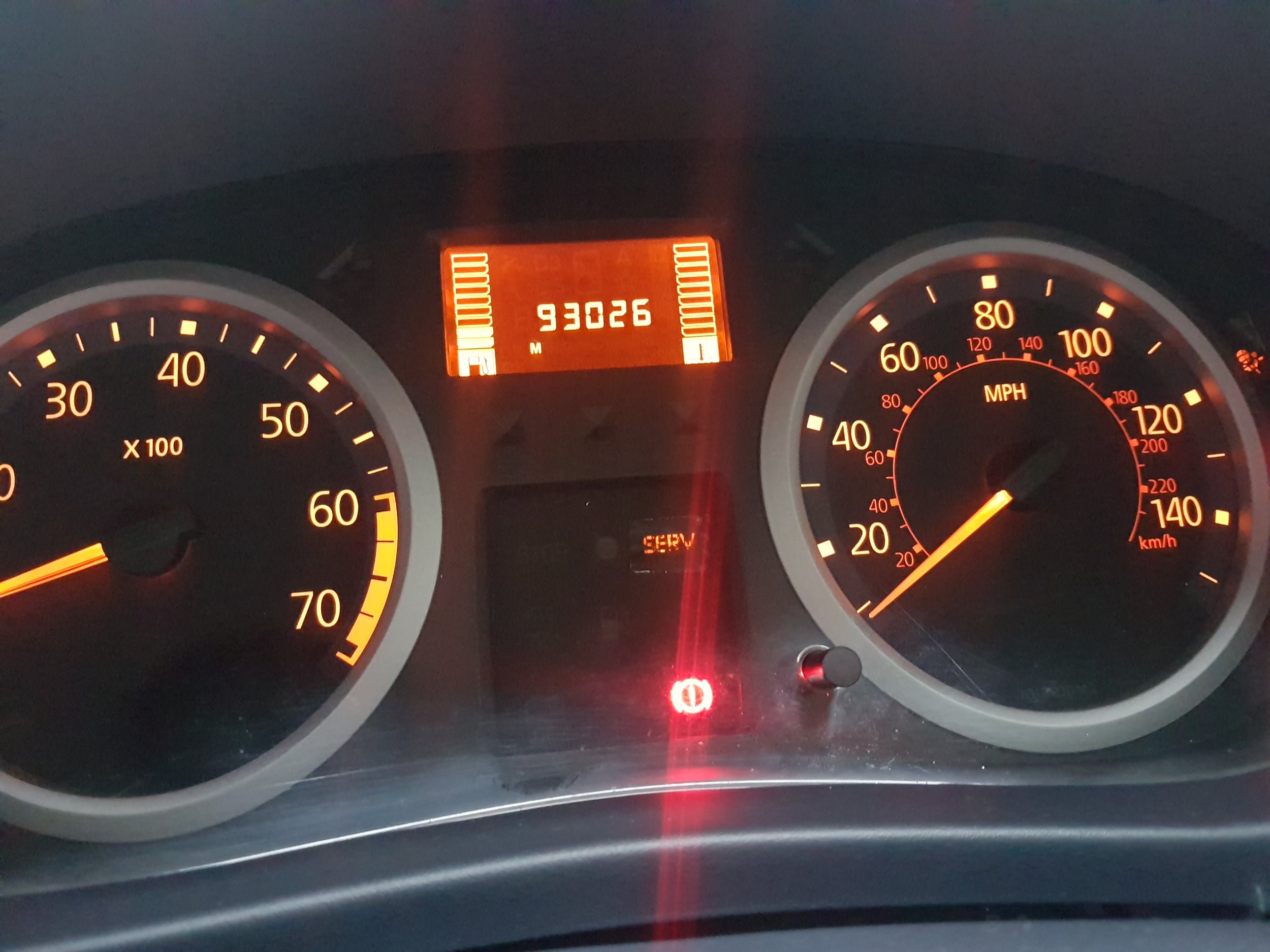

Hi guys i recently brought a clio dynamique 1.2 2005 car, and it drive all good, but the serv and airbag light on the dash always stay on, i tryed moving the wires under the seats but its still stays on, any other ideas how to make them go off
There even black tape to cover up the light serv and airbag

Don't just move the wires under the seat: disconnect them, spray both with contact cleaner, connect and disconnect them several times to get the contacts really clean, the re-connect them firmly and position the socket so it doesn't hang. Do the wires under both the driver and passenger seats.
Thanks for the reply, how do i removed them, do they just pull out or do i have to unscrew anythings, its my first car aswell and i dont wanna make it any worse than it is now
They disconnect by pulling. If your unsure and have an auto electrician local pop it into them.

Im not to sure if its been in a bump or not, but it has a dent on driver side so it might of, but funny thing is on the dash theres black tap over serv and airbag light,
