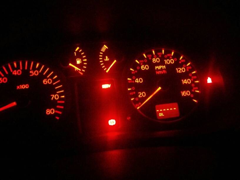

James ClioSport Moderator Car Clio 220 Trophy Oct 15, 2014 #3 The cause is it being low on oil. The cure is to fill it up with some oil. Check your oil mate. If its reading fine on the dipstick, then it could be a dodgy oil level sensor
Reed67 Car BG182 FF Oct 15, 2014 #5 just come on now but will have a look tomorrow morning! got a part number or ebay link to the oil sensor part?
MicKPM ClioSport Trader Car Clio16v/Zoe Z.E.50 Oct 16, 2014 #6 Check your oil level... Don't run before you can crawl and don't drive it until you've checked, this is very important.
R-Sport. ClioSport Club Member Car Mint 1*2's for sale- Oct 16, 2014 #7 Ive had it once where I was parked on a kerb at a steep angle where the oil runs away from the sensor. But either way check oil.
Reed67 Car BG182 FF Oct 16, 2014 #8 ah right will check! i was parked on a kurb side though! thanks guys
D Darius Car Fake Cup Oct 16, 2014 #10 Loz H said: Get some petrol while you're at it Click to expand... If he doesn't soon a little petrol icon will come on in the middle lol
