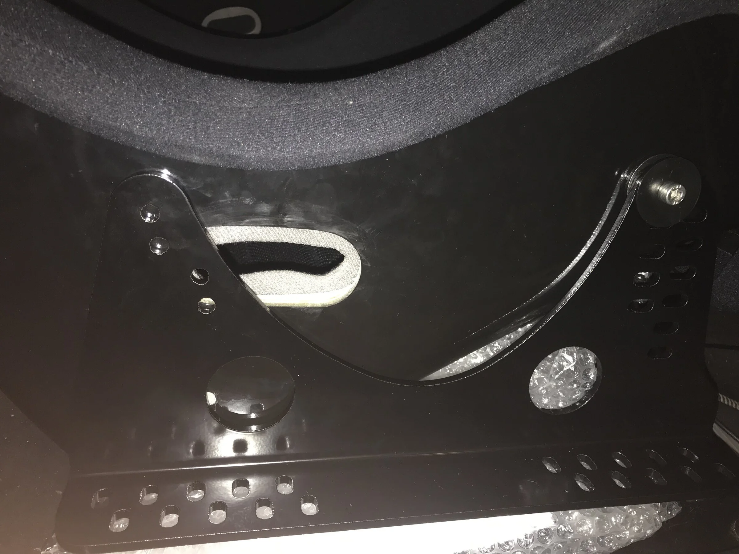

Anyway heres some pictures, this is exaggerated on the angle but I cant do it with one hand, you can see the bolt hole in the seat through the mount, I though about putting something in the thread and putting paint pen marker on the end so when I angle the seat it draws the line of the hole..

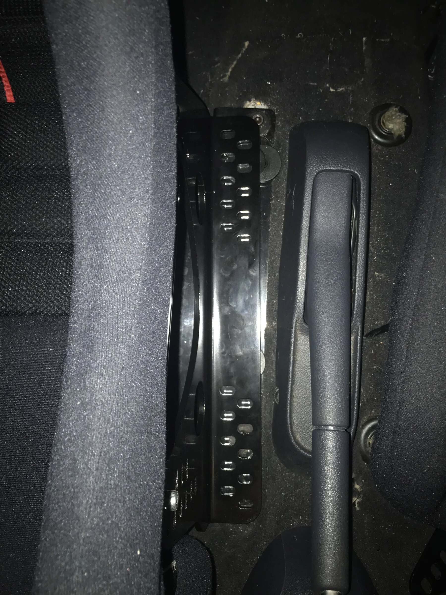

And the angle of the mounts, this is on both sides. There is enough space under this side to bolt it like this which is good, its just the subframe will have to come out to bolt the seat down. If they were captive nuts underneath then this design would make for a much easier time bolting the seat down.
And this is what the seat kinda looks like, the red is a spacer I had to put in to originally clear the mount from the side harness plastics, ive taken them out anyway as when I sit in the seat there would be no give so I was clamped in by the plastic. Also one of the threads I think its the rears, bolts in at a funny angle and theres a gap between the bolt and the mount. Really bad design....

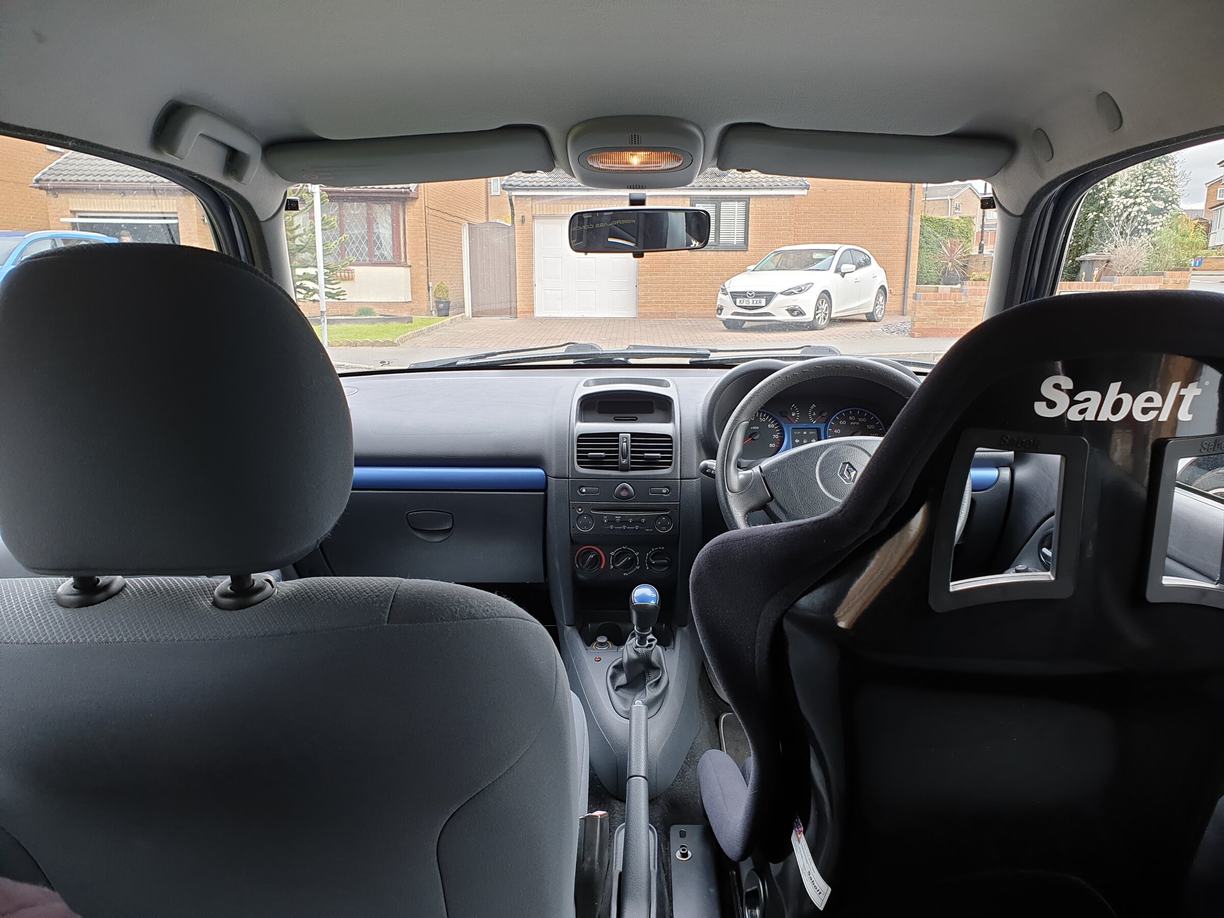

I've got a Sabelt GT3 seat in Large which think is just older version of Taurus/Titan with Jon Foz xlow subframe and low Sabelt side mounts (no runners). I built up seat, side mounts and subframe out of the car (at furthest point back without elongation of any holes on subframe) and then bolted subframe down last, after taking spacers out.
I'd still like to move seat back a touch more but happy for now until next time under the car might take it back. I've got seat back very near vertical too, can unbolt seat in situ as have done to change angle but its very tight.
In terms of offset it is slightly right as shown in picture but that's butted up left as far as can on xlow subframe. I think from memory side mounts at rear were pinched in as bolted to seat, might be more noticeable if you've got taller side mounts?

@jp_lcr See part of me doesnt like the idea of the mounts folding in to the seat, although someone might be able to answer to that.
Im going to have to drill new holes regardless so I can have them crooked like that but it doesnt look great.
Ive got the bolt holes for the mounts covered now. Will just need to get the seat bolted up at the right angle then measure where the subframe needs drilling, well also how Im going to space the mount on the right, alloy box section?
