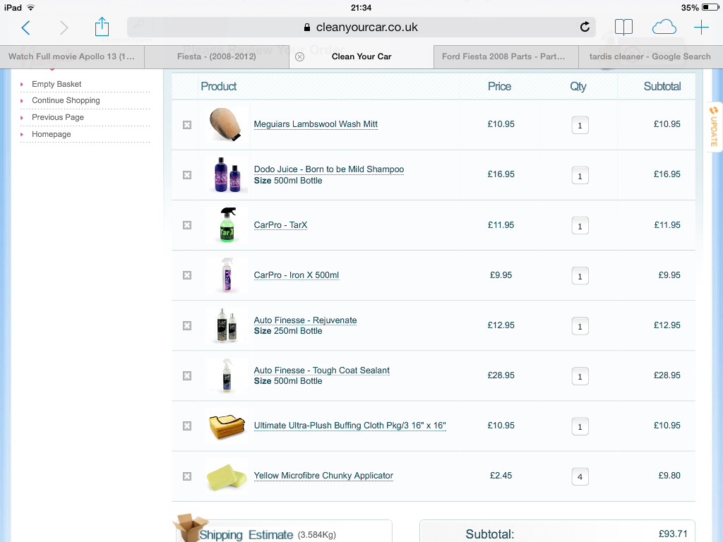

Here's my shopping basket
Quite easy to run up a bill! All seem correct?
Does the tough coat work on the glass too?

That sound about right? Drying after final rinse or every rinse before next product?

Don't use it on he front glass but will be fine on the rest
Process seems fine, once a year I'd still clay after de iron and de tarring
