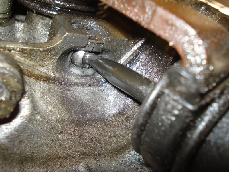

What and where actually is this?
Have been told that mine had the pin fitted along with the shortshifter but want to put the standard pin back in as its apparently better for the gearbox.

follow the gear linkage to the gearbox and where the mechanism is on the box its just there u should see it theres a little cirplip underneath it holding it inplace

As someone said follow the gear linkage to the gearbox and the part that connects the linkage to the gearbox itself is the "clutch pin". Makes a nice difference in shortening the throw imo, and makes it a little bit more precise.

its up on the box sealed in with a plastic cup and circlip, get the clip out and pull down. Open the plastic thing up and pull the pin out and then un hook it. Swap over then reverse. Make sure you fill the rubber thing back up with grease

You have to drop the exhuast from the cat and its an all under car job. If you have a ramp its easy. will take an hour tops. Hardest bit is cutting the old gear knob off!
  Ph1
Is this what your meaning?
