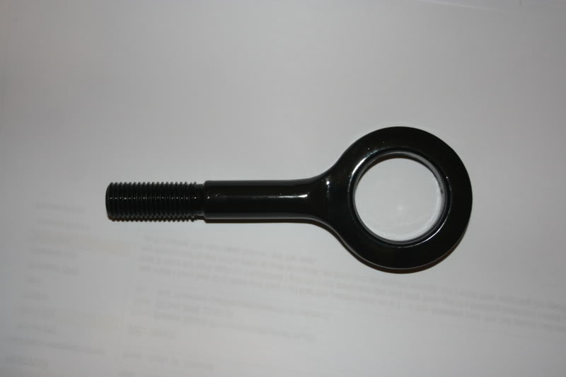

Nafoff ClioSport Club Member Car GREEN ITB 172 Jan 16, 2009 #20 mine shortened... this was measured up, then cut down, then re-threaded and painted
