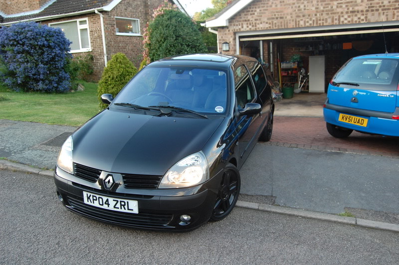

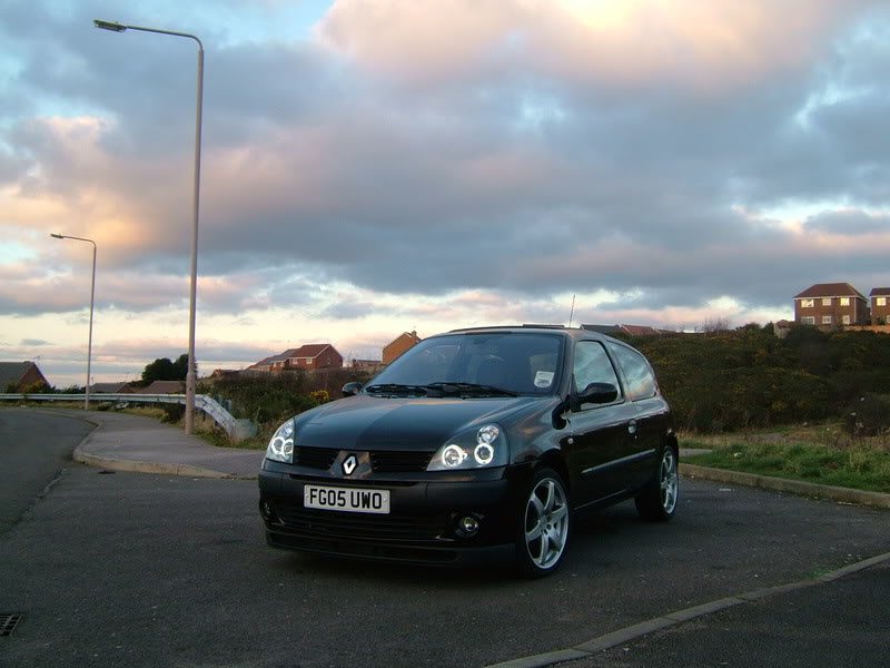

  Megane DCi 147bhp/350nwm
What car:
When did you do it:
What did you use:
How long did it take you:
Before and afters as well please :)
Don't just post a picture of your car that you "jet washed" either. I mean serious detailing :D

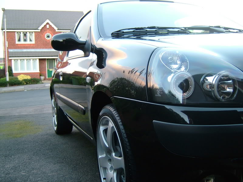

  106 GTi

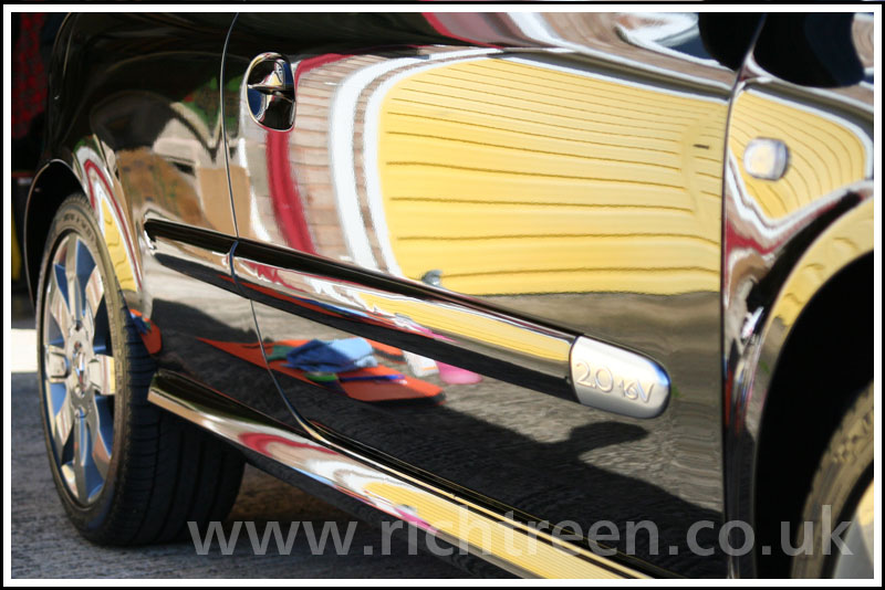

M3 CSL 9 odd hours each (x2 of us)
http://www.richtreen.co.uk/images/m3csl/
Process used here - http://www.cliosport.net/forum/showthread.php?t=142311

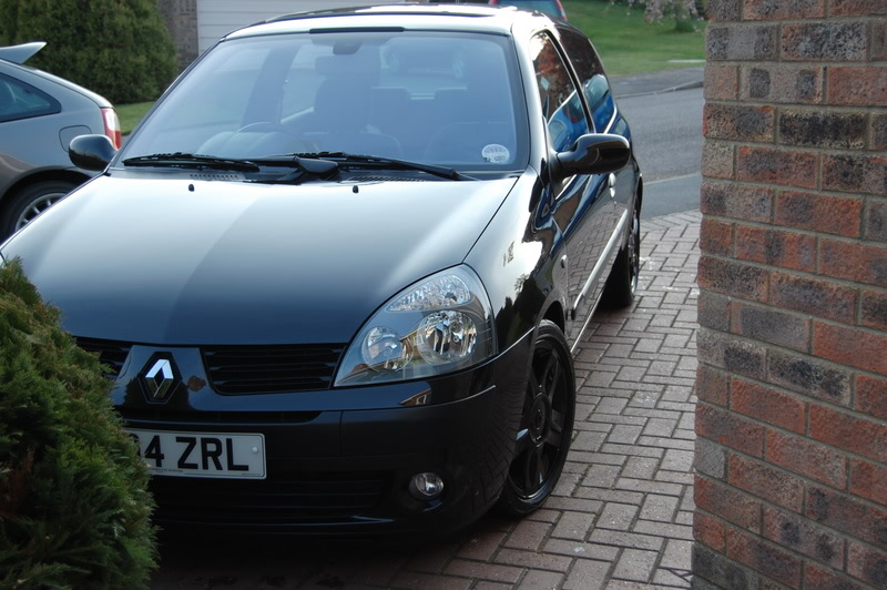

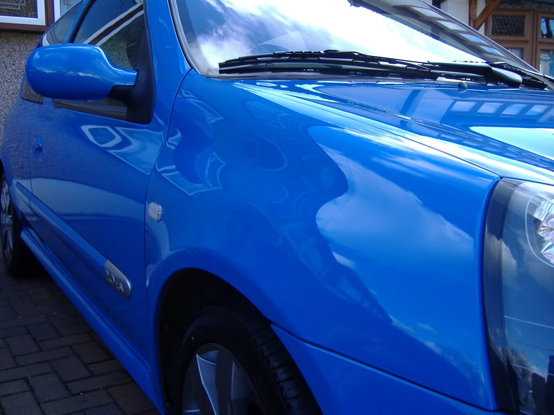

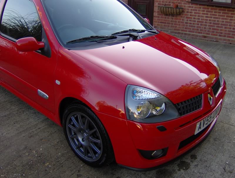

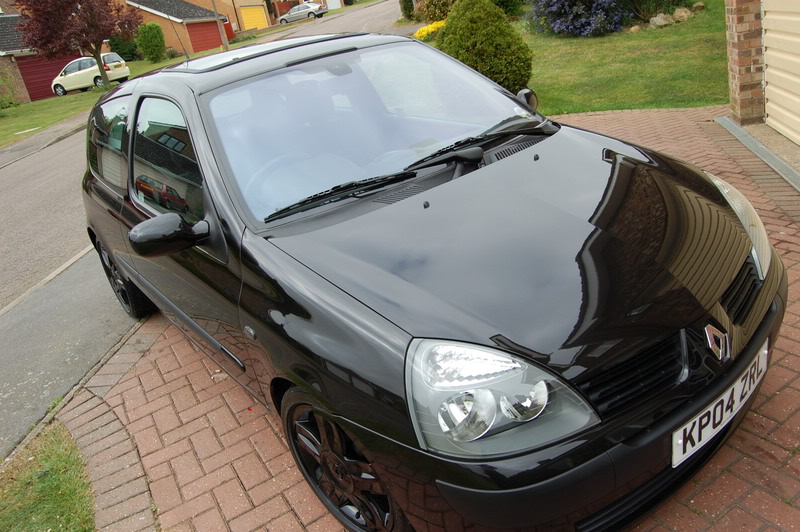

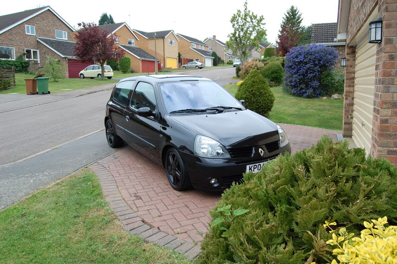

My 182 - Over a few days on and off:
Full Process here:
http://www.cliosport.net/forum/showthread.php?t=209380

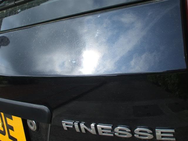

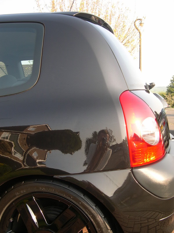

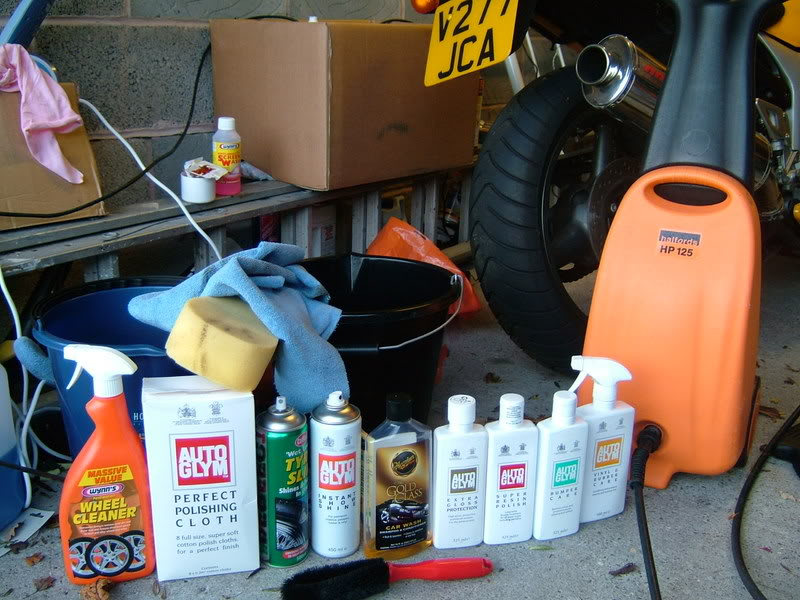

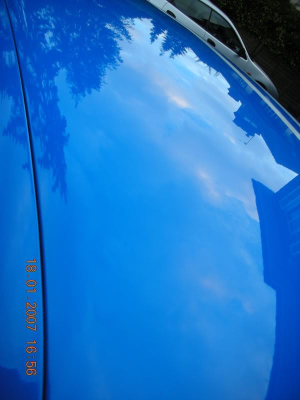

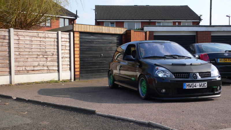

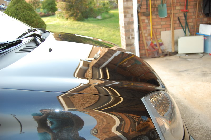

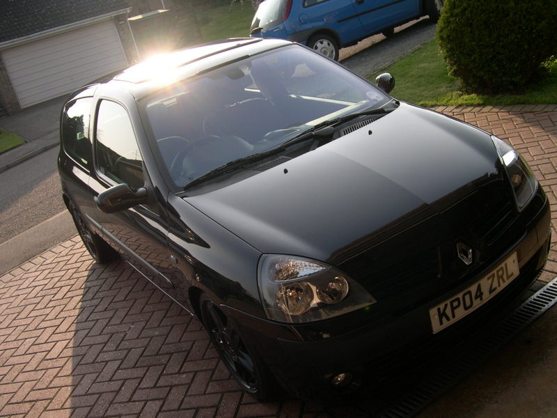

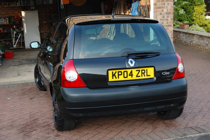

car; mine
process; 2 bucket, megs clay, 2 bucket, megs QD, AG aquablade, sonus der wunder towel, scratch x, megs 83 by PC on cut pad, megs 80 by PC on medium pad, srp by PC on final pad, egp x6, p21s, fast glass, tyre foamer, megs hot wheels, srp and egp on wheels after engine and machine cleaner and claying, ag vinyl and rubber care, ag bumper care. erm . . .
time; 3 days on and off, mainly night.

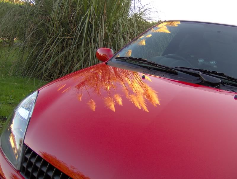

over xmas 06-07
  A slow one :-(

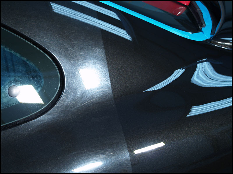

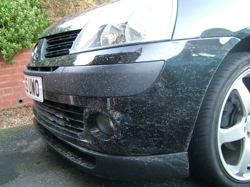

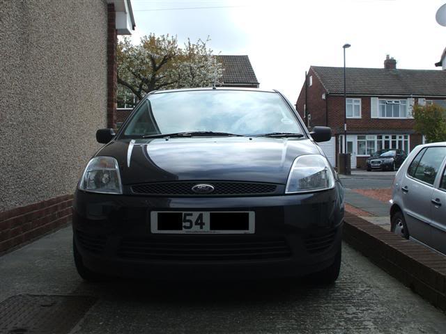

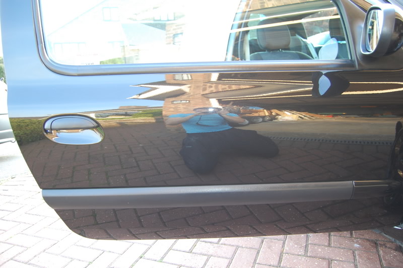

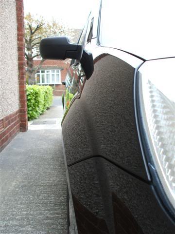

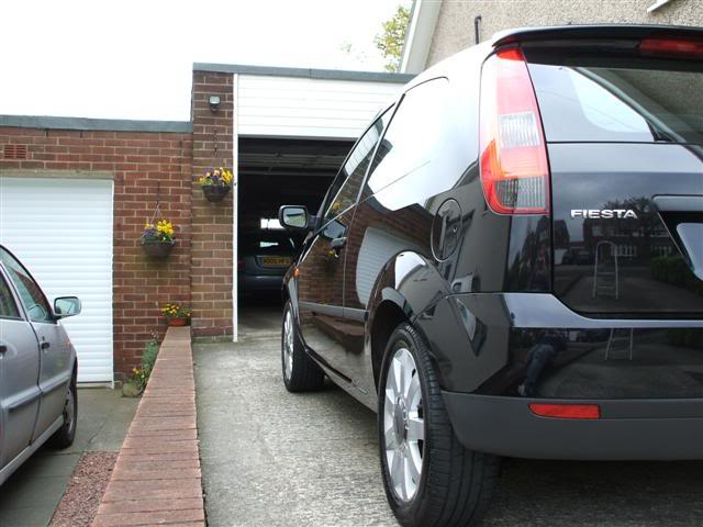

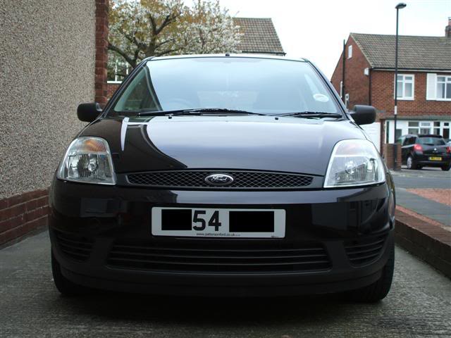

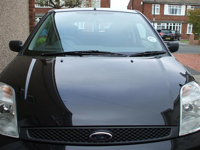

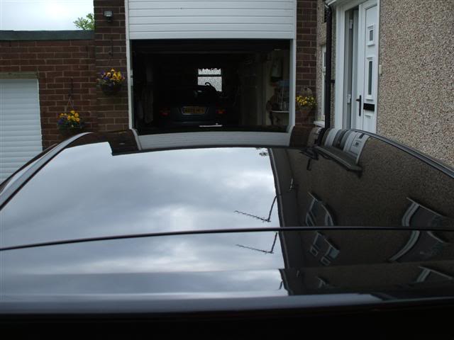

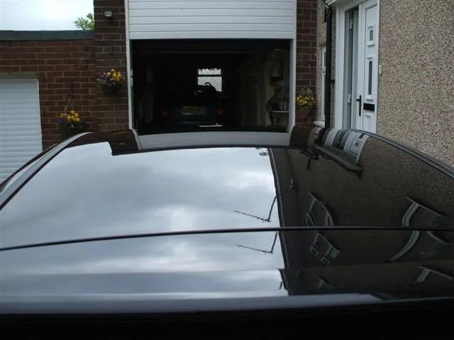

Here is mine. Althought it is not a Clio I think this has been my best detail to date!

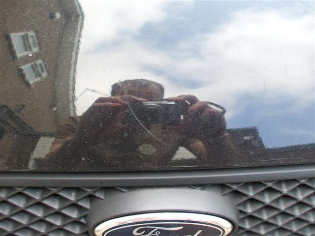

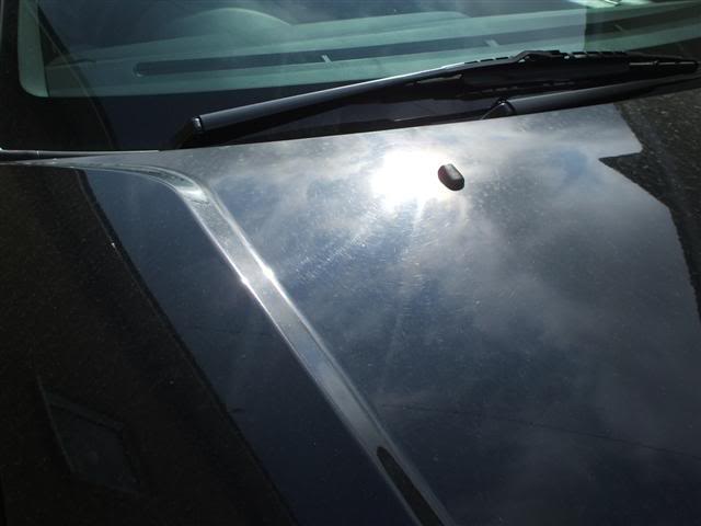

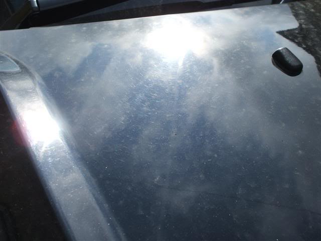

It was covered in swirls as it is washed with a brush thing :mad: It hadn't been cleaned in about a month but tbh its only covered 12k miles in 2 years so its not too bad I guess :confused:
So order of the day was:
Pre rinse with my hosecoil and Duragloss Shampoo,
Washed with 2 bucket method, again Duragloss Shampoo,
PC'd with a yellow Sonus SFX pad and PBs SSR2... this was the first combo I used. It removed the vast majority of the swirls, leaving only behind the deeper scratches. I was happy with this as I just wanted to get rid of the swirls and bring back some depth to the paint work.
Finished with Klasse AIO and Serious Performance Sealant.
Before Photos:
My attempt at a 50/50 shot:
Didn't really come out too well...
Afters shots... the weather was **** up in Newcastle when I did it so afters a bit poor. . Still happy with the end results:

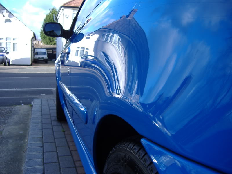

  phase 1 172

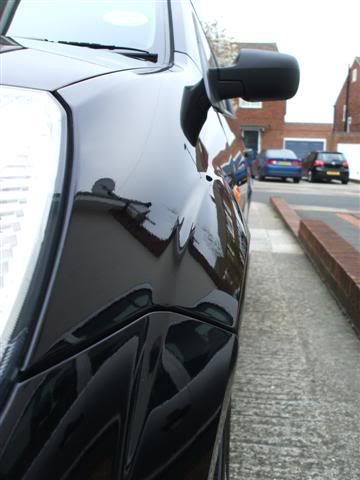

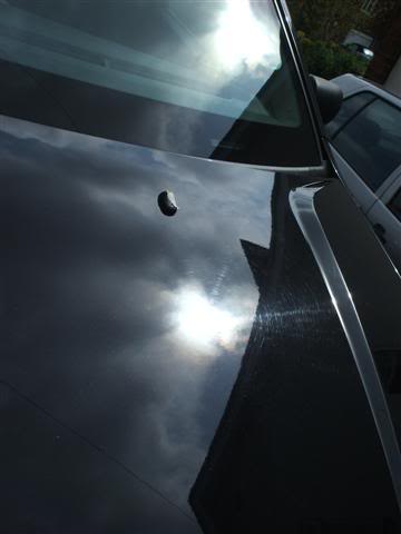

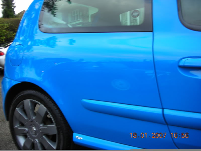

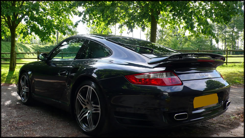

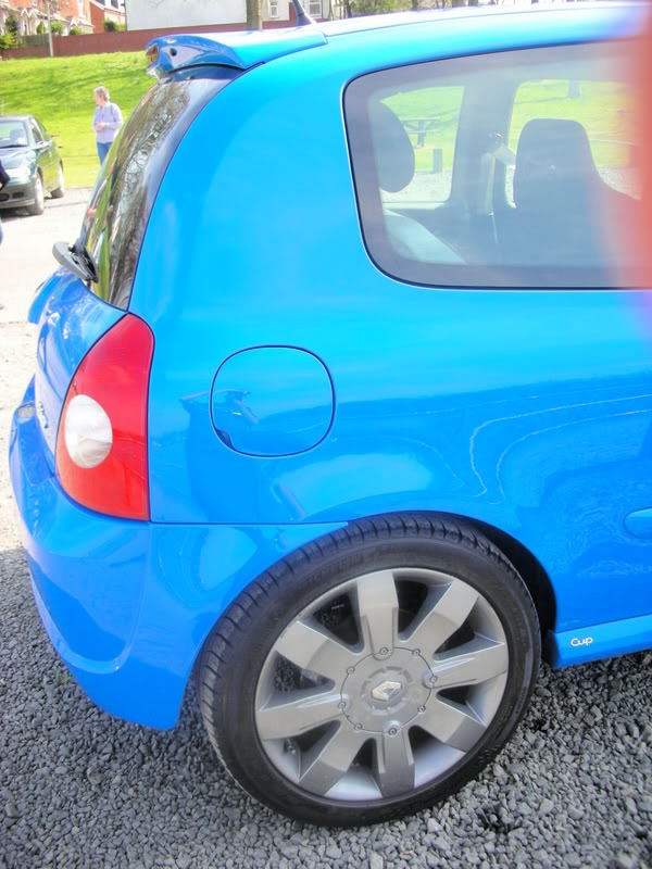

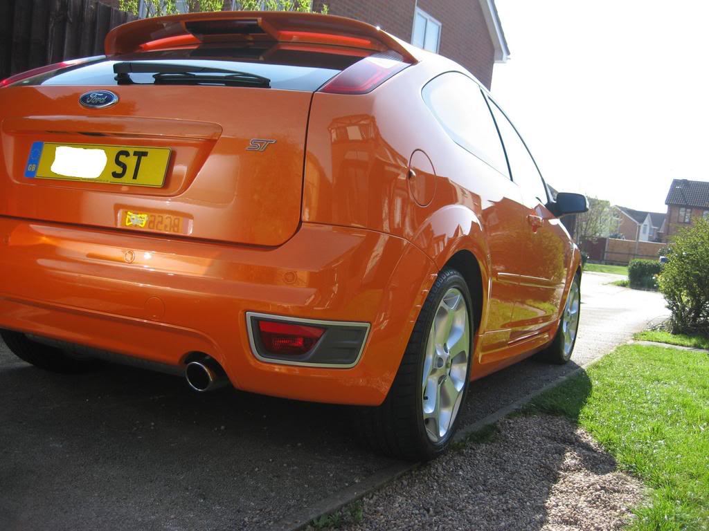

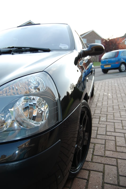

These pics from a while ago, decided to give Meguiars 3 step ago as i had them and had the time.
Started early, finished as the sun was starting to go down
Got to be one of the best 50:50's in a long time Tim. Put that paint on a clio mind and it becomes rock hard ;)
