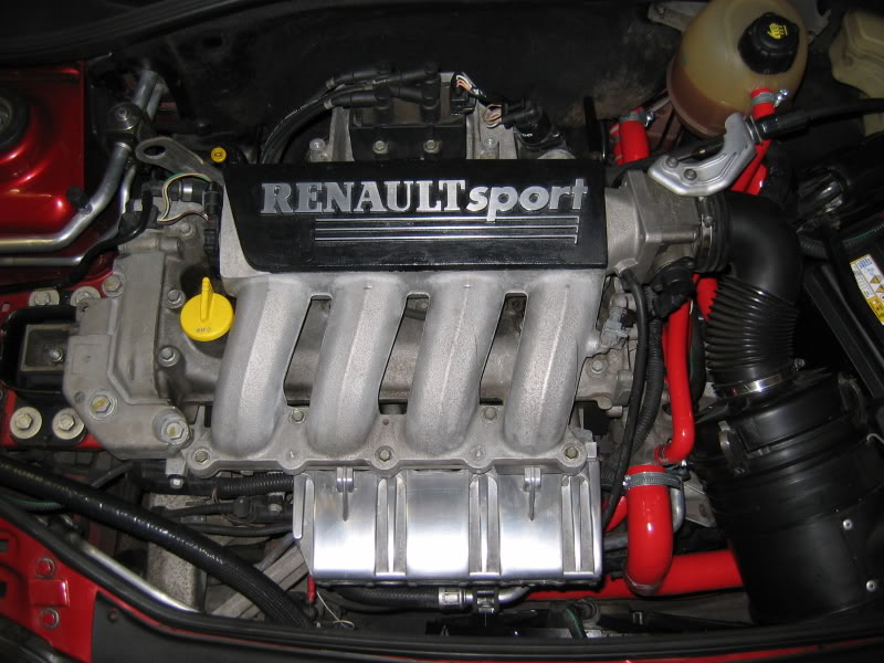

I got my sfs hoses from the group buy not long ago in the for sale section. Youll need to buy a whole bunch of jubilee clips as they are not included.
mikalor (sp?) clips should be used as they have a smooth inner to prevent tears in the hose
Your right mikalor clips are better to use, theres not much chance of them tearing a silicone hose but as they are more perfectly round and apply the same amount of tightness all round the outside of the hose, they perform a better more reliable seal. Where jubilee clips are not perfectly round, especially if you use ones that are too big for the job.
