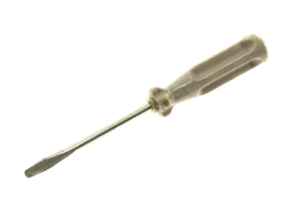

Always use one of these and of course a hammer,changed the missus yesterday,seriously though if the oil was as bad as you say i would change the filter asap as they are not very big anyway and is probably full of gunk,and could constrict the flow of oil ;)

If the oil hasn't been changed since 'Nam, I guess the filter has welded itself on anyway. Hammer, big screwdriver or an old chisel .. bish bash bosh, you're away :)

Actually the oil filters ARE a b**ch on 182's. Mine certainly was, I used a chain strap and couldn't get it off - even with the fuel rail guard off. In the end I had to smash right through it with a screwdriver, not just pierce it, and turn it a little bit at a time. So no need to get shirty ;)
