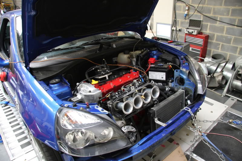

The one you want isn't from a polo, the outlets are in the wrong place on that. I can never remember which one it is though.....always have to look it up in the catalog
Oooh that's properly tiny!
The polo one I've seen seems to come across closer to the alternator

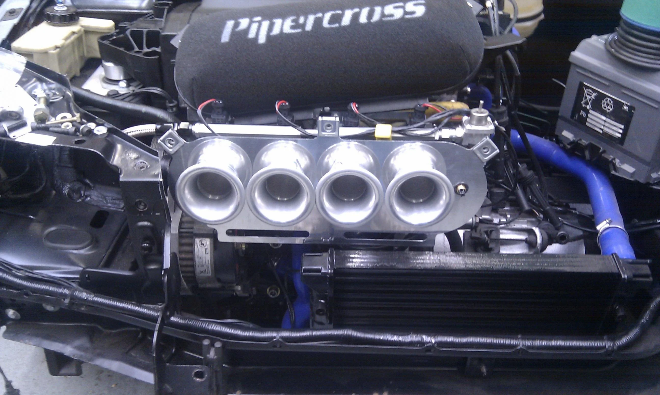

Is that on jenveys? I'm trying to shorten the radiator so I can run an airbox on the bodies
The diagram for the polo radiator has the outlets in roughly the right place but the bottom one comes straight out of the rad rather than angling upwards - so the water pipe would be slightly bent
If theres any chance you could find out which one you used in that pic - that would be awesome!
  DON'T SEND ME PM'S!!
thats a mk1. Closer pic than the one I have in a mk2, but same rad
Tony and Jay run a rad which is a bit wider. Another VAG model i believe
