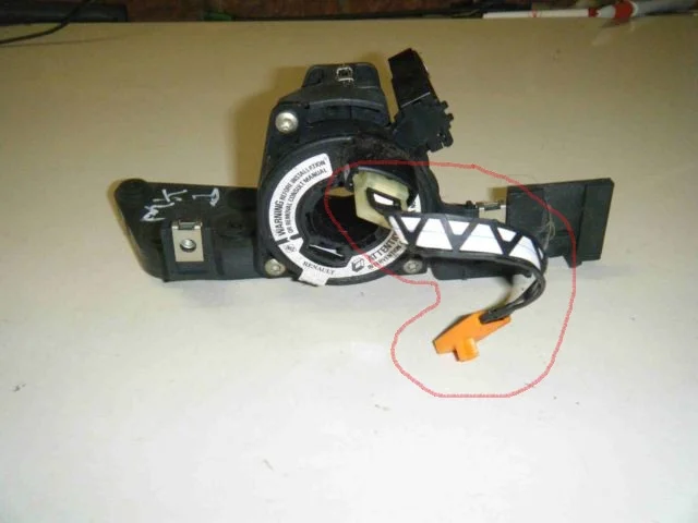

What's a squib?
This if Im not mistaken ;)
  Mk2 Ph2 172
No it's the whole thing not just what You have sort of circled lol
Get one from someone who is breaking a car, if its in good condition they are plug and play.... It's just the steering angle sensor that is clip to the front of it that isn't plug and play so you will have to use your original sensor !!!
