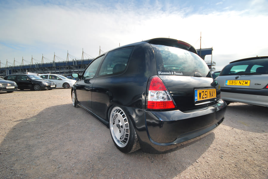

how much work is involved? i want to keep the number plate bit but get rid of the grab handle, anybody got any pictures?
