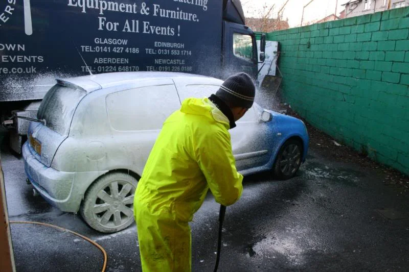

Basically you need a pressure washer and a foam lance like this:
http://www.cleanyourcar.co.uk/washing-and-drying/foam-lance-various-fittings/prod_371.html
Then you put a bit of snowfoam in the bottle, fill it up with warm water and away you go :)
The idea is that it loosens/get rids of as much dirt as possible off the car which means that when you start to clean by hand, you're rubbing less dirt into the paint (reducing the chance of swirls and scratches). It also makes the car a lot easier to clean.

I found that I did, mostly on the lower extremes but mainly because the car was SO hanging before .. but if it was nicely cleaned/sealed/waxed before - the foam should keep on top of things once a week I would hope !

Snowfoaming is awesome and leaves the rest of the cleaning easier. I nearly always snowfoam before i wash these days as well...

I wouldnt touch my car with a mitt if it hadnt been pre washed b4 hand.
I use 3 quarters of an inch of foam and half inch of tfr, warm water. gets all the crap off a treat.
A good investment if u wana keep ur motor lookin well. ;)
