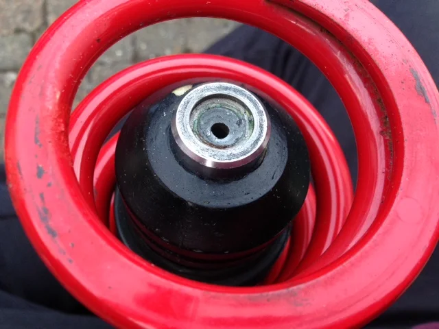

OK, hands-up, I was very stupid and I blame nobody but myself.

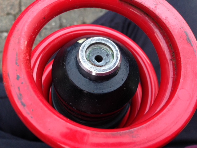

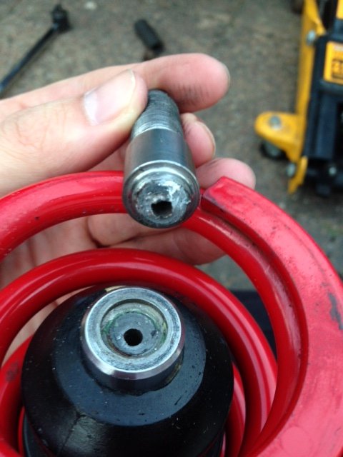

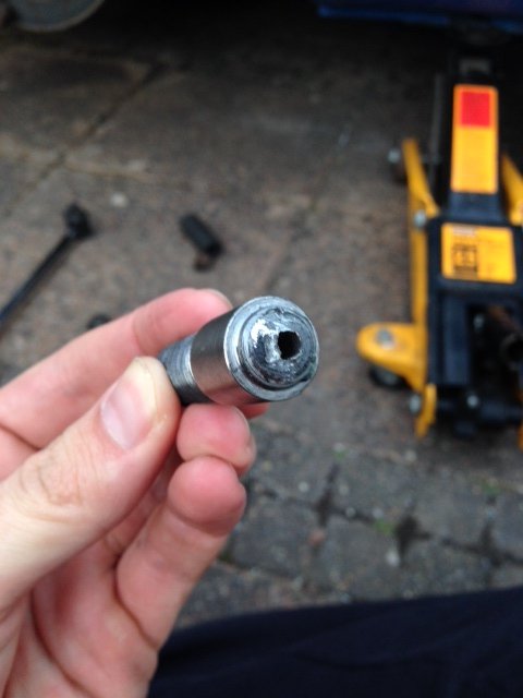

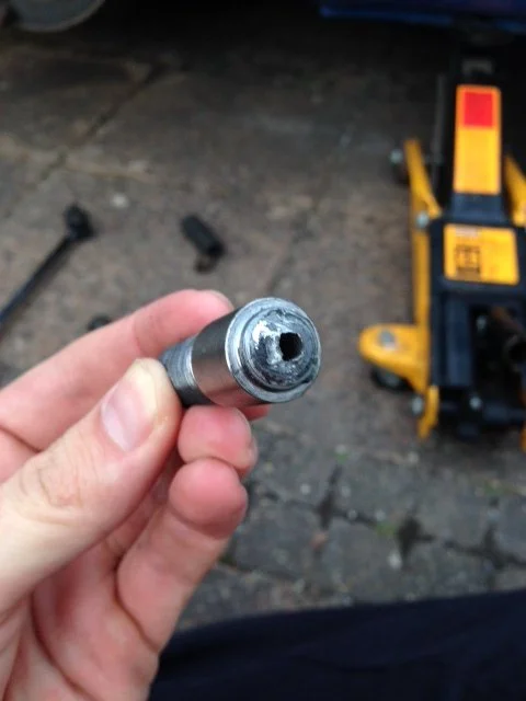

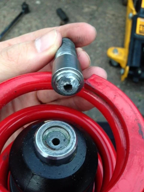

Long story short, I used to have a GAZ GHA setup with KTec solid top mounts; I sold my old GAZ coilovers and must have sent off the solid top mount spacer with the old shocks to the new owner. In my haste, I lined the new Spax RSX up with the solid top mount, which I now realise I placed right onto the bearing, i.e. top collet right onto the bearing on the top mount, and tightened everything up from the top. Span the car around on my drive after fitting and heard a rather large crunch...
I snapped the top of the shaft clean off on the passenger side and bent the drivers side. They're now off the car and my Cup is sitting on the drive on axel stands. Nightmare situation!

As promised...

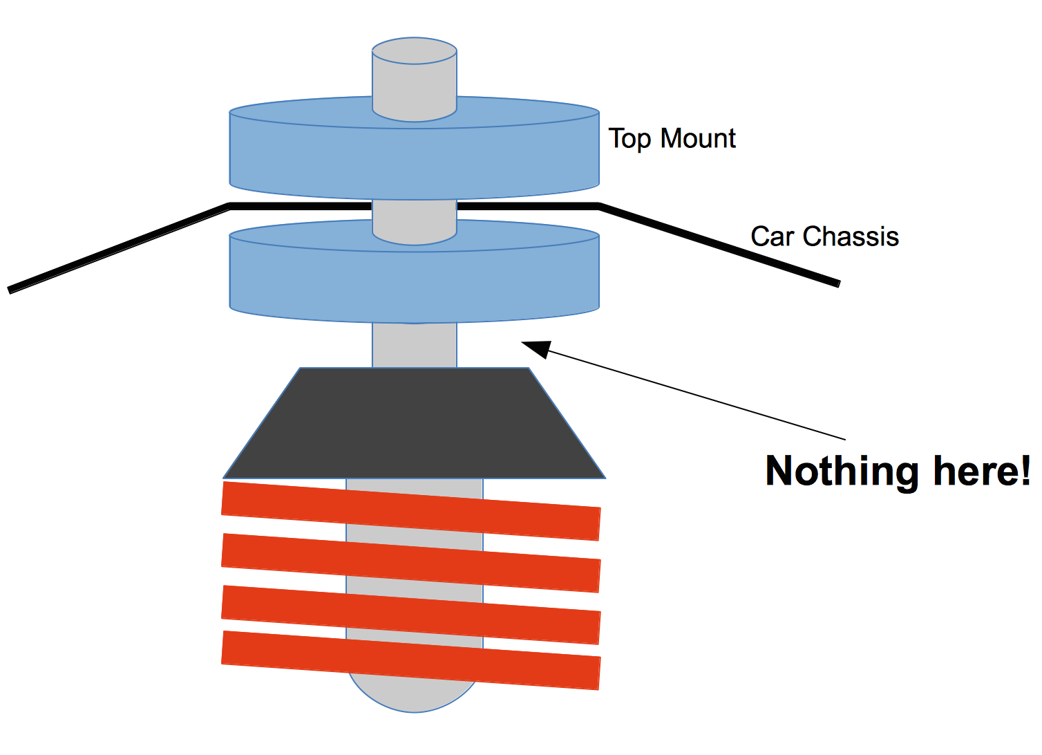

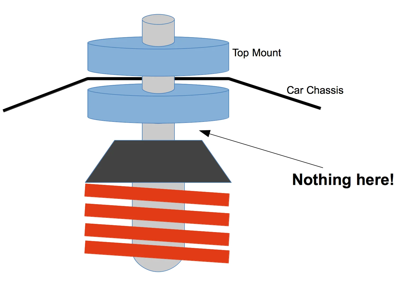

NorthloopCup - as requested, see rudimentary picture below. The photos above do not show the top collet which holds the spring in. I need to find out whether I'm missing a part in the configuration below. What must have happened is that the top collet (or whatever holds the top of the spring) wasn't fixed into position and didn't have anything to attach into, as a result it was able to slip around. The problem then is when the strut slides, it shears off the top mount.
