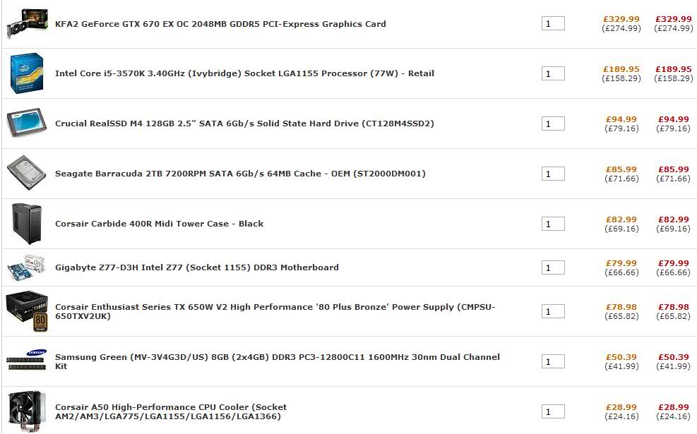

I am getting properly itchy trigger fingers where buying PC components is concerned. Think I need to upgrade now.
List of my kit as follows:
CPU: Q6600 (Bought Feb 2008)
Mobo: Gigabyte P35-DS3L (Same date)
Graphics: GTX275 896mb (August 2009)
RAM: Corsair TwinX 4gb (January 2011 - I struggled with 2Gb for a long time :o)
Case: Lian-Li PC7A (Feb 2007)
PSU: Corsair HX 520W (Same)
HDDs: Mix of Samsung, Seagate and Maxtor drives. Total of around 2TB over 4 drives, I think (Various bought dates).
As you can see, all quite old. Thing is, plays even the latest stuff at a fairly decent rate (with fairly decent prettyness).
If I haven't listed it, doesn't need to be replaced (Monitor is a 24" Dell, which I still <3).
Budget of around 800-900 quid. Could go higher, will wait and see. Case may not need to be replaced, wasn't sure if anything new had happened as far as location of PSU or whatever goes. Imagine the PSU won't have enough power to support something like a GTX670 (or whatever). I want/need an SSD, as well as maybe a few new 2TB drives.
So, what do people suggest I get? :)

Just put the order through :o Changed a few bits and pieces. Should arrive on Tuesday.
Item Qty Price
Gigabyte GeForce GTX 670 Windforce 3X 2048MB GDDR5 PCI-Express Graphics Card 1 £266.66
Intel Core i5-3570K 3.40GHz (Ivybridge) Socket LGA1155 Processor (77W) - Retail 1 £144.99
Samsung 128GB SSD 830 Desktop Series SATA 6Gb/s KIT with Norton Ghost - (MZ-7PC128D/EU) 1 £71.66
Seagate Barracuda 2TB 7200RPM SATA 6Gb/s 64MB Cache - OEM (ST2000DM001) 1 £71.66
Corsair Enthusiast Series TX650M High Performance 650W '80 Plus Bronze' Modular Power Supply (CP-9020002-UK) 1 £70.82
Corsair Carbide 400R Midi Tower Case - Black 1 £69.16
Gigabyte Z77-D3H Intel Z77 (Socket 1155) DDR3 Motherboard 1 £66.66
Samsung Green (MV-3V4G3D/US) 8GB (2x4GB) DDR3 PC3-12800C11 1600MHz 30nm Dual Channel Kit 1 £41.99
Alpenföhn Matterhorn Pure Edition CPU Cooler (Socket LGA2011/1366/1155/1156/775/ AMD AM3/AM3+/AM2/AM2+/FM1) 1 £22.49
OcUK 22x DVD±RW SATA ReWriter (Black) - OEM 1 £13.32
Sub Total: £839.41
FREE SHIPPING (DPD Next Day) Shipping: £0.00
Total Vat: £167.88
Total inc Vat: £1007.29
Seems like a nice balanced system. Not exactly the pinnacle, but sweet enough to get great performance in most games.
