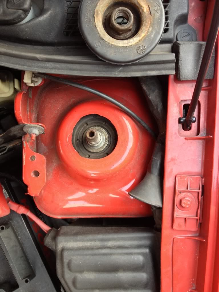

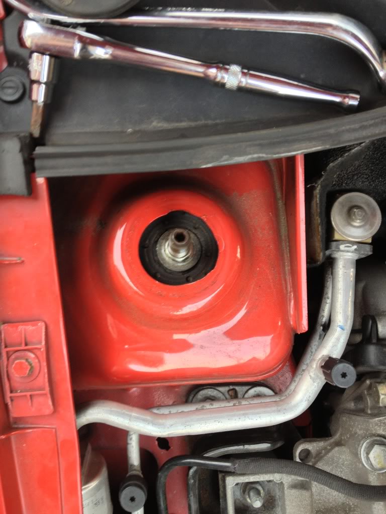

So I'm looking at getting the pure motorsport top mount and strut brace package, but I'm concerned that I won't be able to fit them correctly because my suspension turrets have been modified (by Renault I believe?)
here are some photos of what I mean..
could anyone help advise me whether they will fit?

See how the top bit isn't smooth? I believe Renault used to do that as a fix for top mount knocking.

I think you're right to worry. The top pic looks like there isn't enough metal to drill the holes. With mine which were a snug fit there was only a few mm to spare on drilling the holes.

The holes in my turrets were fucked. They had worn into ovals and were a lot worse than the OP's.
I will say though that I wouldn't bother getting the strut brace as the holes in the turret need to be in a specific place for it to fit, and you may need to move the mounts around a bit to get the holes in a good place.

That's my issue. I think they would fit by turning them but I wanted to fit the strut brace

The ones that bolt to the turrets don't actually do anything but supposedly the pms ones do. I did consider cutting it flush and welding a plate on then making a new hole in it but then it would need painting too and could look a mess!
