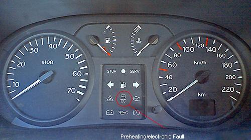

Solution/answer = preheating/electronic warning light
Car  53 Clio 172
This warning light came on and the engine went into LIMP MODE where it wouldn't let me rev above 3000rpm. I have taken this to renault and the problem was a throttle potentiometer. I had no idea what this was so thought i would post up just incse anybody else had this problem/fault.
Hope this helps somebody out.

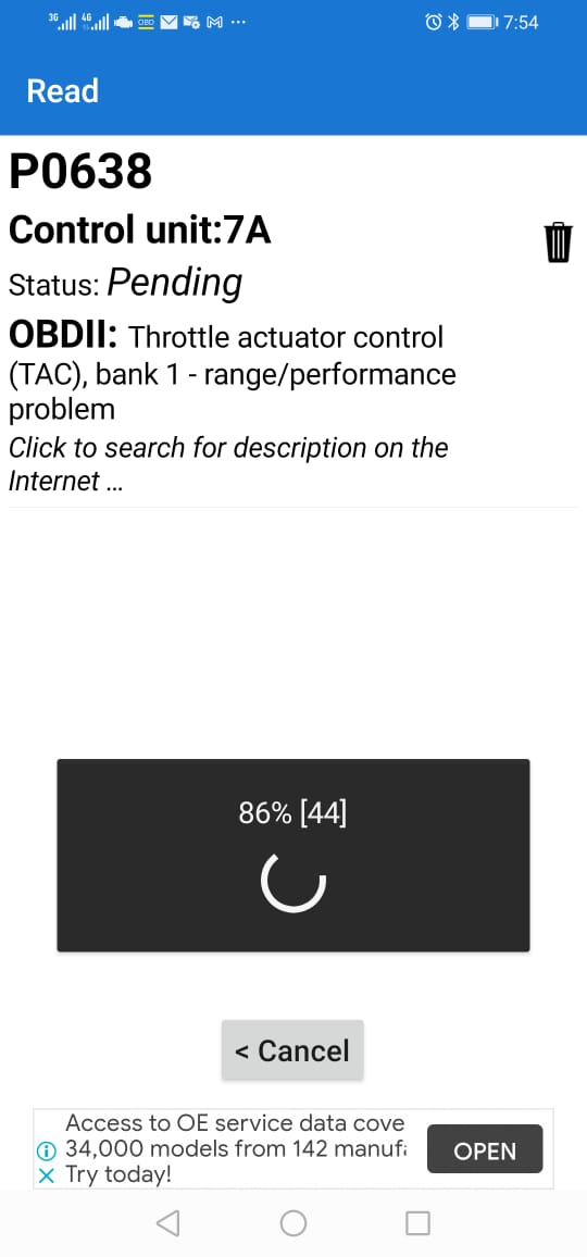

same problem on 1.2 16alve clio thought this might help or if somebody has found sulotion for it
