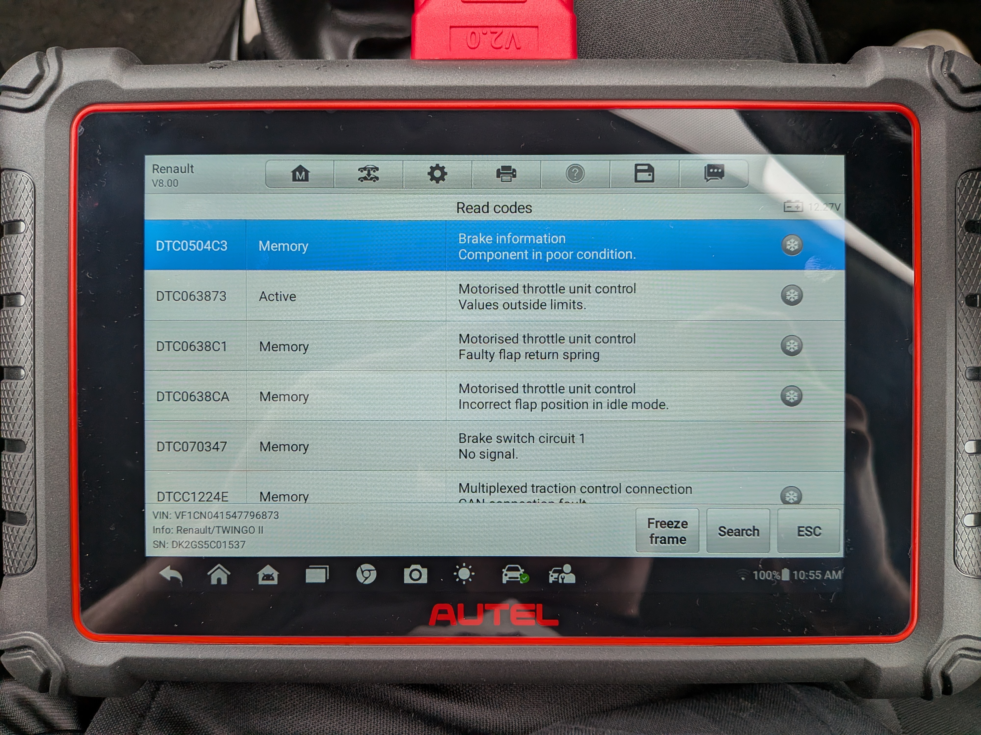

Pouring with rain today but i did get some diagnostic time inside the car! (not under the bonnet!)
Im getting an active code that wont clear for Motorised throttle unit control values outside limits. and i can see some historic codes that have cleared and not returned after a few cycles and miles.
When the fault returns i can see the throttle body is sitting at 46% throttle where the pedal is only requesting 14%.
I am now wondering if i have by chance replaced the faulty throttle body with another faulty one! the replacement looked in very good condition and felt butter smooth where the original was horrible through its motion, but possibly it has an electrical issue. Next dry day i will inspect the connector and wiring onto the TB
The saga continues!
Martin_172
The plot thickens.
  • original throttle body was sticky and clicking thru its motion - replaced it and binned it
  • the replacement felt nice, but now seems it doesnt want to auto close (sticking at 46% and causing a high revving, when it does finally close it stays slightly open causing a 1500rpm idle - the original had this high idle too)
  • just fitted the one from my 1.2 16v clio, now it actually has an issue where it randomly starts struggling to run and cuts out low down in the revs that ive not been able to cure................ - Well it causes the twingo to do this too!!!!
IVE GOT 3 FAUTLY THROTTLE BODYS! no wonder im banging my head against the wall stumped
