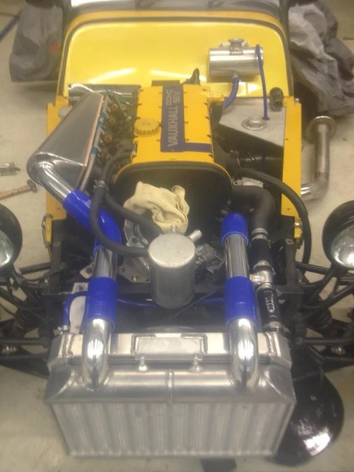

I'm about to use omex for the first time next week on a kit car with a c20let also with itbs , I'm used to link haltech and apexi
