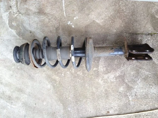

and then i see something sitting perched on the lower spring mount on the strut...
God knows when that broke off, or how it managed to stay sat in there, or how the broken spring jumped into place itself with no obvious handling or ride-height issues. It might even have been in there during the MOT 6 months ago!
So maybe time for 2 new driveshafts and some sportlines ;)

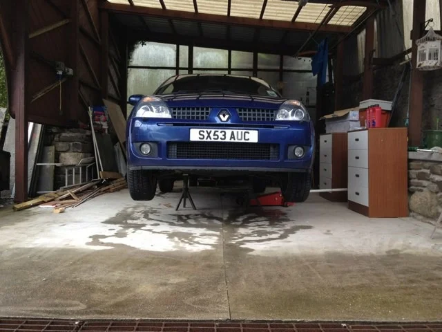

Replaced both driveshafts this week with Renault refurbished-exchange ones.
My sportlines arrived from Chris205 too so I got them on while I was at it.

Jacked up.

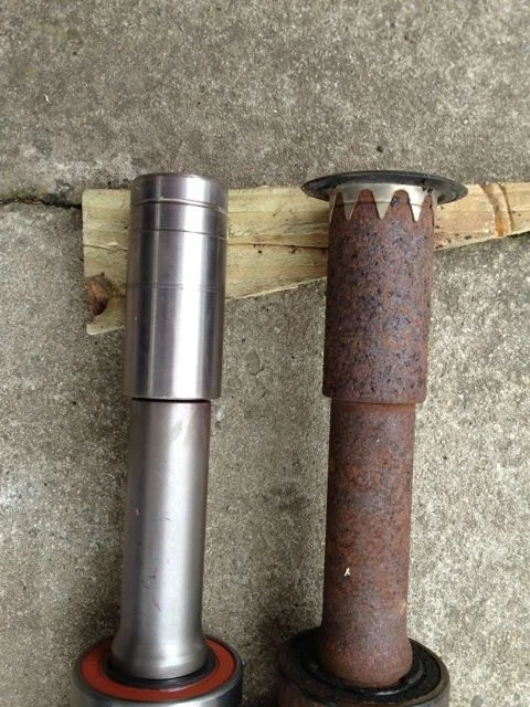

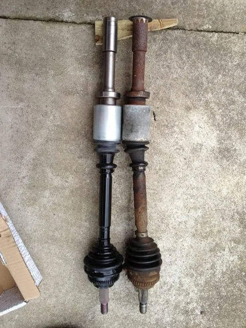

Old and new o/s shaft.
Dust seal to be swapped over.

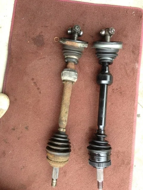

Old and new n/s shaft.
Old shocks off ready for sportlining.

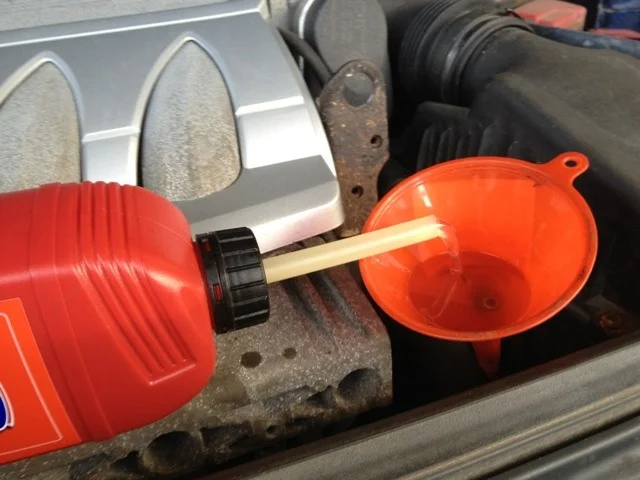

Refilling gearbox oil. Got a mouthfull of this stuff when peeling off the lid. it does not taste good.

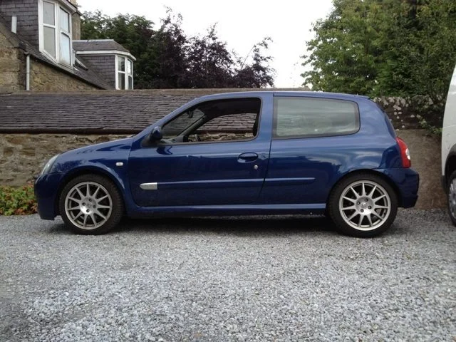

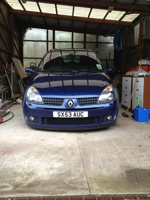

'nose down' stance ;)
Ride height with sportlines on. Very little difference to standard right now but might settle out over the next week. I'll take some more measurements then to compare before/after. Certainly rides the potholes much better!

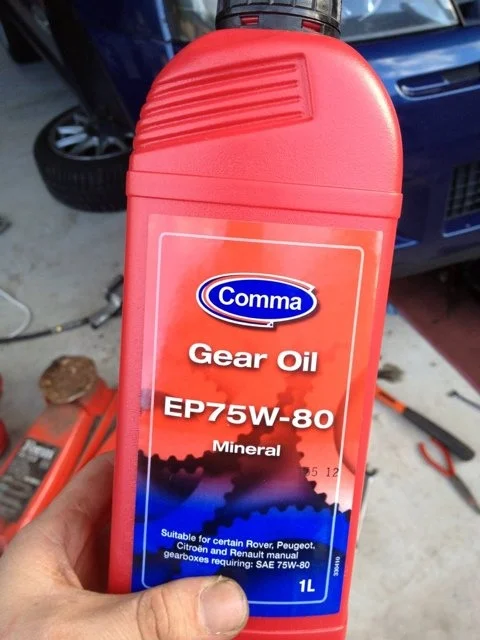

Looking good. What comma box oil did you go for 75w80 mineral or the 75w90 synth?
I went for 75w80 mineral. I couldn't find and 75w80 synth locally so this will do for now.
I'm considering ordering up some tranself 75w80 NFJ and replacing it for peace of mind, I'm not sure if the comma mineral stuff is any good for the box.

When you change your gearbox oil do you drain the old stuff out, or did you just top it up.

I was changing both driveshafts so you loose the gearbox oil when taking out the n/s one.
I drained it first to save the mess then refilled it after i was done with 3l of oil using a funnel attached to a handy piece of brake pipe I found in the shed, perfect length with a nice bend on the end.
