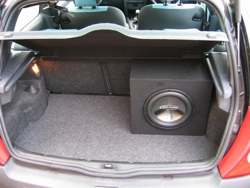

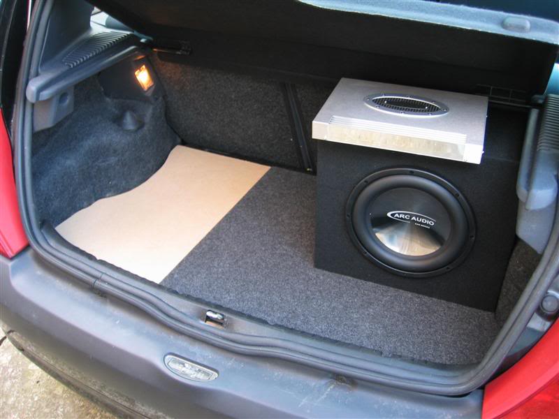

I had a false floor in mine, the amp went under the un carpeted panel, the floor could be removed for access to the spare wheel and I used the bold holding the rear light in as an earth.
  Fiat Bravo Active TJet
I've been thinking about this a lot over the past couple of days, as to how I'm going to lay out the boot to maximise space with what I need as well as provide me plenty of boot space to play with should I need it.
  renault clio 1.4 si 2000
hi mate, i'd say to u to for the alpine route, my whole set up is alpine and amped, a 4 channel for the components and 6x9's (hush u!) and a monoblock with a 10" sub. after playing with this set-up and working with friends car's i'd say amp everything, it's the only way for an even, balanced sound and full control. mine looks like this..
since then i've got a stealth shelf, some chavs tried to crowbar out my rear window for the 6x9's and put horrible marks in the boot!!! :dapprove:
