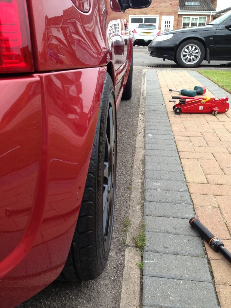

Just fitted a set of 20 and 25mm spacers to my 172 which has cup turini's fitted.
Front went from this

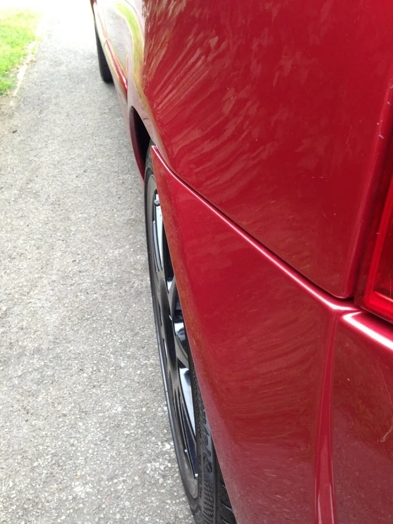

To this

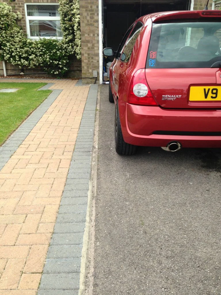

The rears went from this

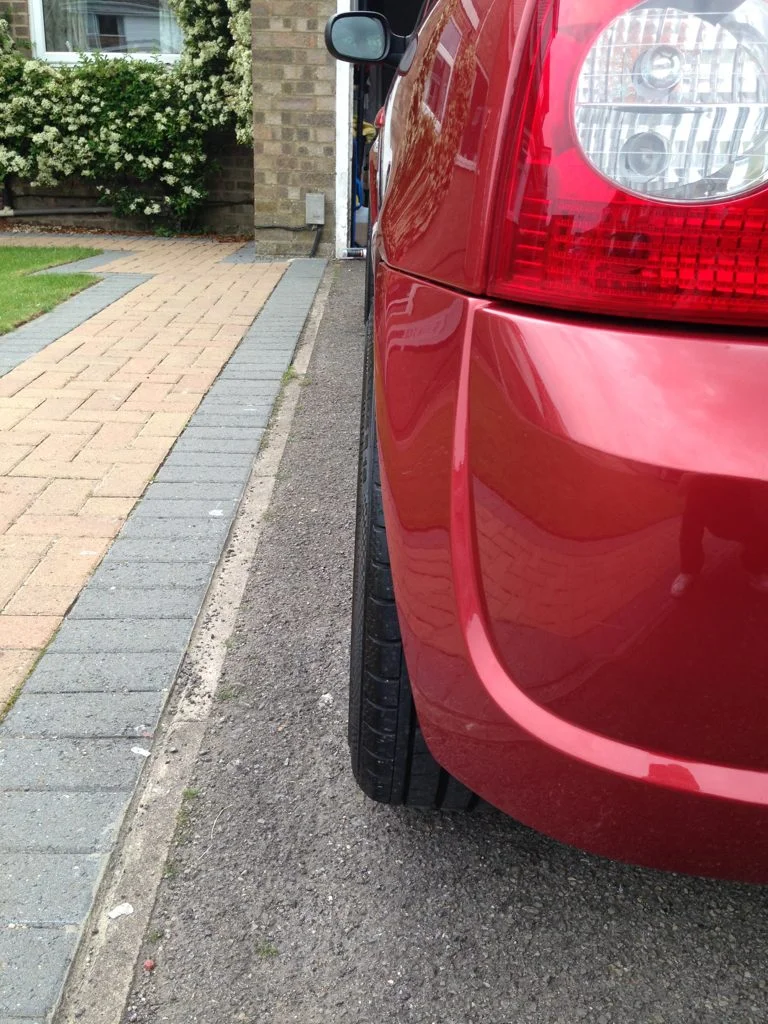

To this

Do the rears look too far out?
  PH2 Flamer
I will grab one in a mo. I've only fitted one side at the moment. So I can compare.
Checked the front, no scrubbing, rears have lots of room.
I think either front needs more poke, or rears need less. Will get them all on, and take a pic
  E46 M3 & UR Quattro
The front looks spot on but I think the rear is slightly too much but I bet it will be brilliant from the rear.

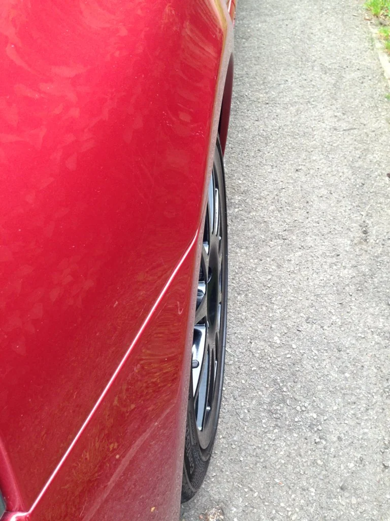

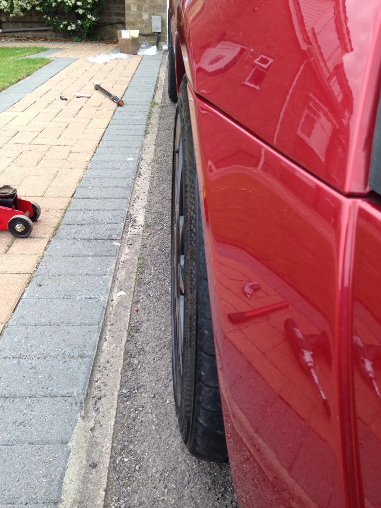

Well this is it
Took it for a quick drive, nsr is scrubbing!
Oh well back to dan for some 15mm. Got 10mm more at the fronts lol.
See if he will take these back, and get the 15 in exchange. If not I will just sell them.
