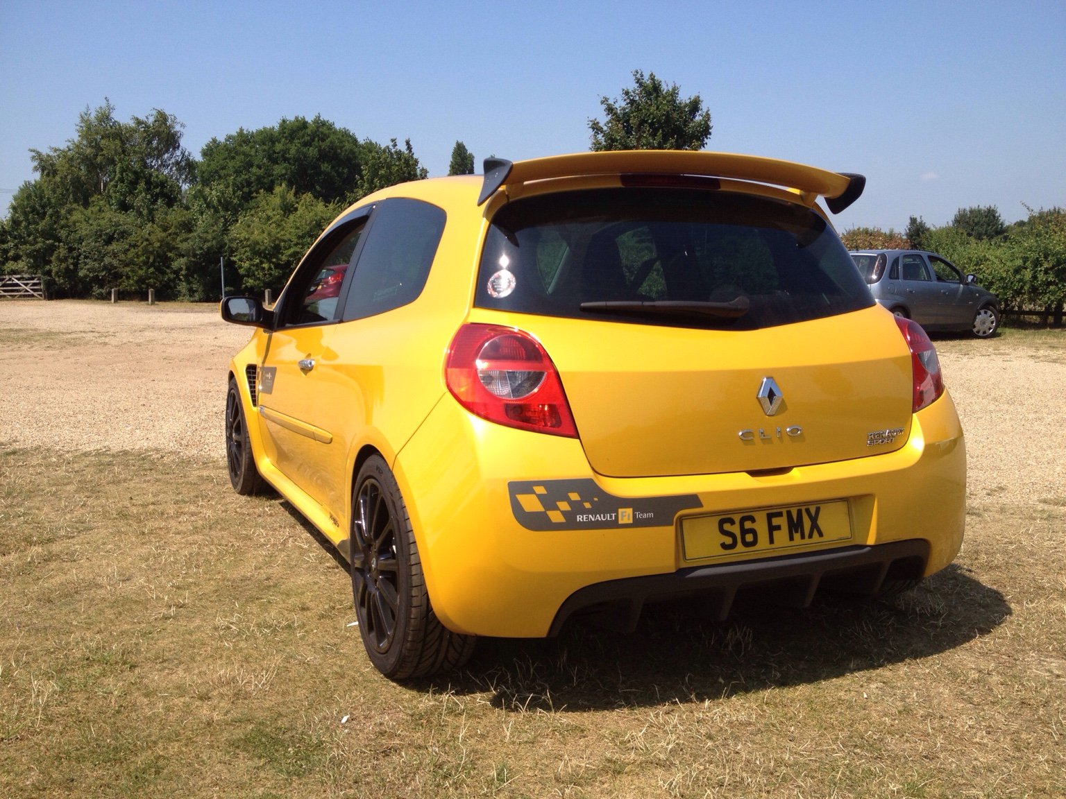

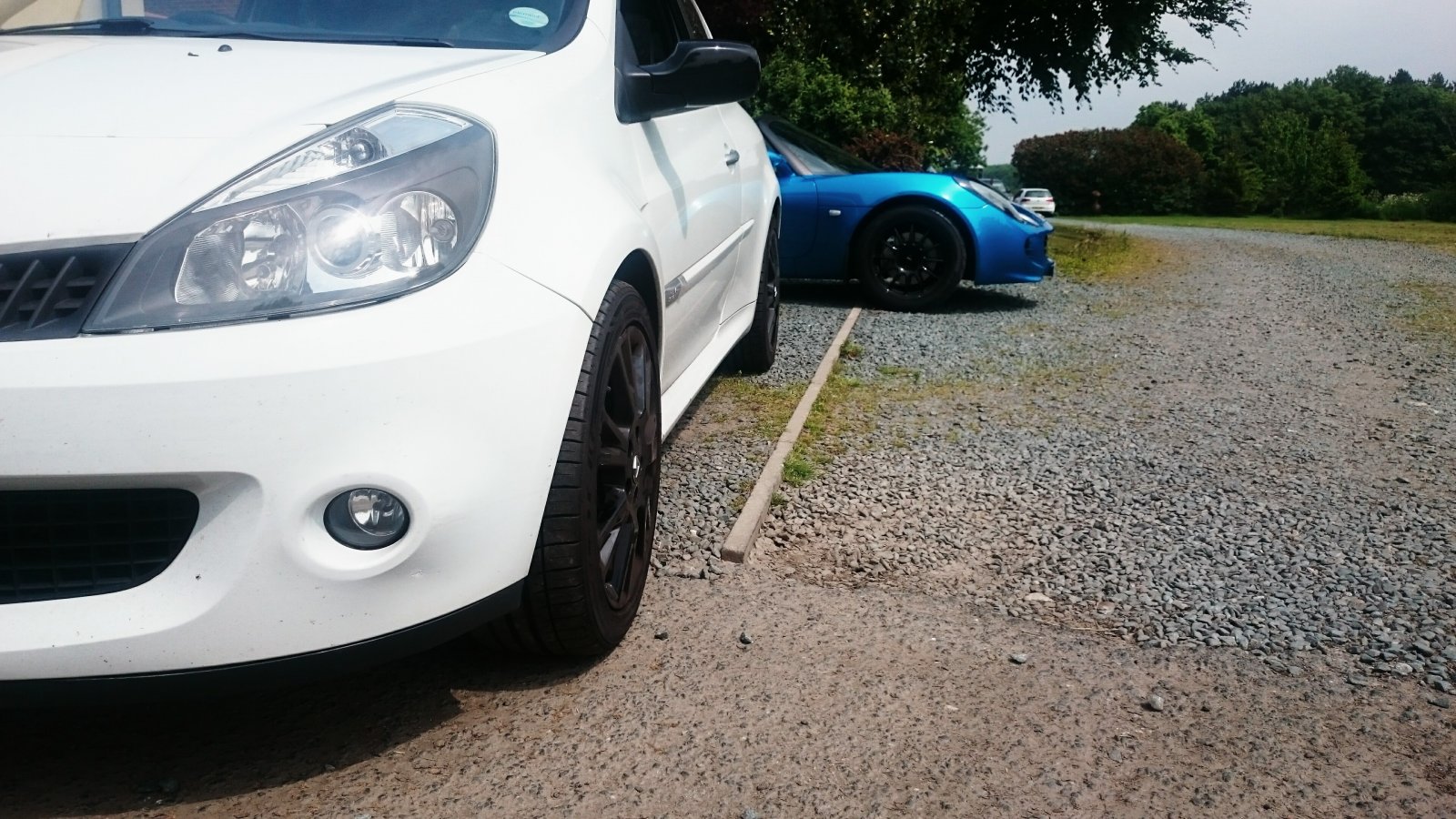

Here's mine
It sorely needs spacers

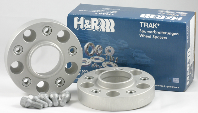

If you don't get them though, get bolt to hub, hub centric spacers (you'll need more than 20mm for these)
This means the spacer locates on your current hub centre spigot, gets bolted in place and has its own spigot for your wheel to be mounted to. You then bolt your wheel to the spacer.
Since you bolt your wheel to the spacer, the spacer must have steel inserts in it to screw the bolts to.
If it doesn't have steel inserts, you'll shear the thread eventually as the aluminium isn't up to repeated screwing.

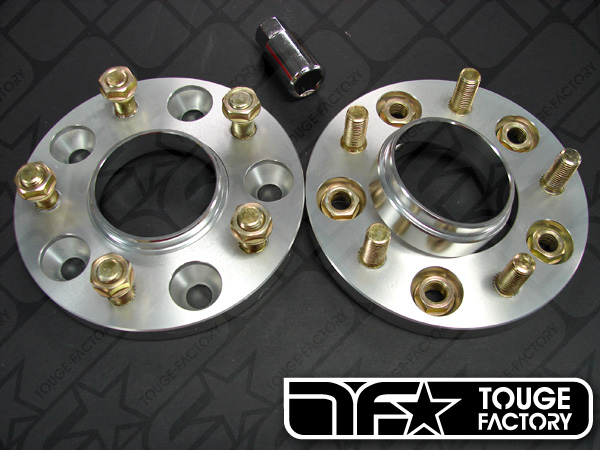

Like this
Not this. Note the studs are bolted directly to the aluminium (it looks it at least)
Cheers Knuckles mate, am I right in saying yours in the picture doesn't have spacers (hence you saying 'it sorely needs spacers') - if so, that's exactly what I was looking to see, lowered and without spacers.
I understand what you mean about bolt-to-hub, hub-centric, and can understand the advantages. I've shopped around and I've linked the KTEC variants as they include the bolts too, and I can also add the locking wheel bolts (which are a must for me too). I'm guessing the H&Rs they are just the spacers alone and I'll need to source the bolts separately - trying not to overspend on these as although they are 'quality items which improve stance and width of car', don't want to be splashing out too much wonga for 4cm of girth (KTEC spacers x 2 plus locking wheel bolts would be around £160 combined already).

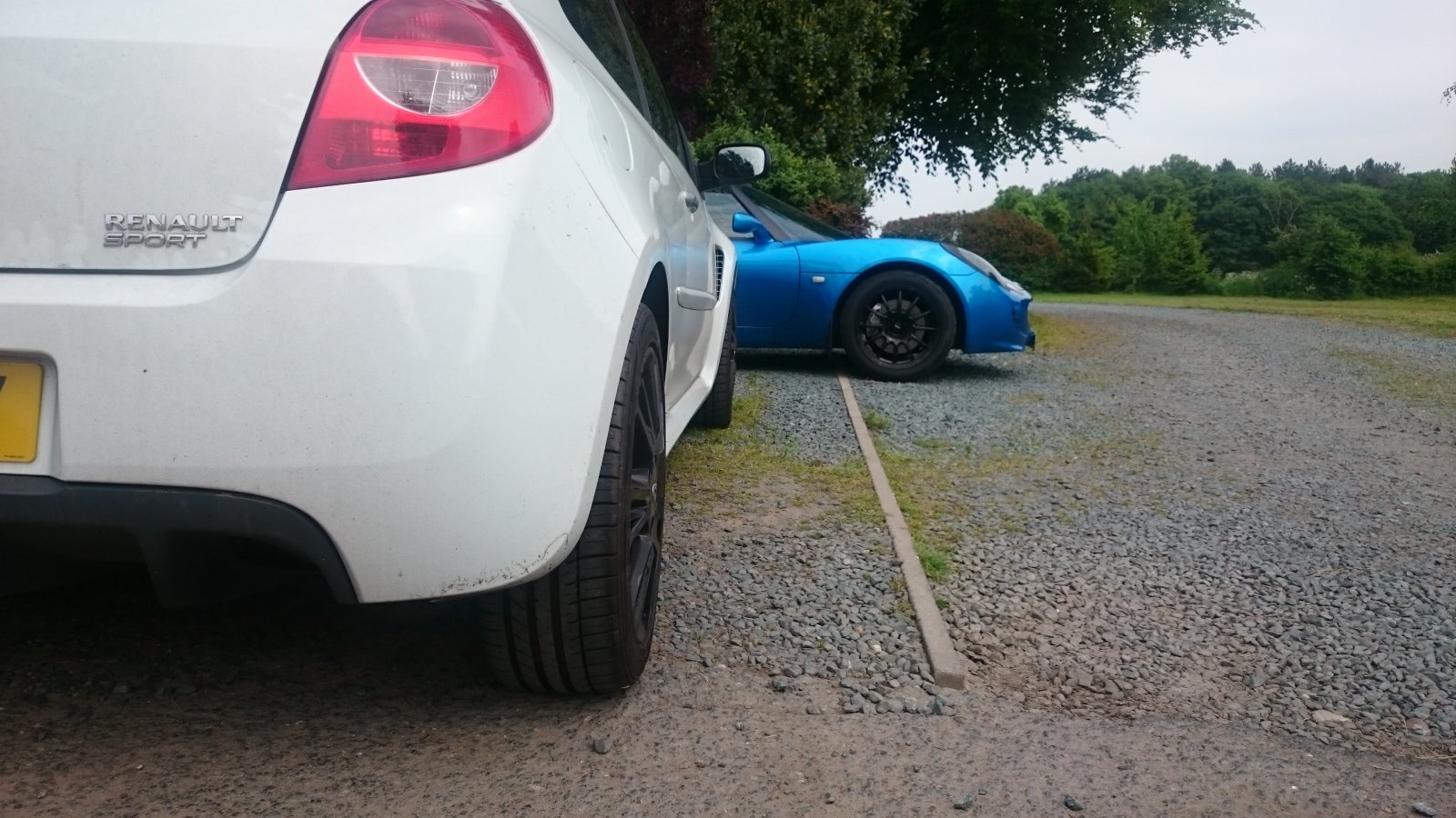

Yeah mine is just lowered without spacers.

I think the h&rs spacers come with additional bolts to secure the spacers to the hub. I could be wrong though. So that way you could still save your current bolts. But the h&rs are the pricier option.

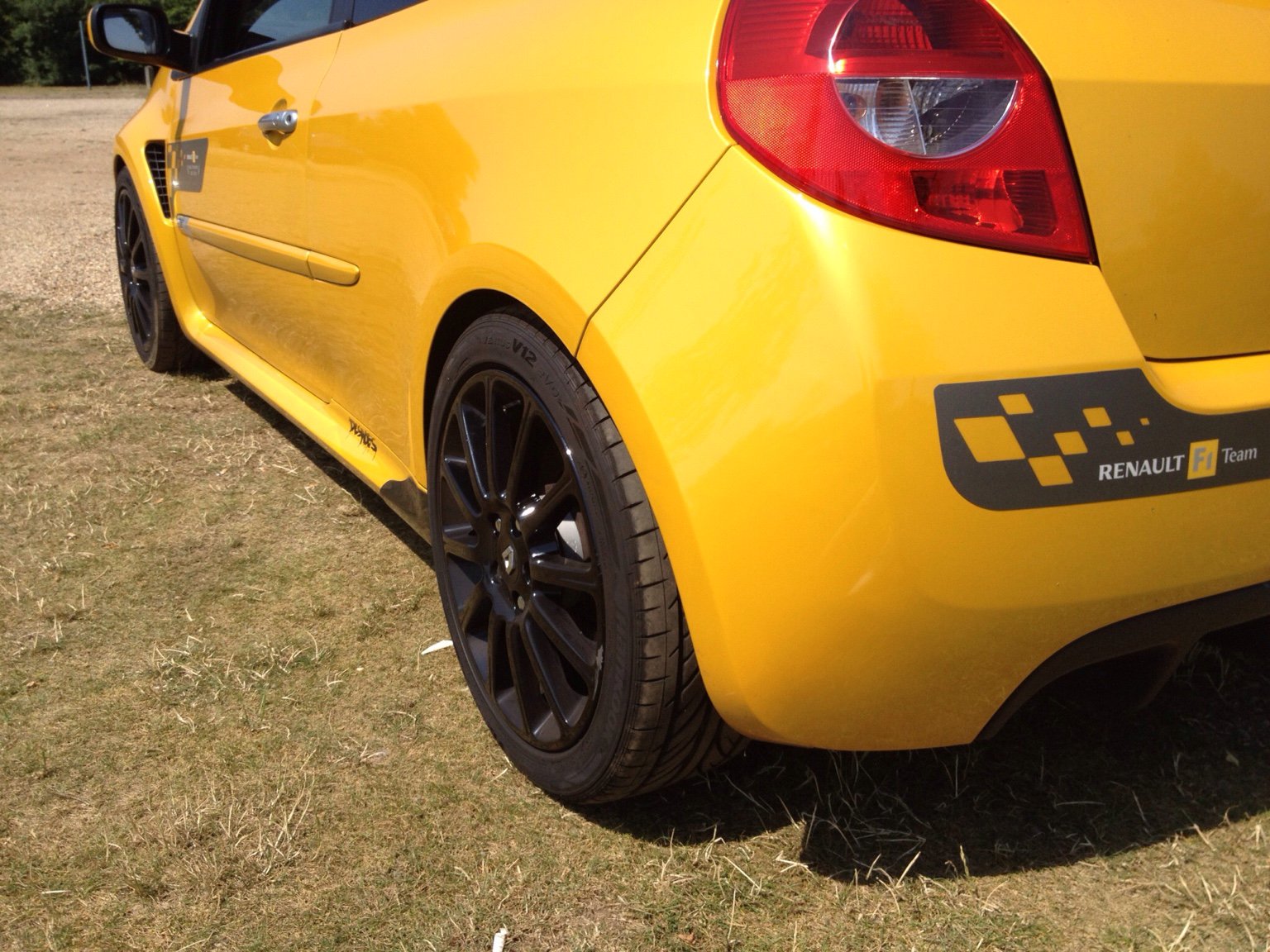

This pic better shows the tuck on low suspension and no spacers.

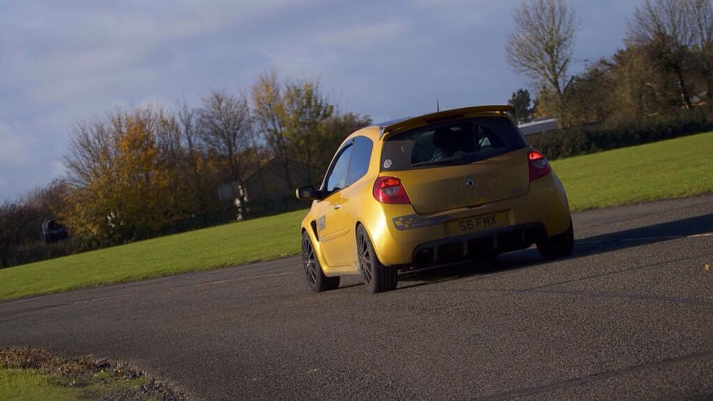

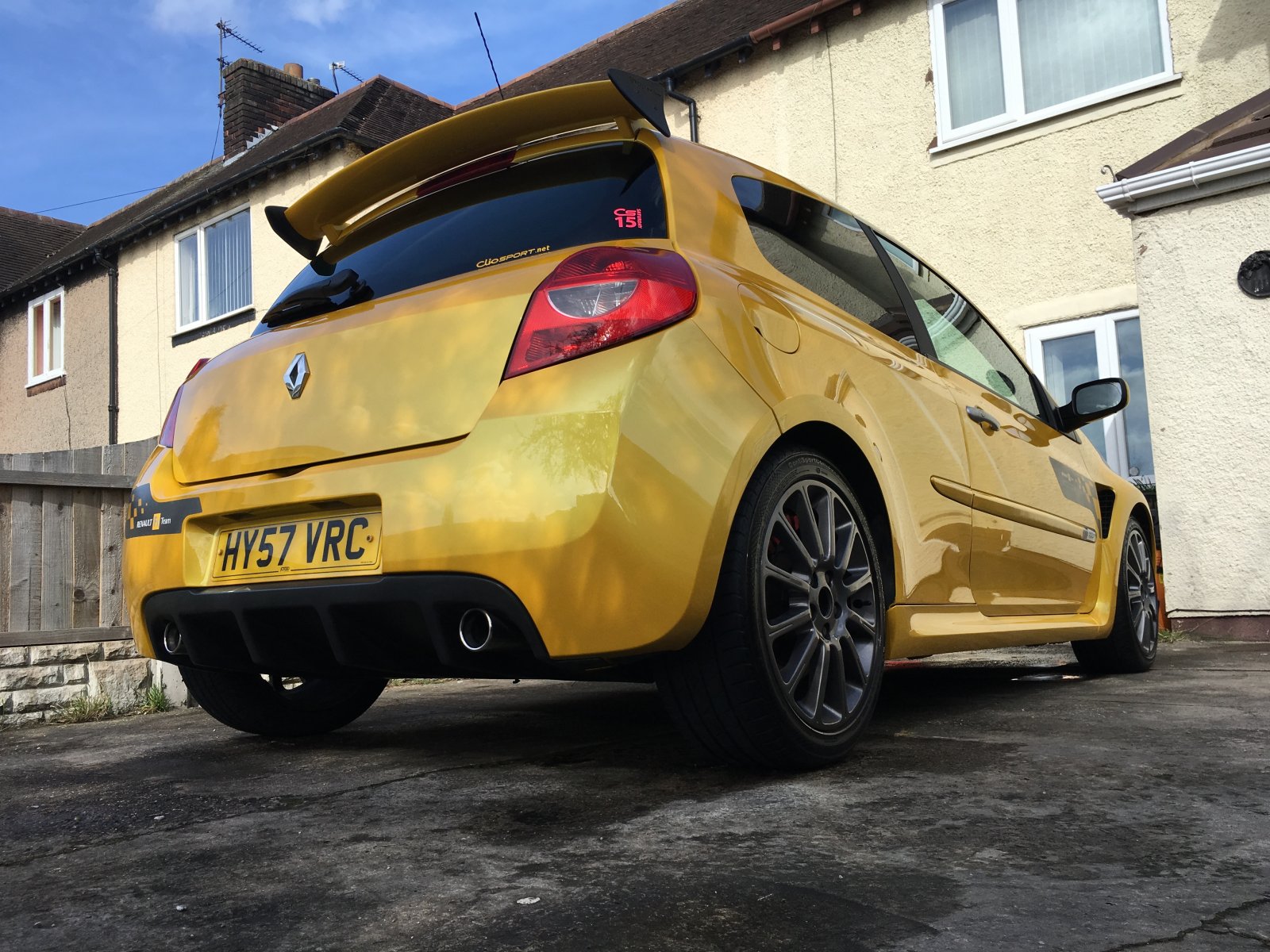

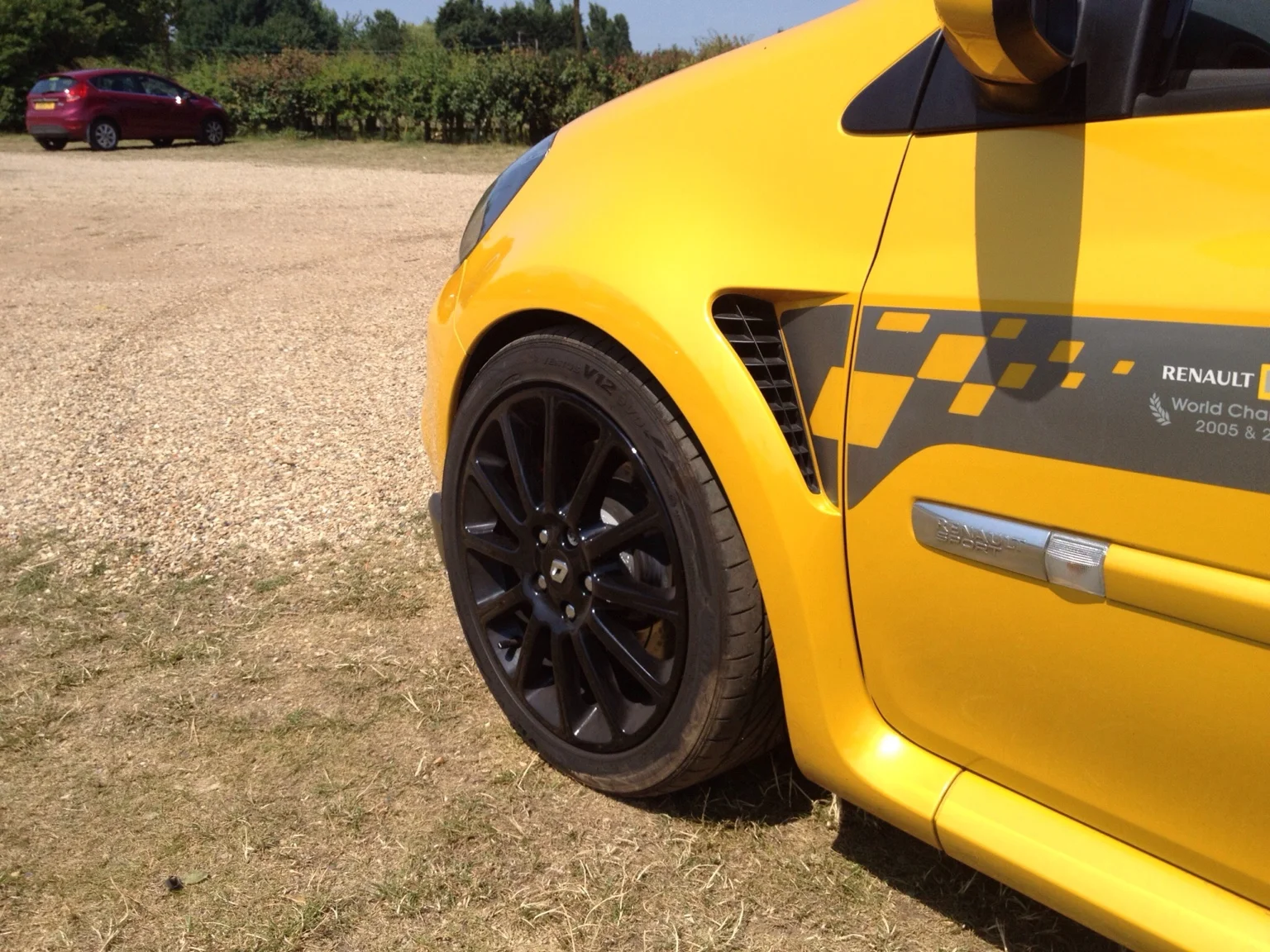

I have 25mm H&R hub centric spacers on mine.
The only downside is that it sprays stones and shite up the side of your car. My wing mirror on one side looks like it has been shot with a shotgun lol.
They look best when lowered tho.

Cheers for the pics @PacMan, car looks great, read before about the stone chip issues too, why can't we have these nice things without any downsides?! You get the chips sorted or you just living with them?
Not a problem mate, I'm yet to try the ones you've bought so can't comment personally! Fingers crossed you don't have any issues, there is one thing though it doesn't half improve the look of the 200's :up:

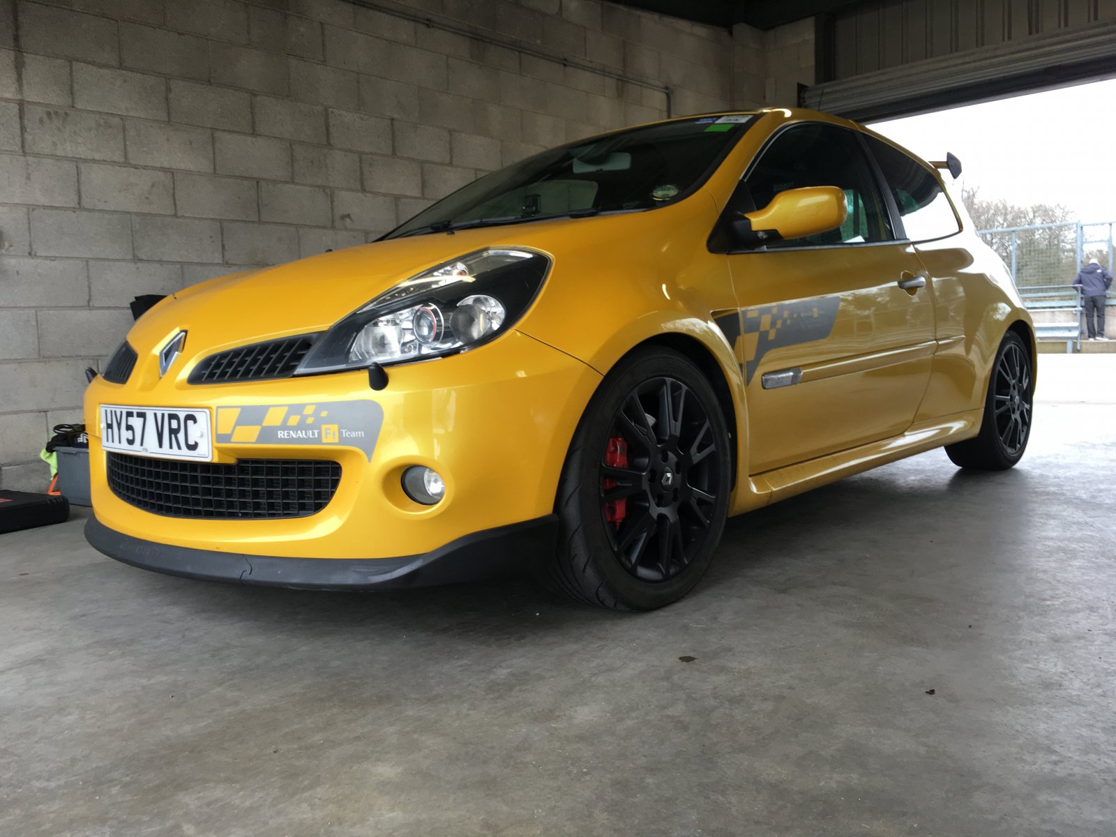

I have had my spacers on for over 3 years now and been on a fair few track days with them. I have never had a problem with them touch wood!

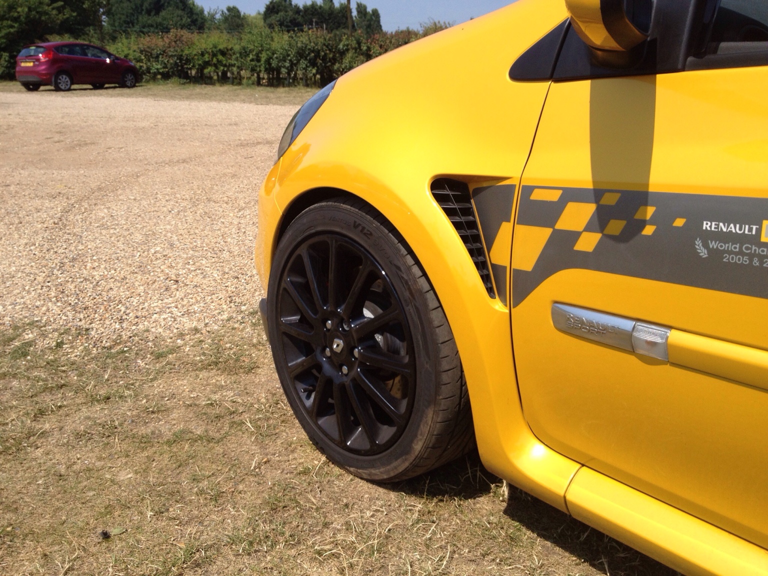

Cheers again for the help chaps, stuck the K-TEC spacers on over the weekend with extended bolts and they are perfect, no issues at all, front wheels look so good with the 19mm poke, very pleased! Crap pictures but I'll get some betters ones soon.
