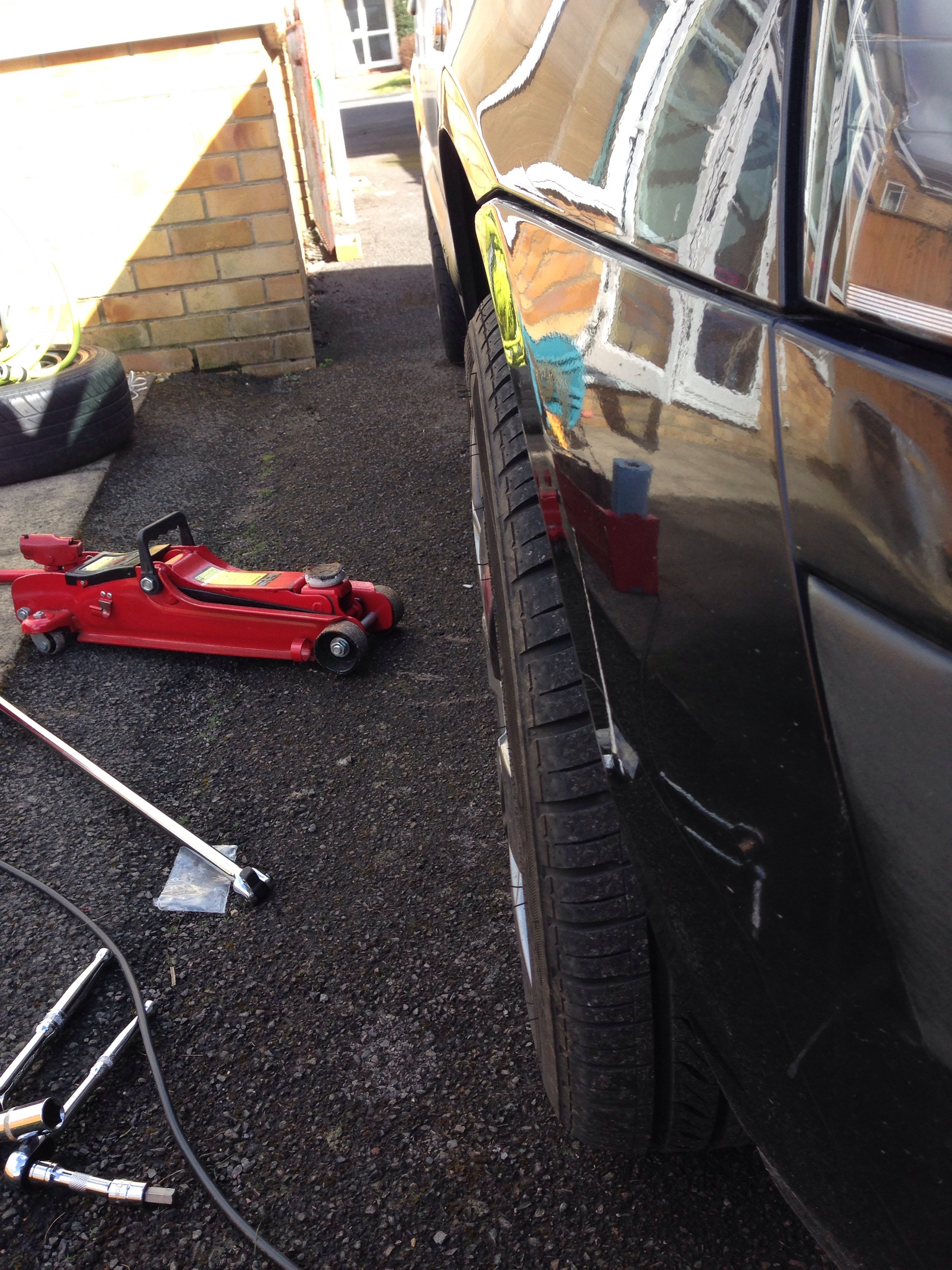

^^^ 30mm on the front is the maximum. After that it's impossible to stop the rubber contacting the rear arch fixing while in a tight bend. Even with these had to roll back the arch liners to the metal
